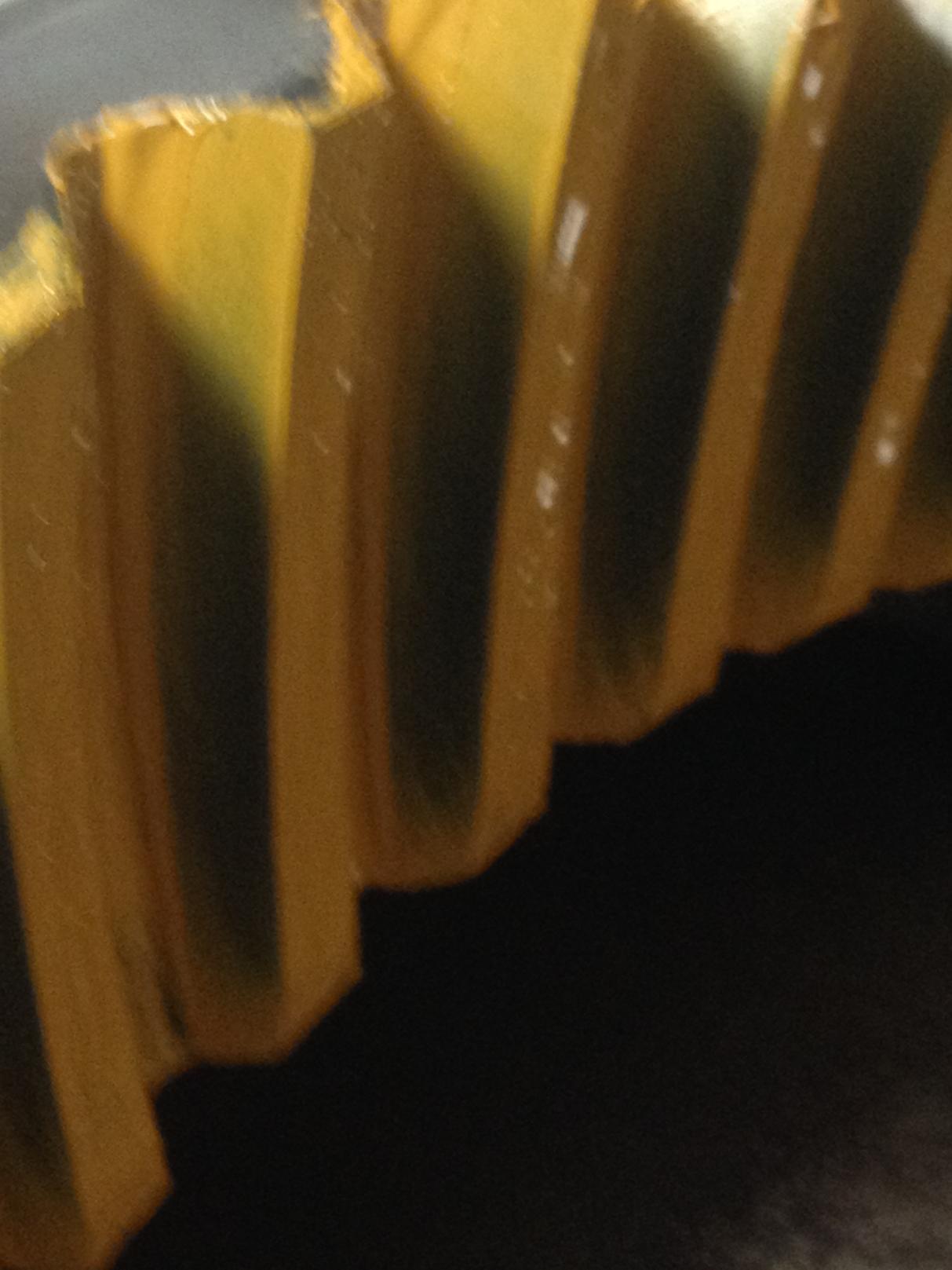

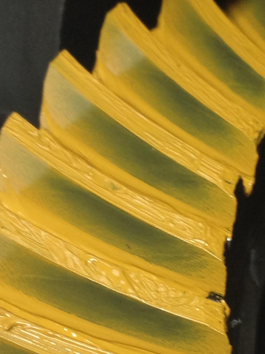

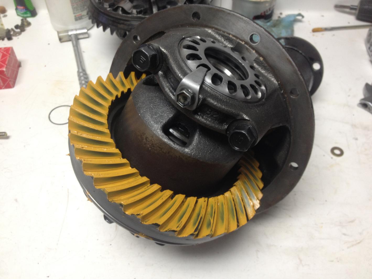

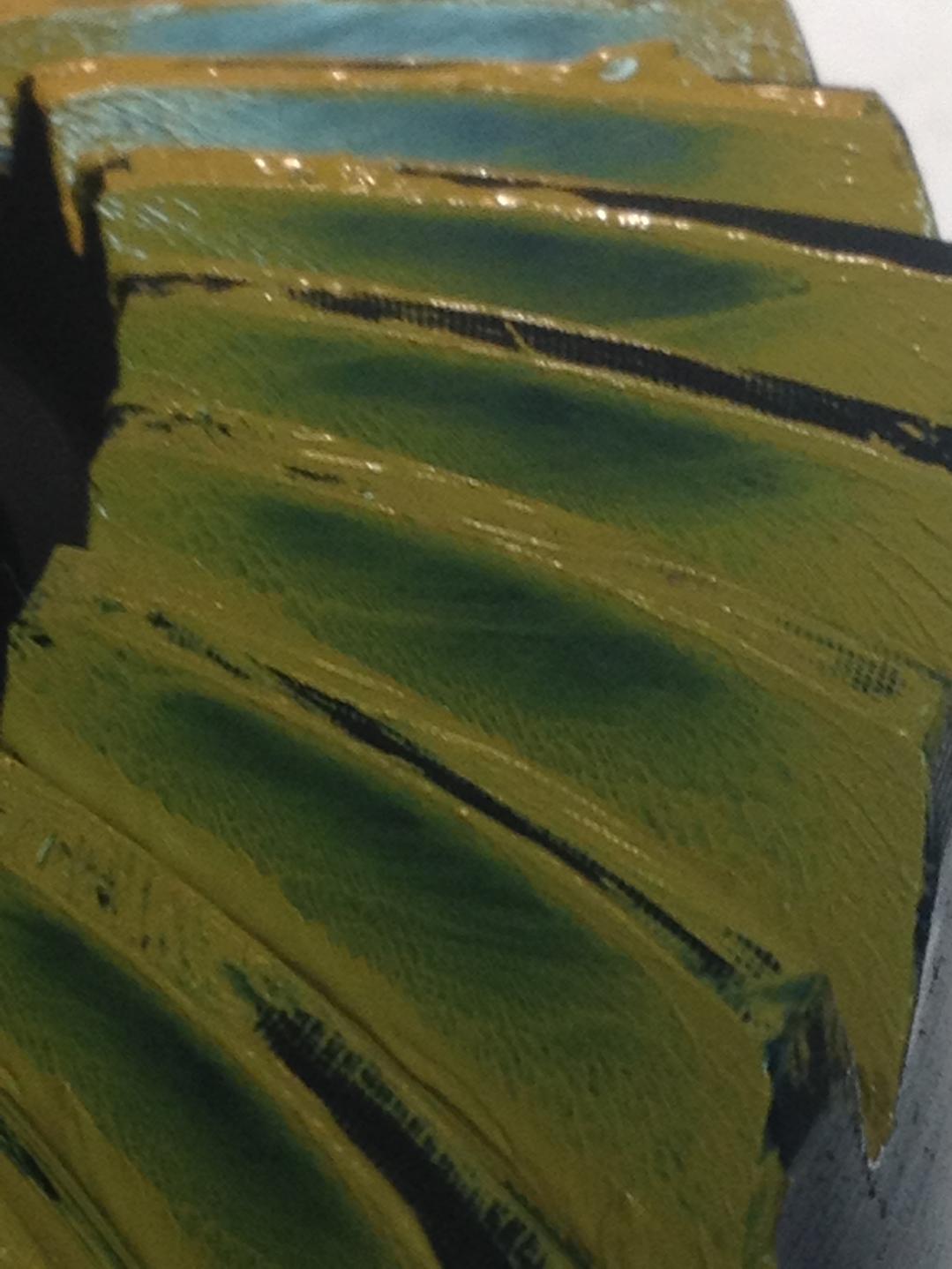

R & P setup
Any experts out there that would review and advise on the coast and drive patterns. Thanks

As long as the backlash and pinion load was set correct you should be cool.
Did you end up using a crush sleeve or solid sleeve?

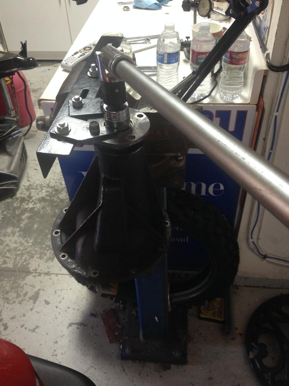

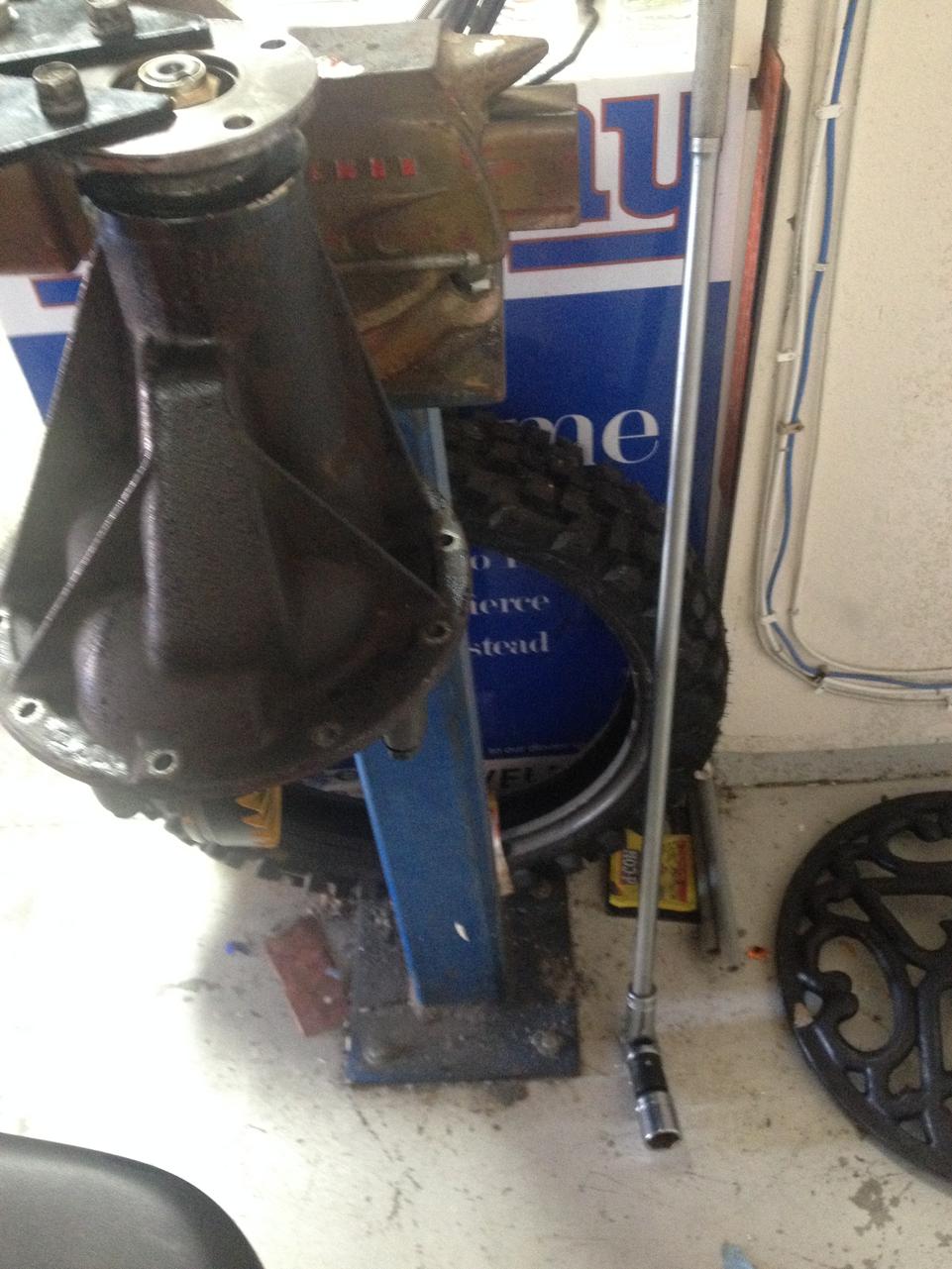

Thanks for the feedback on the setup. I was hoping to have it back together until I checked out the axle bearings. Time to make a bearing R & R tool.

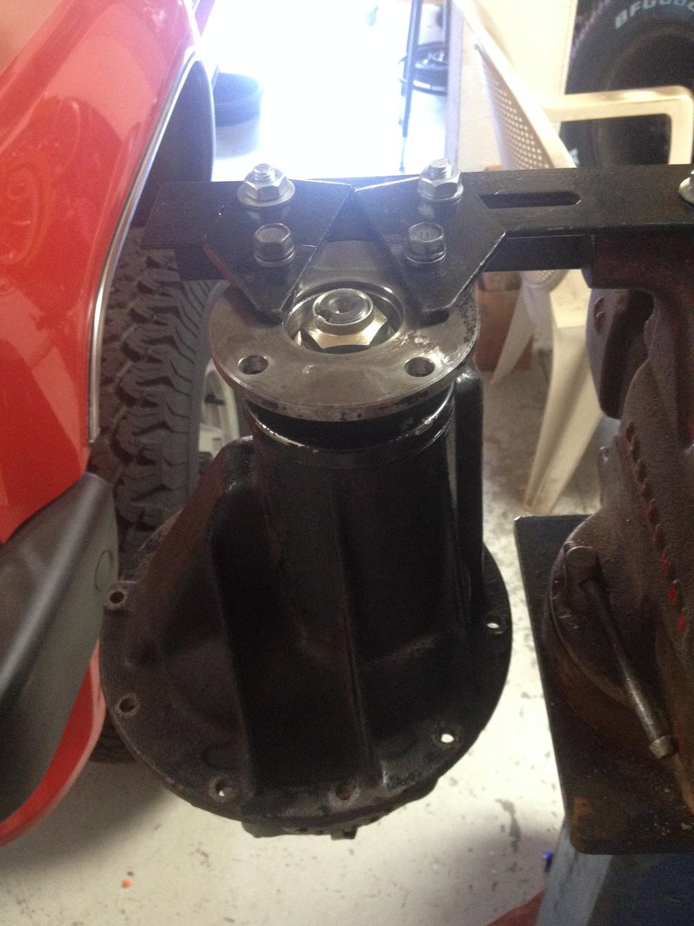

crush sleeve
It takes a good size breaker bar to crush the sleeve to the correct preload.
