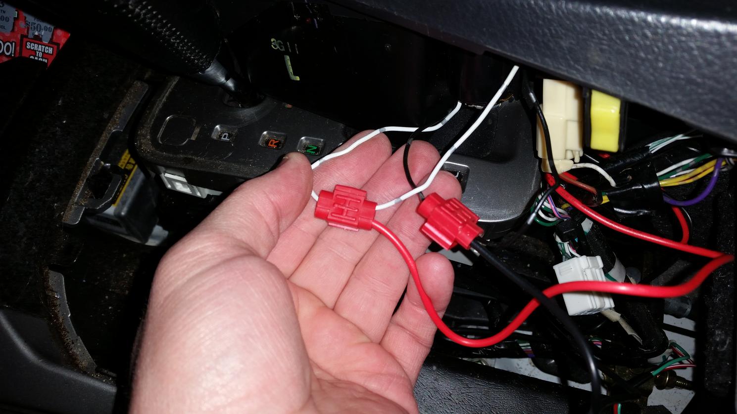

Check out the pic. I'm putting in a USB outlet. I attached it to the cig lighter in the center consol.....but no power. Any suggestions?
PS: I checked the fuse

Looks good!!!
Sometimes them type of connectors don't always make contact, got to check them for current afterwards.
Looks good!!!

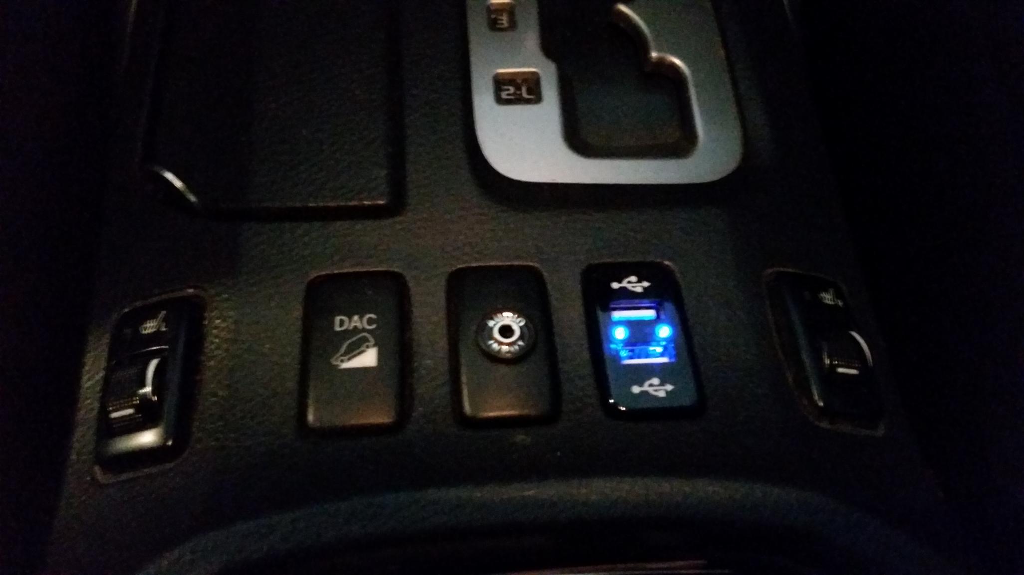

Thank you, yeah I don't usually use these but they came with the "kit". Just had to clamp them down a little more. It being 20 degrees outside doesn't help haha
