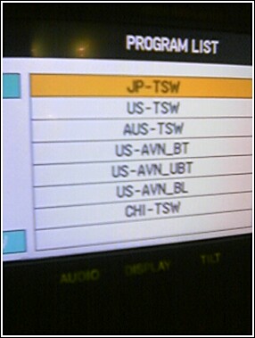

There is a 2nd NAV setup screen:
hold down the INFO button and --->
turn your park-lights on/off 3-5 times...
you have to do it everytime you turn on the 4runner, but you can do it while driving, only takes 5 seconds.

If I may add some extra detail to LukeSKY's description.
1. Get to the volume screen
2. Press the speaker icon in the top left of the screen.
3. Then press the bottom left corner of the screen
4. Press the speaker icon for the second time
5. Press the bottom left corner for the second time and the service screen should appear.
6. Now press the "Override" button until it beeps and highlights.
7. That's it, you may now use ALL Dest buttons while the vehicle is moving!
I just did it to my 2003 4Runner with the 2005 Camry Nav unit installed. Wow! Thanks LukeSKY. Great Hack!
