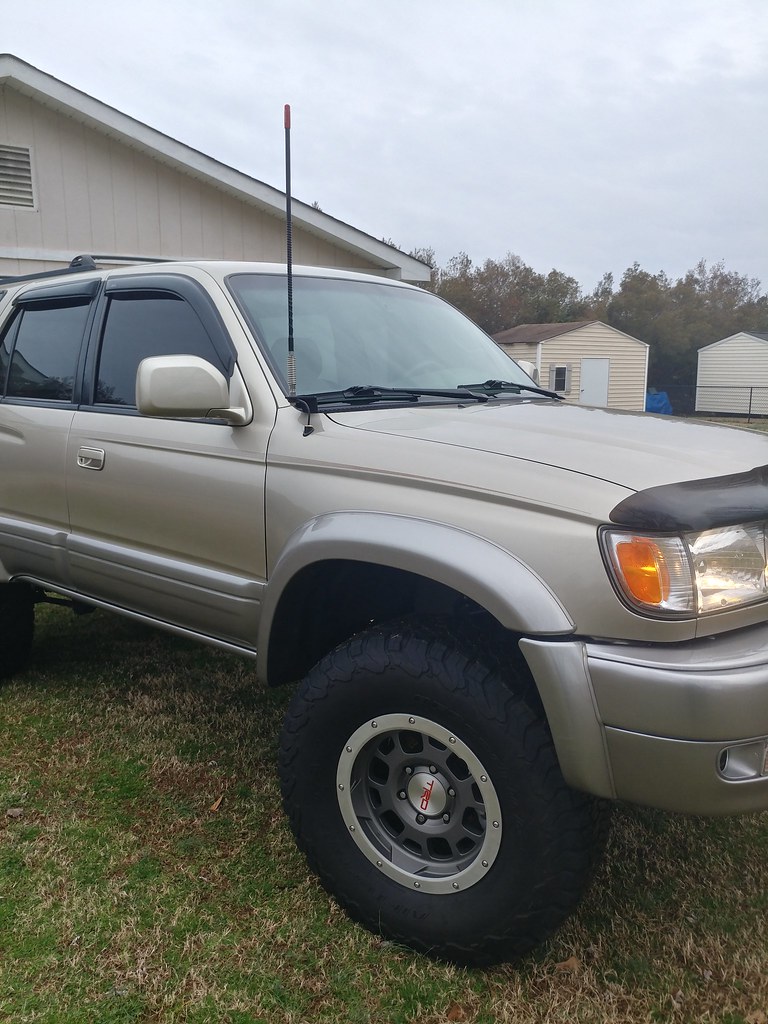

I just got done replacing my stock antenna with a CB antenna yesterday using the CBI antenna mount. Besides the regular CB items (whip, coax, mount), you'll need a splitter to take the cb coax and allow you to plug up to both your radio and cb.
This is the one that I bought:
https://www.amazon.com/FireStik-AR-...=cm_cr_arp_d_product_top?ie=UTF8&tag=pda0e-21
And picture of the whip mounted in the factory location. The coax is run along the same path as the factory antenna, then routed under the shifters and cup holders to the splitter box, then the antenna out coax from the box is run to the radio. Seems to work well so far, and got rid of the antenna motor, and stripped antenna.
