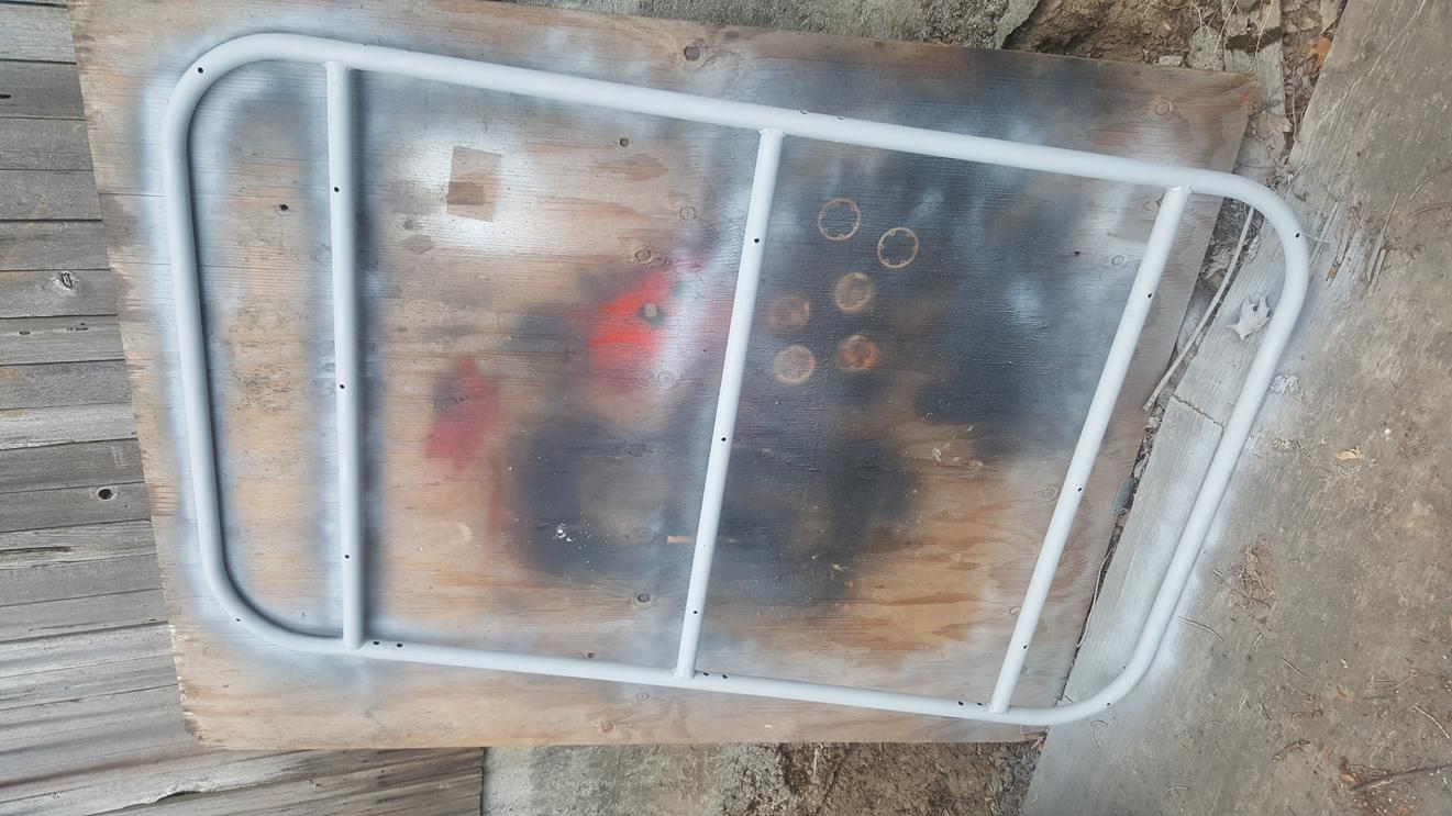

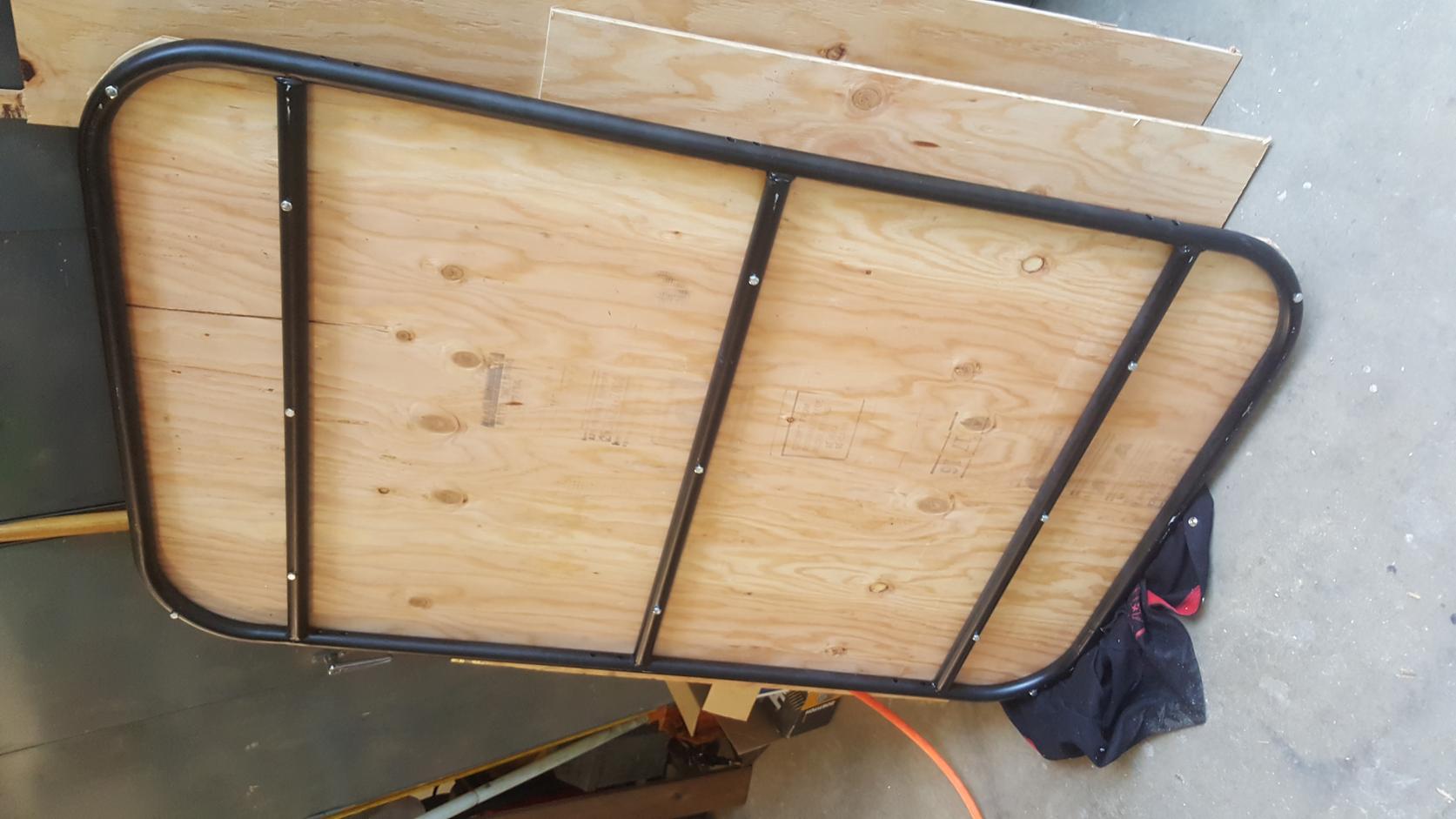

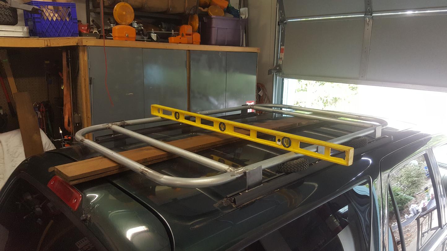

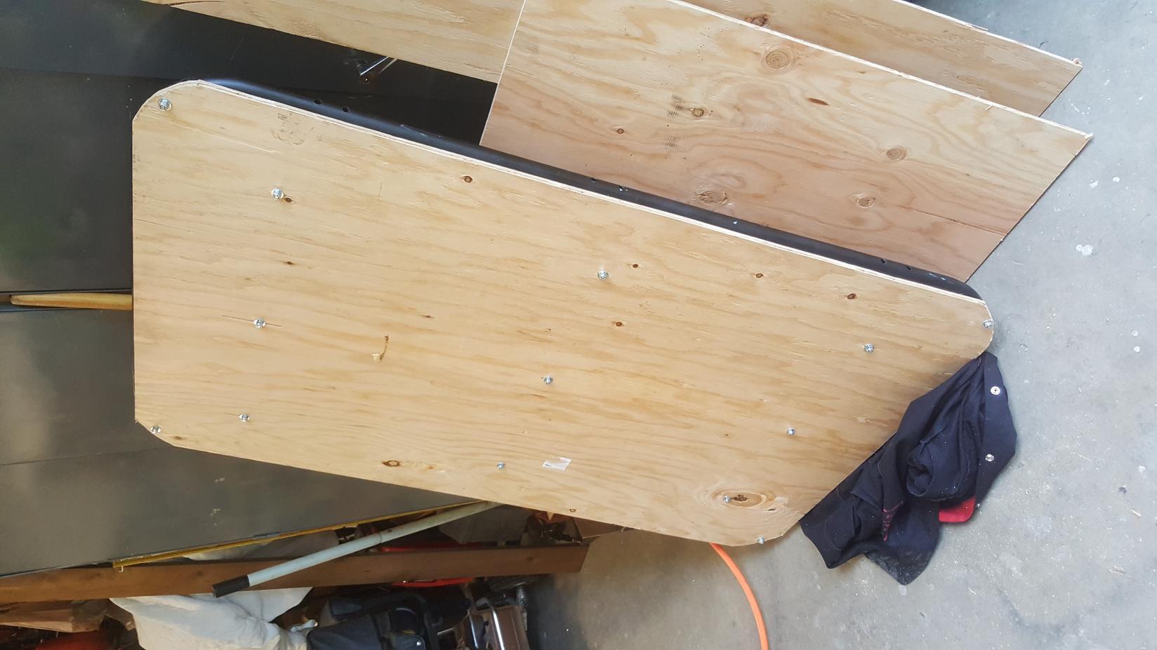

That was mine! I had some extra conduit after a house project and needed a roof rack for an event I was attending. I ground the galvanizing off before welding, and still wore a proper respirator. I painted the whole thing black and bolted a piece of plywood to the top. It was quite strong, I could stand on it easily. I was going to remake it out of regular DOM 1" tube...

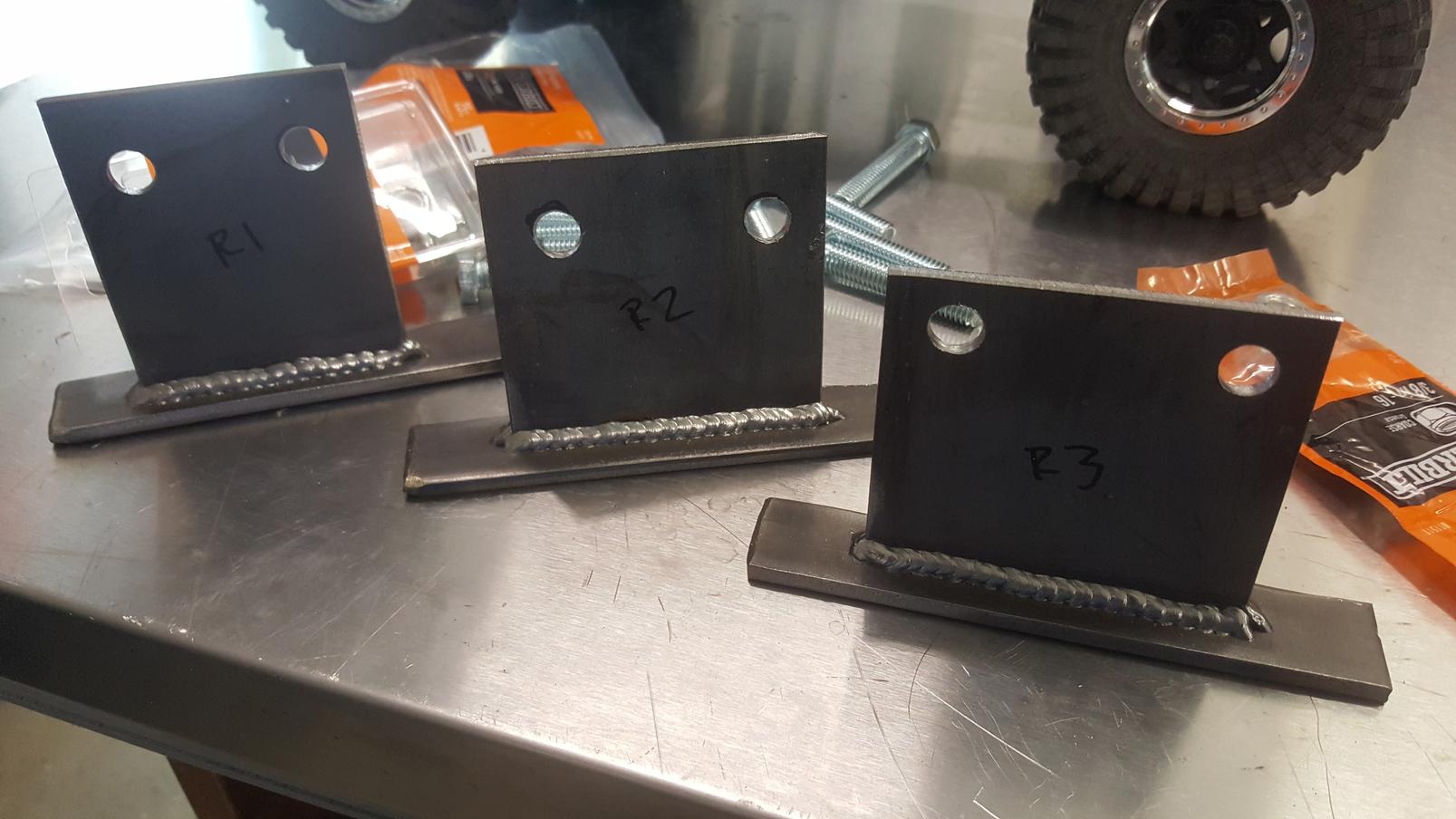

how did you attach the inserts the rack rail? was it bolted or just slide into place? [MENTION=123612]rbgerrish[/MENTION]
I just slid them into place. The tension from securing all the mounts to the rack flexed it a bit to keep it from going anywhere, and the front and rear stops were on. (barring a 45mph head on collision!) ;)
There was room to drill holes to bolt them down.
