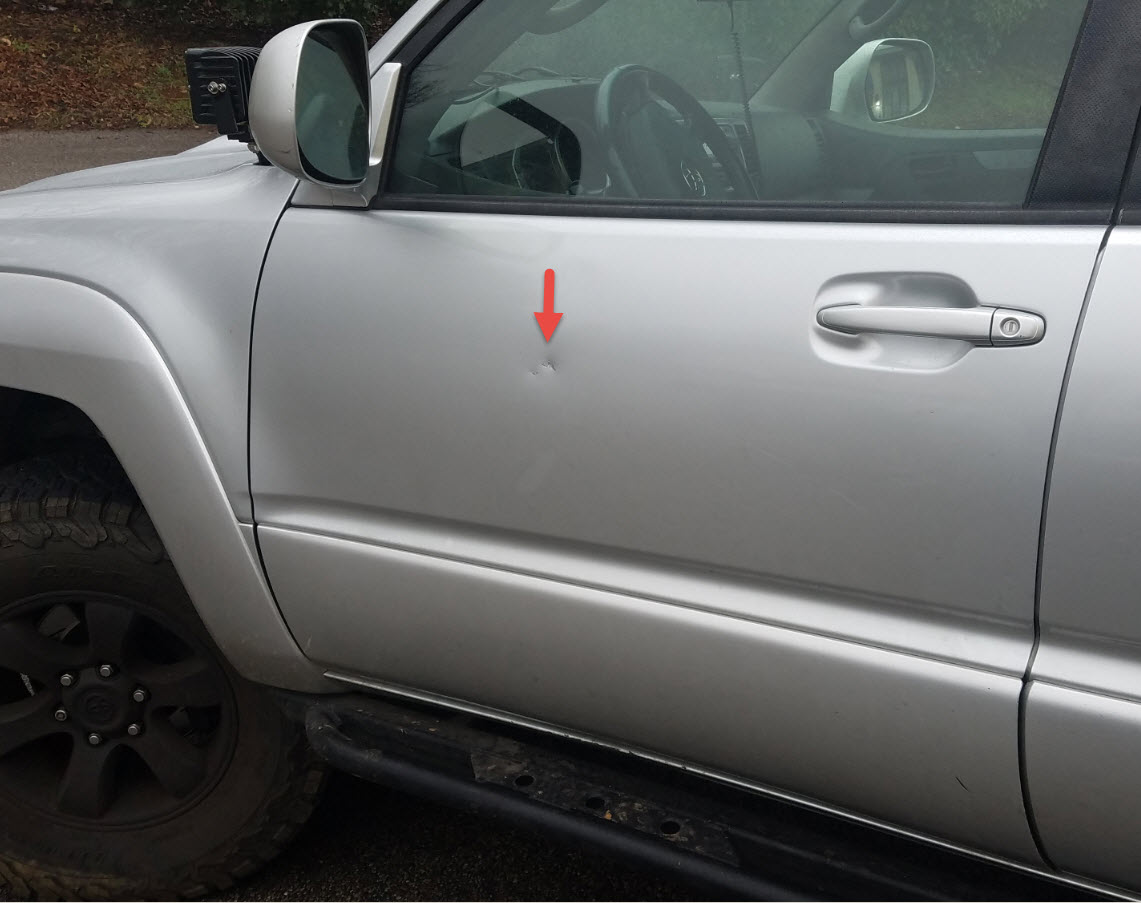

Yeah, ditto... high lift jacks were made for farmers to pull up fence posts and stumps. Somehow they got re-branded as an off road cant live without tool.
Any other use like lifting up your car to remove a wheel is playing with death.
Or better yet putting dents in your doors.
Oh dude, that SUCKS. I think I have a dent in my shin from a hi lift from back in the late '80s, LOL!!!!
