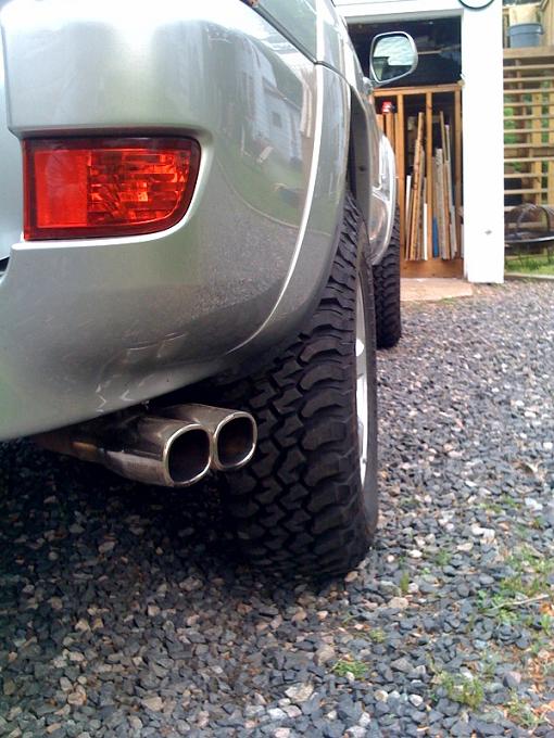

I also have an '05 and i just put spidertrax spacers on and i feel that it looks great, im not running the usual 265/70/17 setup, but a slightly taller/narrower 255/75/17 (32.1 x 10) and it pushed the tires out flush with the fenders and looks great(IMHO, of course).
Heres a Pic:
Heres a Pic:
Looks nice :bigok:

Looks good, but it looks like they are a bit beyond the fenders. Not much, but a little for sure. I remember back in high school, some of the guys with 4x4s had to put add-on fender flares because the cops would give them tickets if the tires extended beyond the fenders. Yours isn't nearly that bad, but it does look like the tires stick out a bit.
I dont really think that is an issue anymore, many trucks come from the factory these days with tires that stick out past the wheel well. the one that i notice the most on the road is the new hummer h3, those tires stick out about three inches past the wheel well.
