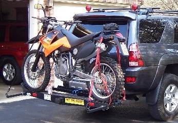

I don't have room for one but it sure would be nice to take the dirt bike and the streetbike on a trip. Here is my solution. Versahauler.
