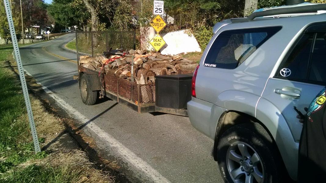

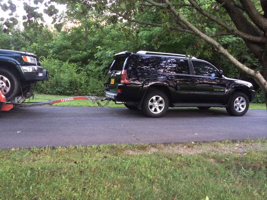

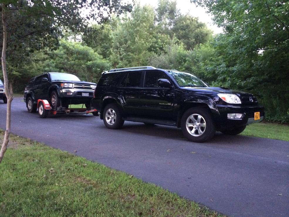

I know the V6 can haul a 3rd gen for 4 hours without any issues.

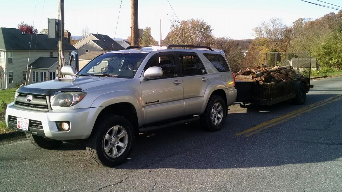

Im not sure how heavy it was but this past weekend I towed this about 45 mins up the mountain. I usually used my 3/4 ton chevy for these kind of tows but was very surprised how great my 4R handled. next time I will actually upp the weight a little.
