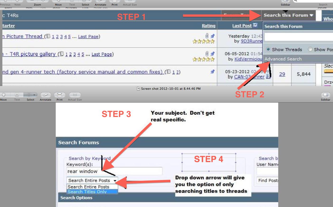

You don't have to necessarily change the engine. You might need to depending on it's over all condition, but you will need to do some investigating. First look into whether or not it falls into the 4Runner Special Service Campaign. A little Google or search on this forum will get you some info on that. It was for a known head gasket issue. Call the dealer and give them the VIN and they can tell you if it qualifies. You may end up just having to clean it up a little and get it to the dealer to get the head gasket replaced. Any other work that needs to be done at the same time will be on your dime.
As far as engine changes goes, it depends on what you want to do. A 3.0 to 3.4 is a common conversion and there is more info on the net than you can shake a stick at. A little searching with Google and on here will give you so many links with everything from wiring theories to actual remove install threads that you will think you already did it.
You could also just swap in another 3.0 if you wanted. Not too hard to do. You will get a lot of grief from the 3.0 haters if you do, but it is an option. Look in the stickies at the top of the classic page for a link to the FSM and start there with some reading on the remove/install procedures.
