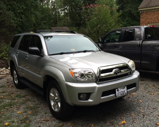

Interior and exterior are MINT. Has a third row too which I think might be useful with more kiddos camping in a few years.
I plan to swap my roof rack from the 04 and eventually add a OME lift with 285s. I got 19mpg all the way home at 75mph. The 4.7 engine feels very smooth and refined.

i see that you indeed got it. but you will notice a significant difference. especially once you go larger tires and add some weight.
