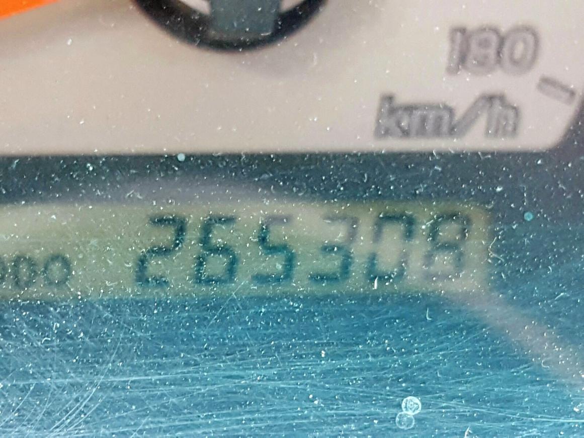

The timing chain is designed to last the entire life of the vehicle on 4th gen V6 models.
I can confirm this is true as I recently sold my 2004 v6 Sport Edition with 265,308 miles and neither the timing chain or water pump had needed replaced.
The V8 versions are a different story, they have a belt instead of a chain and it needs replaced every 90,000 miles.

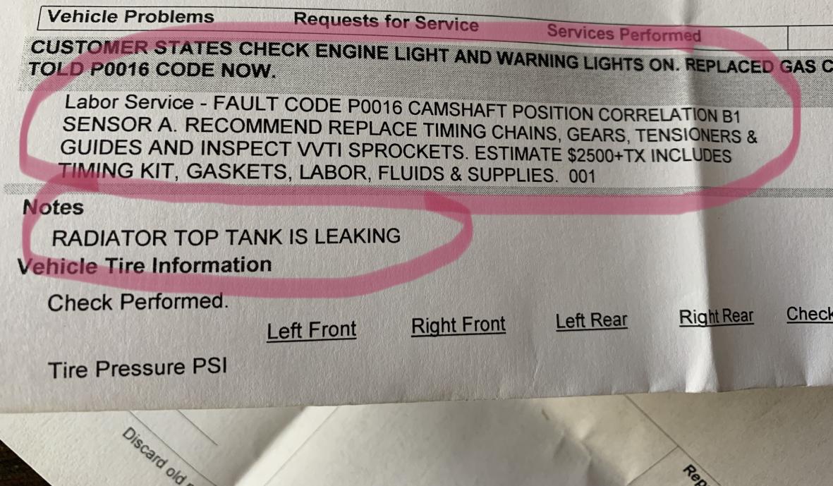

2008 Toyota 4Runner V6 - 92,560 miles on it
Check Engine light on, VSC OFF flashing, Traction Control on.
Took it in today and the guy says my timing chain is stretching. Says it’s too risky to be driving much. Could’ve swore these things lasted longer than the mileage I’m at....anyone have experience with this? The guy quoted me at $2500 - which is super high, I know. Gonna call around tomorrow and see what others say

My timing chain stretched at 120k miles, despite all regular maintenance. P0016 was the code iirc. In fact many it's becoming increasingly common for later model 4th gens.
$4500 was my best quote to get it fixed, so I did it myself for about $500 in parts. Took me a month of weekends, it's not an easy job.
The code strictly read:
P0016
Crankshaft Position - Camshaft Position Correlation Bank 1 Sensor A
I’m supposed to take it to this good friend whose a Toyota mechanic, he’s in Lake Forest (13 miles from my house). I was told I should be hesitant even driving it... The car drives totally fine, but I’m trying to be cautious.
P0016
Could be just a defective crank shaft sensor. Replace that first.
With P0016 you definitely have a stretched chain. Look up some YouTube videos on it, there's a really good series showing you exactly what's going and why it is not going to be a simple sensor replacement.
For a quick confirmation, pop off the small cover on the front of the engine and inspect the timing chain tensioner. I think you'll find it's nearly all the way out.
You're totally safe driving for a few months and if fixing this is too much work for you, then that $2500 quote is a bargain.
