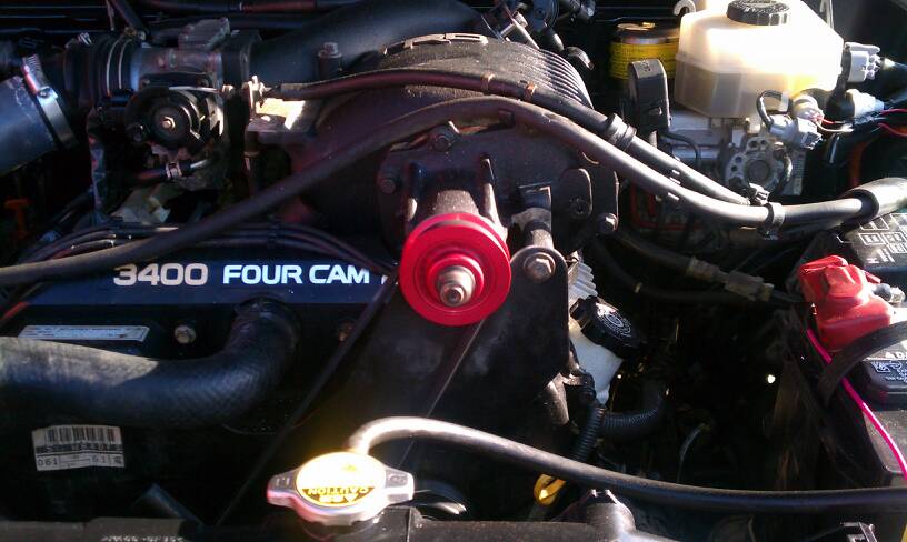

When I accelerate, there is a whining noise that mimics accèleration. In my experience this is a power steering pump. Could this be something else? Mainly when accelerating and not necessarily correlated with turning. Thanks
