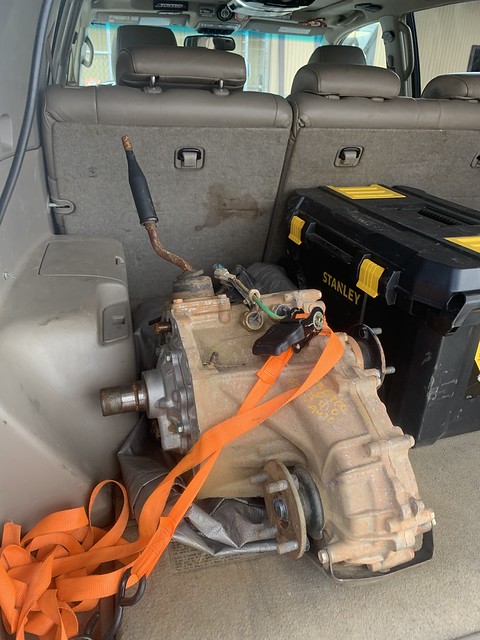

Picked up an FJ Transfer Case from an automatic FJ. My electronic tcase crapped out and I'd rather have manual shifting. I've seen alot of people swap this case in for the V8 instead of getting a part-time case from a V6 4Runner.
