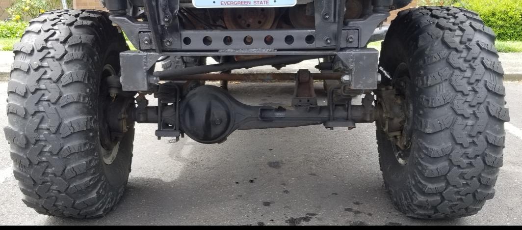

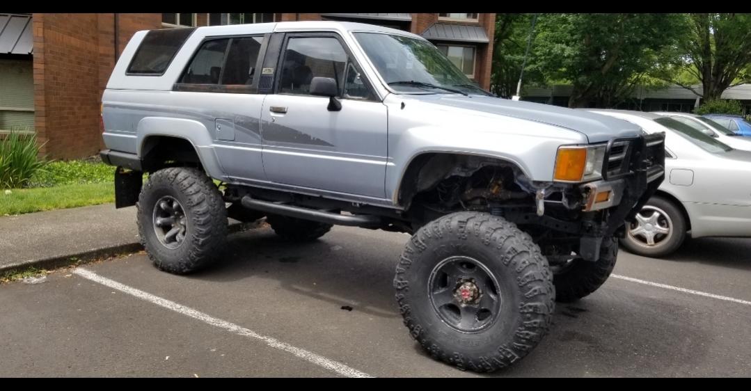

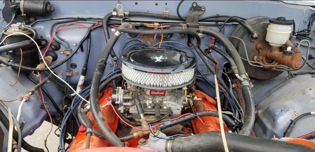

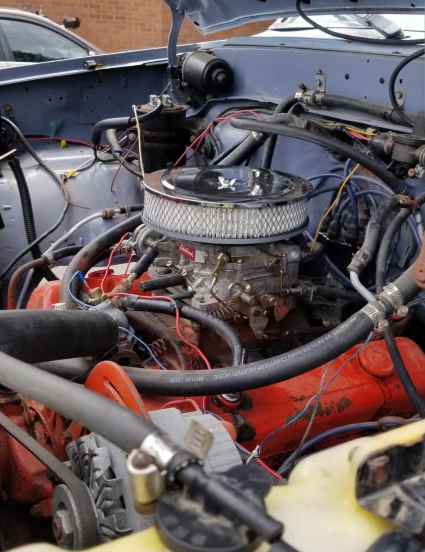

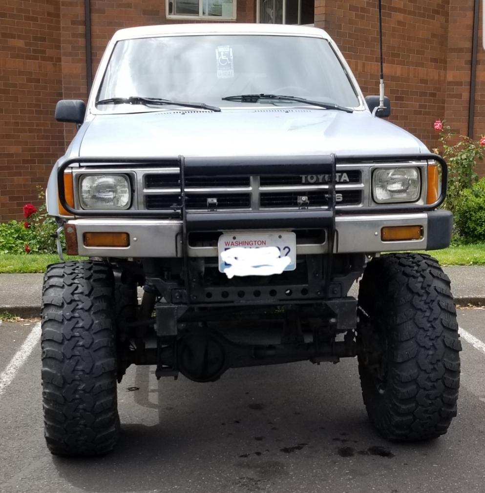

Just wanted to say hi and post some pics of the 89 T4R I just picked up. I didnt do the swap myself. A previous owner did. But it was originally a V6 SR5. It now has a sbc 350, th350 trans, np205 transfer case that sits on 36" Irok Swampers. The tires are pretty trashed. But I thought this was a good start on what I have in mind for my dream rig. Hope you guys like the pics.

i have a chevy350 in my 84 4runner with AA gear
Check out my 89. Sbc 350 th350 np205 w/9 inch lift sas on 36 iroks! Where can I see pics of your chevota?
