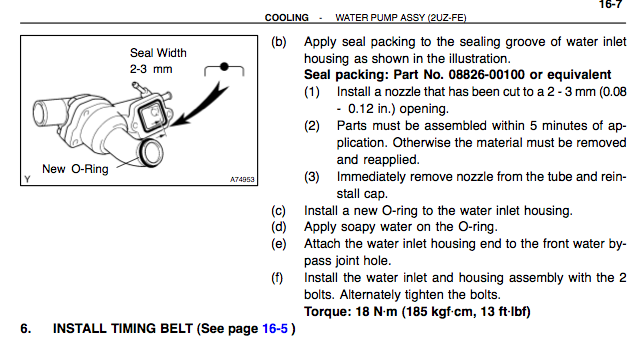

Sounds like a coolant leak then. Someone chime in if I am wrong but I believe there is a coolant pipe that runs just under the intake manifold that gets sealed with an Oring when completing the TB change.
I know for sure in that general area that is the case but its been awhile since I did my TB and can't remember if it was in that exact location. That would be my guess though
762x51 is correct. The illustration below shows the coolant pipe and o-ring. I would also suspect that o-ring to be leaking.

I just had the O-ring fail on the water housing on my '03 4.7. I had the same thing. At first it was a dried splotch of coolant, then a constant leak when the O-ring let go. Do not let Toyota fix it for you. I was quoted over $500 dollars to do the job. I went to parts, and was able to get the o-ring, the approved toyota sealant, thermostat, and a gallon of coolant for $80. The job took 15 minutes to complete, then I let the housing sit for two hours so that the sealant could cure. Super easy repair.

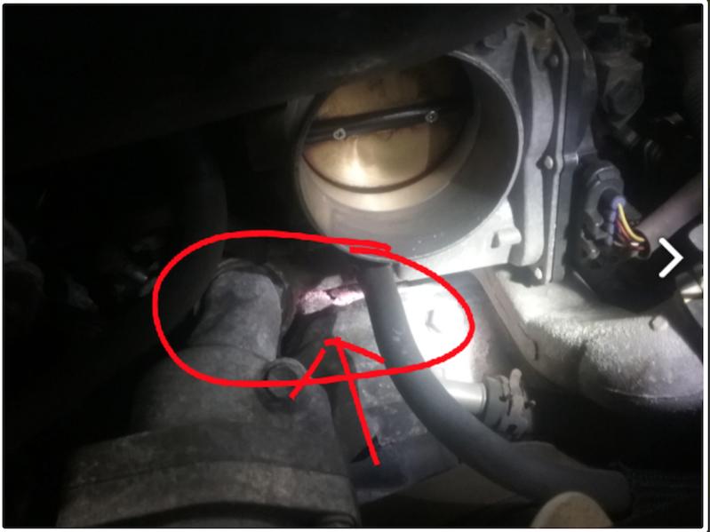

I believe I have this same problem of a leak. I KNOW my coolant is leaking due to having to refill it, although its a very slow leak. Also I took it to the shop for one thing and the did a free inspection and picked up some other issues, this coolant leak being one of them, and I'll quote the report "Bad coolant leak under the intake. Recommend drain and fill, repair under the leak" . They also quoted me $600 for the repair.
I've attached the photo of the leak. Is there a write up or walkthrough you made to do this fix?

Draining coolant and removing the thermostat housing are very early in the timing belt replacement procedure so I'd look at those DIY's for some tips on what to remove, how to remove, and how to reassemble. I'd also recommend OEM toyota gaskets - the aftermarket oring I got for this position on mine failed. Then the other oring tore on reinstall. Then my water pump failed. Then..... well you get the idea. At least you'll get really good at taking it apart and putting it back together by the time you need a timing belt!
I appreciate the advice! The more I look into the various minor, but needed, repairs, the more they seem to be all connected. I want to just fix it all at once because I'm planning on replacing the water pump, timing belt, etc.. in about 10k or less miles... but the most logical and easy thing isn't always the cheapest thing. The wallet sure isn't ready for that.
