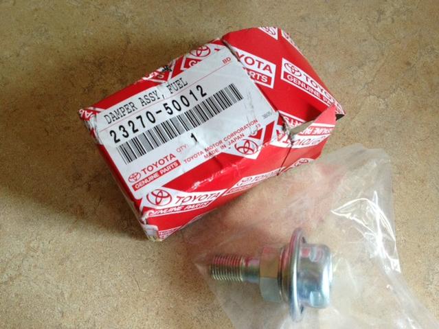

I went to Toyotapartszone.com and got this OEM part for $83 (including shipping to NJ).
23270-50012 - OEM Toyota DAMPER ASSY, FUEL PR
If the knock never comes back, I may return this one too. Perhaps reseating it was all it needed. Who the hell knows. All I know is that little noises from the engine make me nuts.
Will keep you updated.

Got the new part and plan to put it in tomorrow.....

Out of curiosity, I ordered and received the Toyota part from Partznet the other day. Installed it at lunch yesterday.
Knocking is still there.
This "fix" might work for some, as these dampers do sometimes go bad, but it is not a solution for the piston slap noise experienced by many 4.7 owners.
80-something dollars down the drain.
