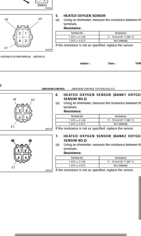

Any suggestions on how to test an installed 02 sensor to see if it's up to OEM quality/spec? I'm thinking along the same lines. Another issue is that the VSC/VSC TRac lights came on - no CEL - after the O2 sensor install, and after inspection. I read a thread about different scanners not being able to zero out the VSC system, or doing it incorrectly, and the pin short option for fixing. I'm guessing these two things are only slightly related.

Needs to be around 11-16 ohms around room temp. They show another way holding idle at 3k rpms for 3 min then testing with dlc3 or oscilloscope.

Thanks for all the suggestions and keep 'em rolling! It's not a vvti engine - I think that the variable valve timing showed up in 2005, and mine is an 04.
