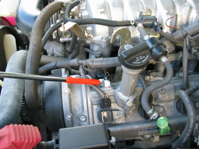

I just can't seem to find this even though I have the new one in hand so I know what I'm looking for. I've changed these many times in the past so I at least know around where I should be looking but still can't find it. Can someone point it out to me or a picture would be even better.

From the diagrams, it looks like it is loacted behind the oil filler neck, directly mounted to the valve cover. It is referred to as a "ventilation valve".

Thanks, I will take a look for it after work. Any chance you can post the diagram? No problem if you can't since I now know what and where I'm looking for but I though I'd ask.

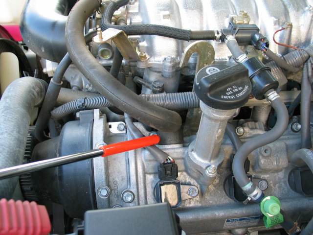

Just looked at my '03 and if you are standing at the front of the truck's it's in front of and just to the left of the oil filler neck. If you are on the left side it's to the left and slightly behind the oil filler neck. There's a hose connected to the PCV valve that goes up under the silver plastic cover that covers the throttle body. The valve appears to be pretty easy to replace. Guess I'll be going to Auto Zone tomorrow and picking one up.
Thanks guys. You're right it is camoufloged! Here are some pics for good measure

Put mine in today and it took about 10 minutes, start to finish. I pulled the wires off the #1 plug pack to make it easier to access. You'll need either a 22mm open end wrench or an adjustable wrench big enough to fit that size nut to pull the PCV valve. None of the parts stores around here carry the PCV valve for the 4.7L so I wound up going to Toyota and paying $9. I'm sure there must be cheaper ones out there.

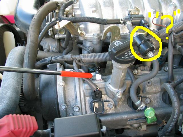

I've just replaced the plugs in my 05', and tried to get the PCV pipe to come loose "need a bigger wrench". But, while I was there, I noticed this filter thing by the oil neck, and haven't a clue what it is??? Looks like a fuel filter "which would be excellent and easy to replace", but not sure. I've attached the photo from the first page, and circled it in yellow. Can anyone tell me what that filter is?
Thanks all!
