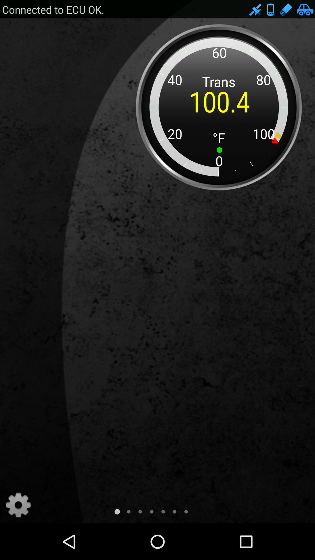

I don't understand why my paid version of the Torque app does transmission temperature and nobody else's does. I've not entered any fancy equations or bought any adons. Just the paid version of the app.
Here's what I see. The temperature is low because it's been sitting for a few hours. During a normal drive it's between 150 and 180.
I don't either. Could it be the adapter I wonder?
