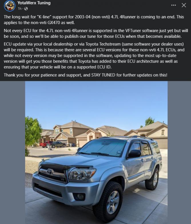

Fingers crossed they come out with something for the non-vvti engines sometime soon. My only regret on buying my 2003.
Might have to pick up one of these tunes and sell my used sprint booster to offset the cost...
Wish there was a dyno chart for the V8
Crossing your fingers
Way to speak it in to existence!!
wait .... what....? for real??
holy crap... this is literally what I have been longing for on my '03 v8! Definitely keeping my eyes peeled for this. This would mean once my cat's fully go and the spacer methods stops working I can get my hands on a set of DT headers and have the possibility to flash the ecu..? :car:
Yeah, you and me both. I'm still going to try to incorporate cats on mine with the DT long tubes but having a working tuner for making adjustments would be awesome. Especially if we can play with shift points.
