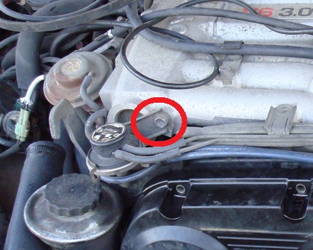

I have the 3vze 3.0 v6. I decided to replace the stock valve cover seals and do some cleaning. Most of the emissions stuff was already disabled from the last time I did some repairs so I removed all of it to free up some space.
Attached is a pic with a small bolt that holds a bracket. If you remove said bolt, please reinstall it as it will leave a hole and let the engine suck air in. You may be trouble shooting your engine for almost 4 hours befor you find it too....
:ybrick:
(pic is not my engine, found it on google.)

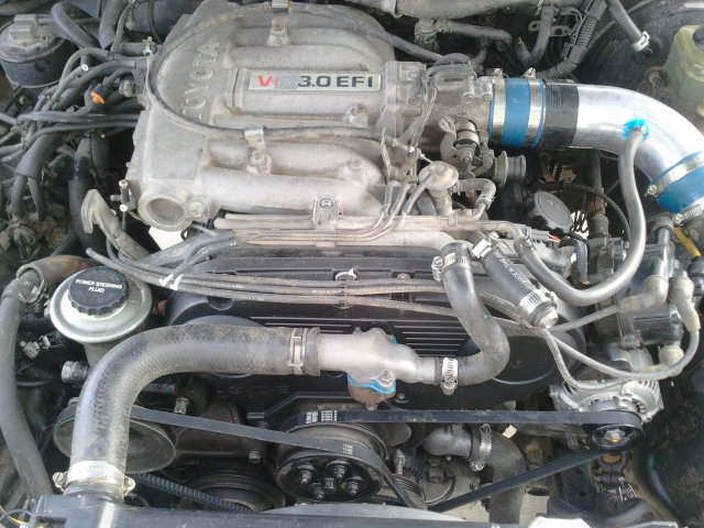

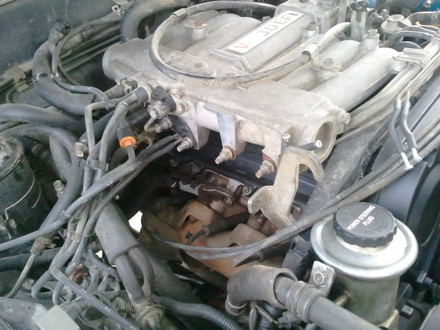

Heres some pics of my engine after I cut and removed the egr and air valve.
If anyone spots something I can do better, please let me know.
