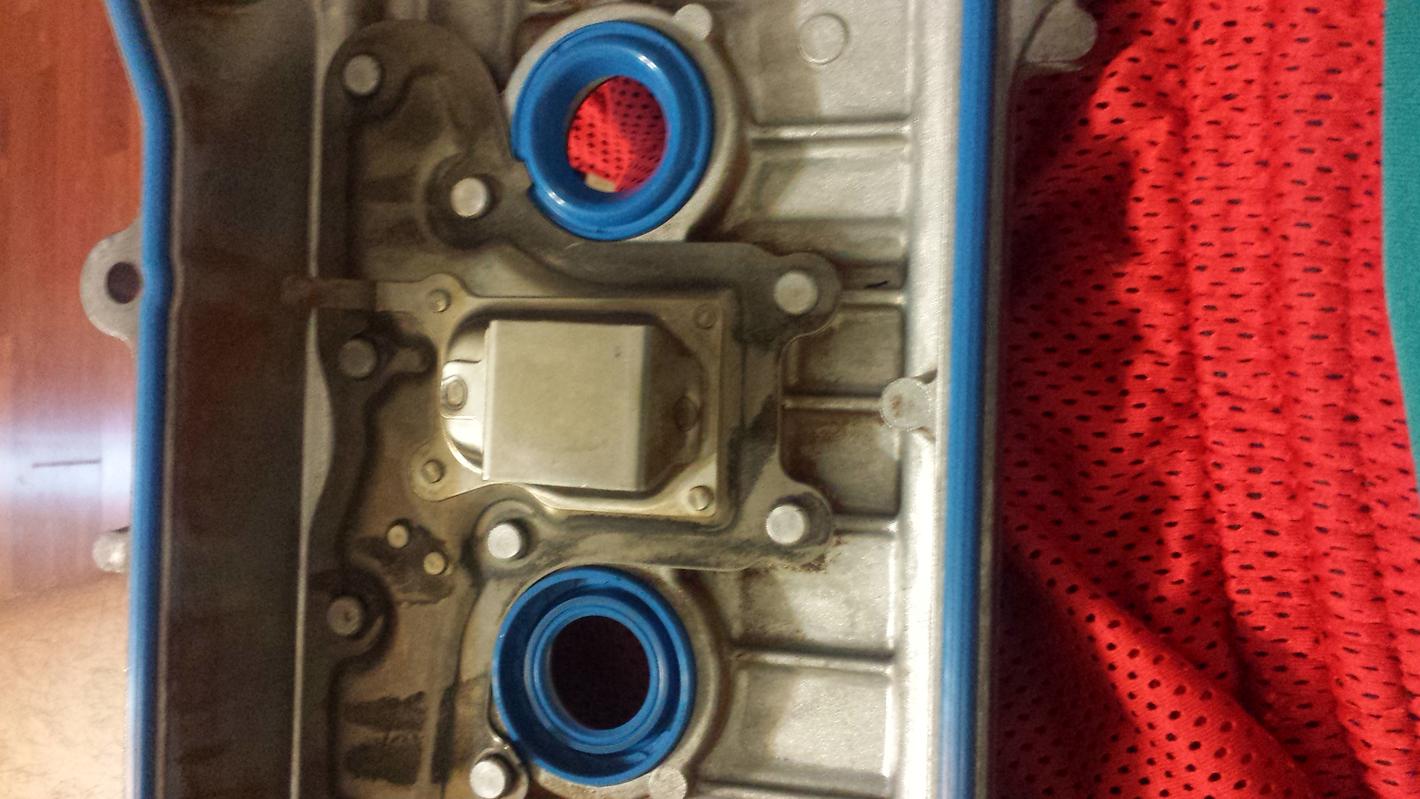

I dont understand which way these are supposed to go. The one on the top seems like it would be the right way but in the video it looks like they put it in like the bottom is.

Bottom one is correct, if I'm remembering correctly.
Two ways to check:
1. Look at the other valve cover if you left the gaskets on
2. Fit a grommet over the exposed spark plug tube in the engine. It will only fit on one way
The top one is correct. Add some grease to the hole to help guide the valve cover down over the spark plug tube.

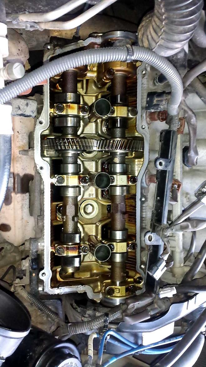

That is nice and clean underneath. Let's see a pic or two of the cams.
Two ways to check:
Compared to the old it looks like it would go like the top one. And also fits on this way. But it makes sense for it to go the other way as well

Im not doing anything but the gaskets. And its that clean because i cleaned it up a little. I also need a oil change...

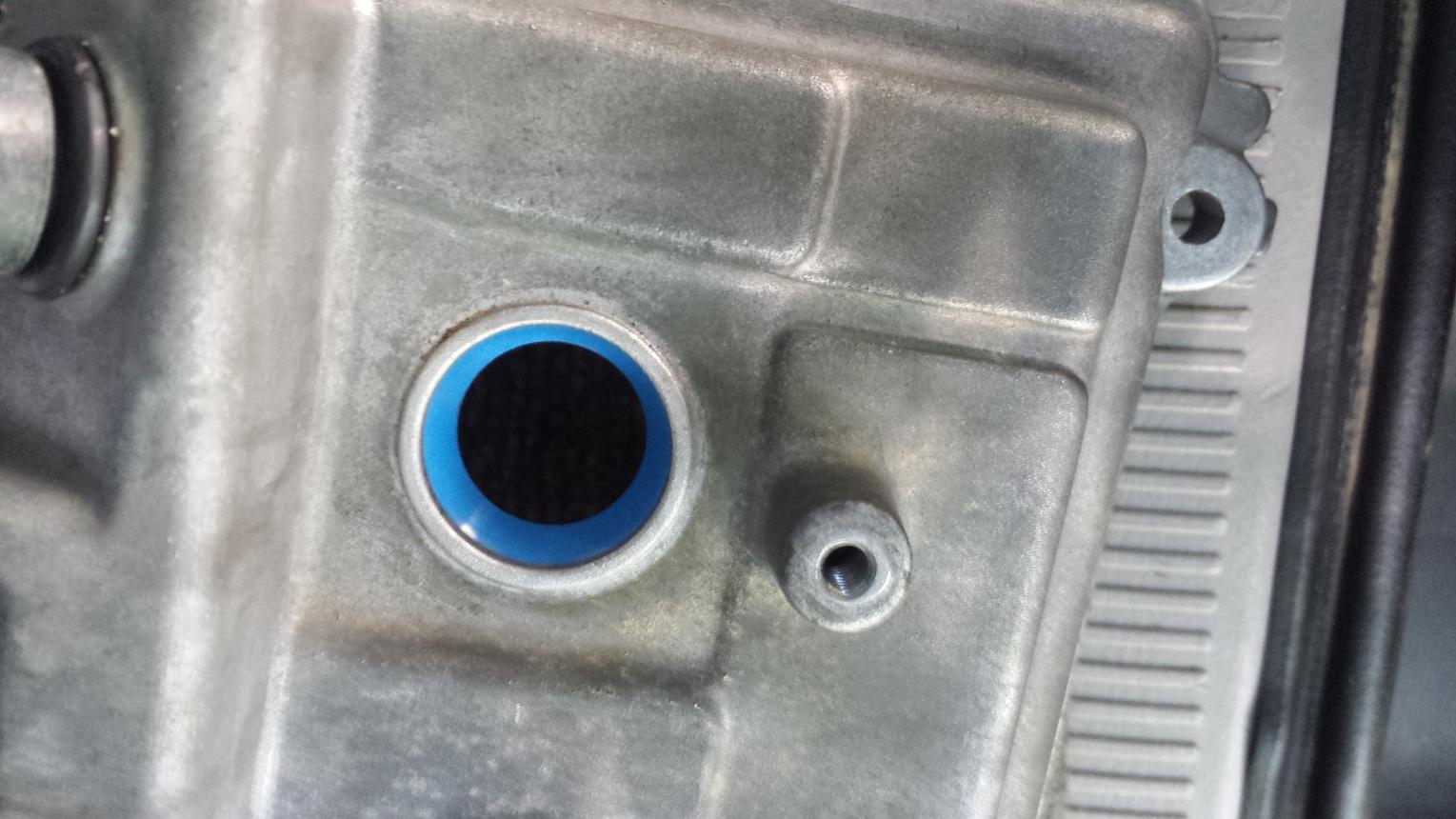

Dangit you both gave different answers. Im back where i was to begin with. Heres a top view of what it would look like if i put it in like the BOTTOM one in the picture.

TOP ONE.
When you slide it over the Spark plug tube, it's going to slide into that gasket.
If you have the the other way, the bottom one, it's going to catch on the tube and rip.
TOP ONE.
Ok. But i was able to get it over the spark plug tube both ways. After comparing it to the old one it does look like the top is the correct way even though these non oem gaskets are Slightly different than the oem ones.

Lol, that's why I added the "if I'm remembering correctly". Sometimes my memory betrays me.
OP, you want to follow how the old ones are installed if it seems like to you it fits either way.

Yep, the top one. I'd send ya a link to mine but I am at the airport at the moment.
Just hope a leak doesn't appear down the road where you have to remove the valve covers again.

I'm guessing I am remembering correctly, I did install them like you had on the bottom. Seems as though others did it the other way but none of us are complaining about leaks so I guess it works! BTW the service manual is useless for this one, doesn't say which way. Rare.

Just wanted to say i ended up doing it like the TOP because that looked closer to how the original was. To me the other way makes more sense because it seems like it would seal better. I just drove around and it doesn't appear to be leaking however it threw a code a little down the road scanguage read(po330, po325) i quickly found out that I hadnt plugged in a wire that had ended up behind the timing belt cover (i dunno how) plugged it in and code went away. I'm still doubting myself which sucks because I am driving 4 hours to college tomorrow. Wish me luck.
