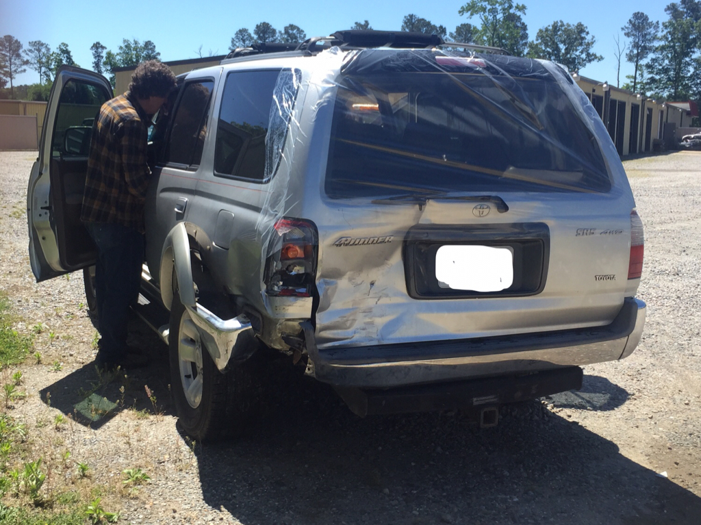

Once that was done, my fiance continued to drive it back and forth to work until one bad day she called me to tell me she had been in an accident. Some dude in an Explorer slammed into a Porsche Cayenne going about 65 and the Porsche then slammed into the back of the 4Runner. Thankfully my poor fiance was okay for the most part but it really hurt her neck and back. We didn't care about the vehicle much at all at this point.
When it came time to deal with the 4Runner, I really didn't think the damage was enough to consider it totaled but that's what the insurance company determined.
Well...we didn't want to get anything else for what they were going to give us for the 4Runner and we didn't have enough to make up the difference for something more so we went ahead and took the money, bought it back, and had it fixed. Our local body shop, Knox, did a freaking AWESOME job. I was ecstatic with how well it turned out.

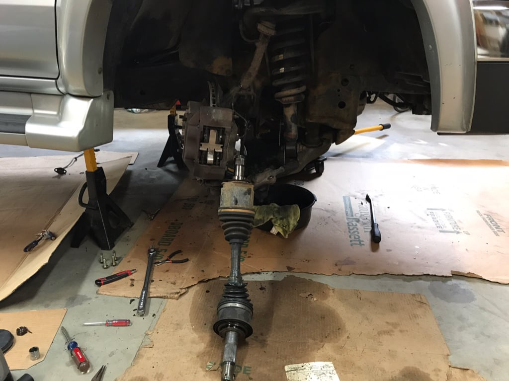

I knew there were a few issues going on so I went ahead and put the truck up on jack stands and low and behold....the right side CV axle boot was busted and slinging grease EVERYWHERE. The OTRE's were both busted. I could physically move the steering rack back and forth by hand. It needed some TLC bad.
I went ahead and did the LBJ's (OEM of course), OTREs, ITREs, steering rack bushings, CV axle, both Air/Fuel sensors (CELs), new rear shocks, and while I was at it I put on some ditch lights, and an OEM fog setup I found on the classifieds to feel like I did something fun during all this mess.
Once I first got it all back together and aligned I couldn't believe how much better it rode! Man those rear shocks were TOAST. The steering was so much tighter. I still can feel that slip joint issue that needs to be addressed but once I do that it will be much better.
