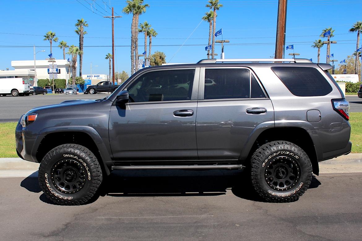

Bone Stock June 2-3 2014:
So I have been a little MIA on posting some of my mods on here, but here you go!
Mods that I have put on since:
Bilstein 5100's Front at 1.75'
Bilstein 5100's in Rear
265/70R17 Goodyear Duratracs
17' Method NV Wheels 0' Offset
6K Xenon Heads and Fogs (Not pictured)
LED Interior Swap (Not pictured)
Apologize for the lack of quality photos/consistent posting on my updates for the runner. Been a busy and hectic summer...
Finally got time to snap some quality shots of the rig.
2 JL Audio 10' Subwoofers
2 Alpine Amps
4 Alpine Speakers
2 Alpine Tweeters
Demello Offroad Sliders
Vinyl Wrap Silver Pieces on Front/Rear Bumper
Painted Metallic Black Rear Tailgate Piece
Painted MGM 4Runner Emblem

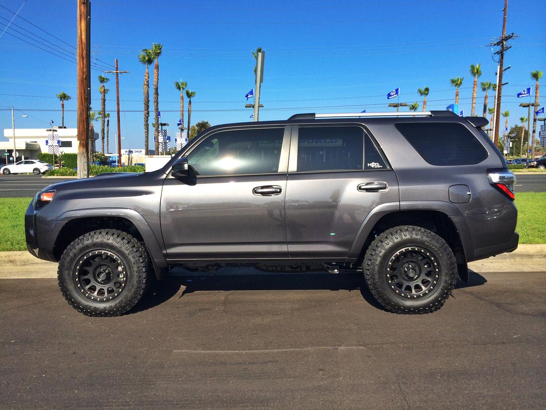

Great looking Runner, simple and looks well put together. The vinyl/paint looks really well done.
Thank you!
The vinyl is actually poorly done sadly. I have to take it back to the place to get it redone because it's already peeling off and it hasn't been a month.

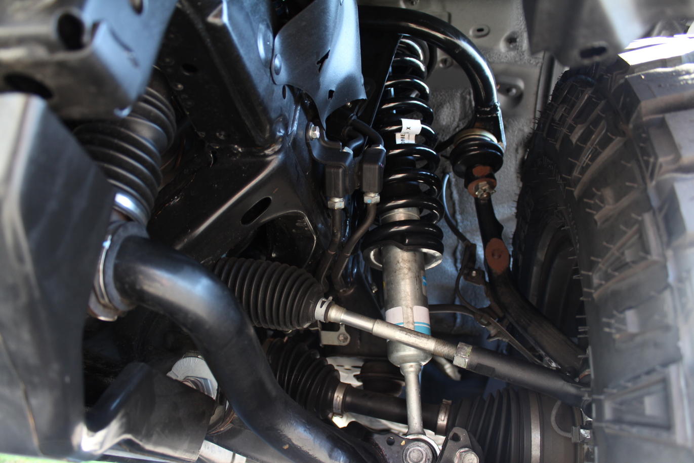

New suspension upgrades:
Light Racing UCA's
OME 885 Coils w/ Bilstein 5100s set at .85
Rear Toytec Springs
Differential Drop Kit

Nice ride. Wish I could have found 5100s. It would have been much cheaper! Question, why'd you drop the diff? Just curious.
Thank you! The differential drop is made to make the CV angles less harsh. When lifting the truck, especially over 2.5 inches, the CV angles may be too gnarly, causing the boots to rub together and making everything wear out faster. By installing the differential drop kit, it lessens the angles, therefore the boots do not rub and the components do not wear out as fast as before.
