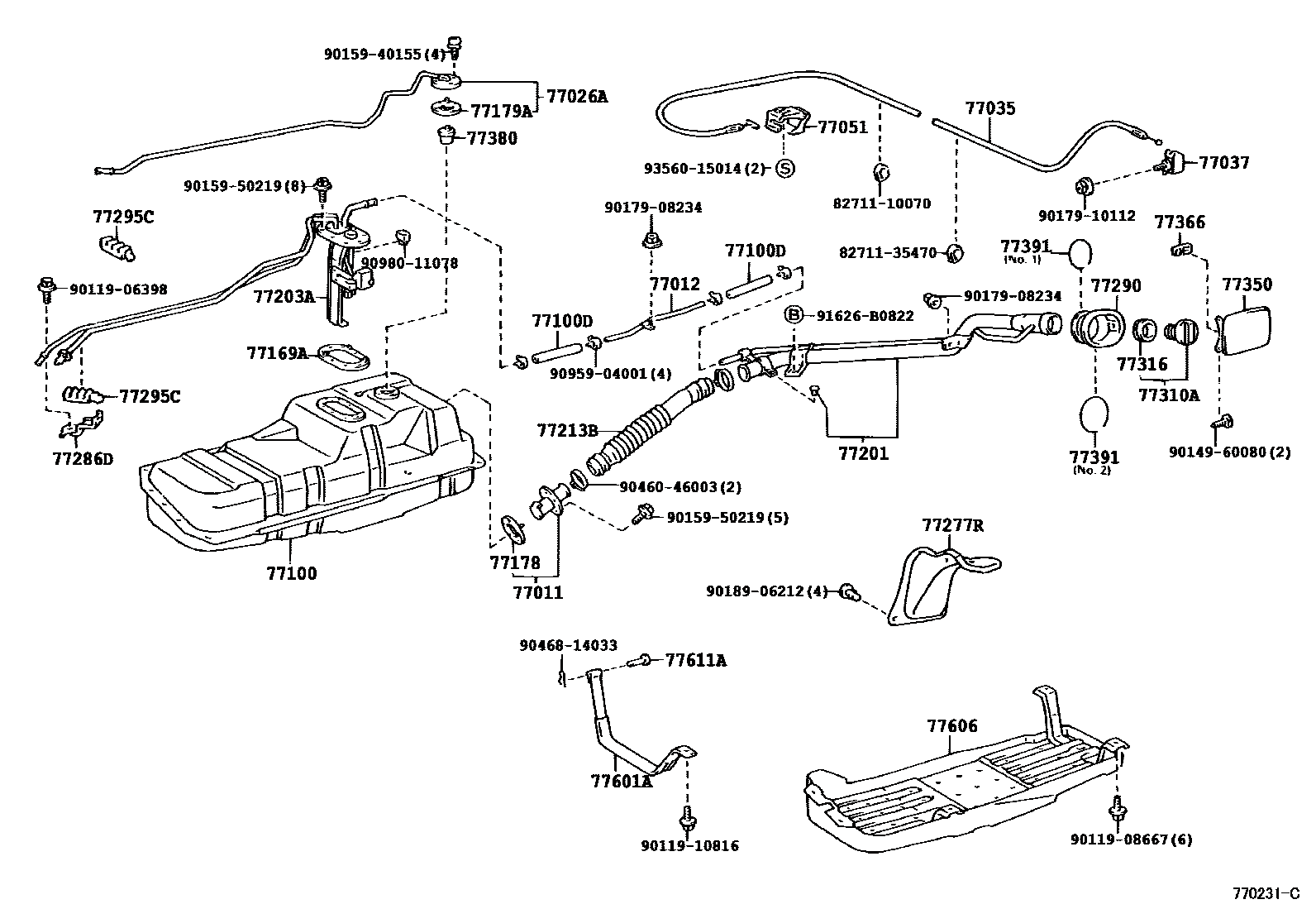

Check out the exploded view and notice the "filler neck" has many pieces to it. Which piece(s) do you need to replace? The part I was talking about is 77203A.
I was considering finding a used tank in good shape and just refurbishing it then putting it in.
Sorry about the large picture format. Oh and those aren't part #'s either (well part of it is). They're just reference #'s so that, as someone explained to me on here, (think it was The Durk) you can't click and paste the part #'s to find competitive pricing.
