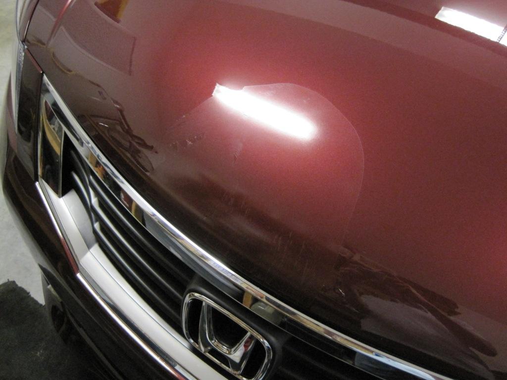

I wanted to share this with everyone and would like this to be pasted all over the web so it does not happen to anyone else. I have a 4Runner and was thinking of doing this one day, but thank goodness I did not!
In the event to protect my wife's '08 Accord EXL with OEM paint in perfect condition I bought the Invisible Mask product. It did not go on as well as planned on the hood and left small bubbles under the film even after 4 weeks of being on, so they sent another hood part to me. While following ALL directions to remove the film it pulled off the clearcoat down to the basecoat. It has a disclaimer that it may do this to non OEM paint, but this was 100% OEM paint. So I did not even use the replacement film they sent and don't plan to because this happened. Now I have to pay to have the hood partially painted and all cleared, unless they agree to pay for it...
See the picture attached and I would NOT recommend using this product.

Yes, I'm a perfectionist and did not like the way the first one went on, so I left it on for 4 weeks because they said the small bubbles under the film would go away and they did not. So I emailed/called them several times (very poor response on their part) and finally they sent me a new hood part for free, but while pulling off this happened! I was so mad to say the least. It's not supposed to do this on OEM paint as we have. They have a warning that "If the paint protection film is removed, it is possible that the non OEM painted surface could be damaged in the removal process. The buyer recognizes this risk on non OEM paint and InvisibleMask can not be held accountable." So this tells me that if it's OEM paint they should pay for it to be fixed? We'll see. Their respose is not that good and I want to get the word out there to beware!

Yeah, it's too bad it happened. As far as the one question "could I see it peeling the clearcoat when I was removing" Well this stuff is like glue, I mean super glue on the hood. It does not tear and when peeling off you have to use both hands and peel a little at a time. Then you have to get the glue off the hood. I used wax, but some say you can use adhesive remover safe for paint (yeah right, not on my paint after this happened). When you reach and area that it not sticking and you're pulling with such force it's like someone letting go of a rubber band. It snaps back at you and you don't have time to react. That's what happened here. I was pulling slowly with a good grip and then all of a sudden it was like oh SH%^! It was too late. They will have to sand, prime and paint that area, then clear the entire hood. I was hoping they could clear only, but because it's at the base coat and they have to sand around the clear it just better to prime/paint that area the size of a basketball, then clear the full hood. Not too worried about color match, because of where it's at and the color is fairly new. So matching should not be a problem.
Thanks again and pay someone to do this for you if you have it done. Make sure their work covers damage like mine should you need to have it removed one day.

Is this a 3M product bra? Never seen any of their products do anything like this. Unless there was a chip there before you put on the product and it brought up the clear as you yanked it off

Should of used a heat gun and WD40 to remove that film, how did the manufacturer recommend you remove the film?
