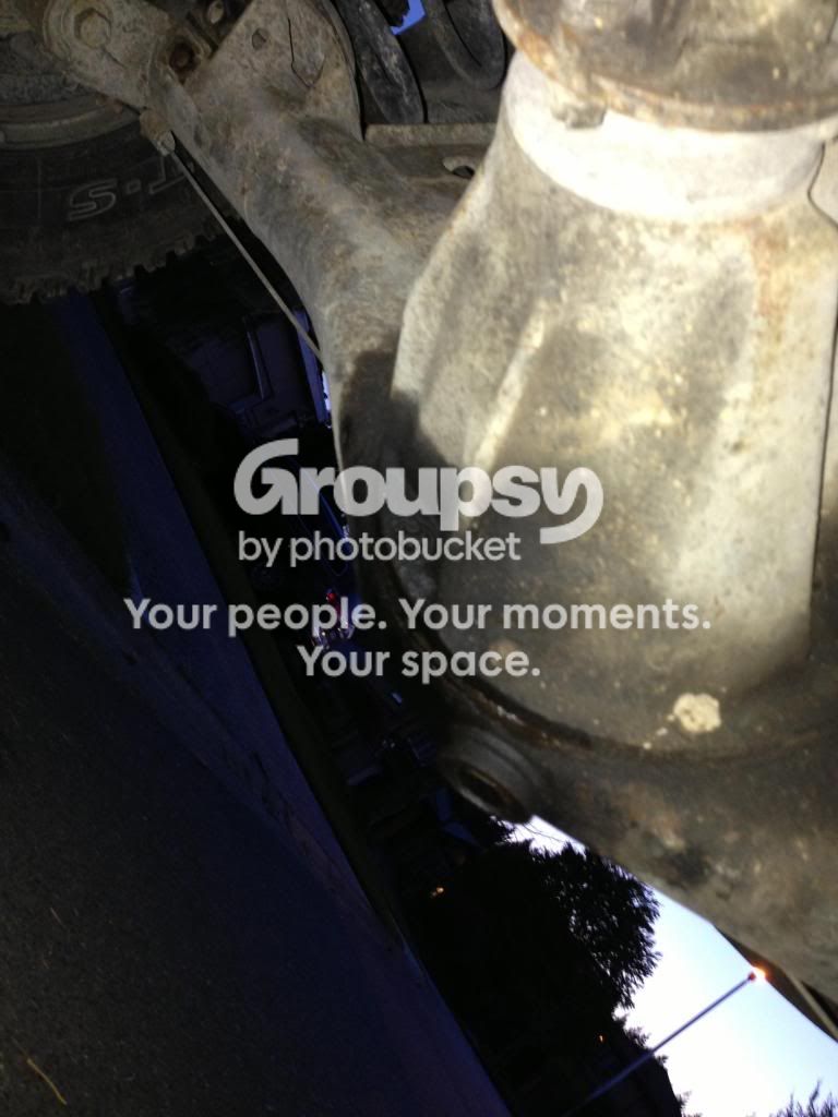

Well, Im now back home from university. Over the past 8 months, I've kind of neglected my 4runner on the maintenance end. My CV's have been torn and leaking for over 6 months now and in the last month or so, I've noticed that my rear diff has a slow leak where the 3rd member meets the axle housing as shown below:
Now, from my research, it seems like the best way to go for the rear 3rd seal is to use Toyota orange silicone FIPG. I've also heard that a generic $4 FIPG will be completely fine? Should I replace the whole diff drain plug or is there a crush washer or something that specifically needs to be replaced?
In terms of the CV's, I was going to replace the whole axle shaft, but I'm now hearing that aftermarket CV's suck, even if they come with a lifetime warranty. It seems like I am better off getting the $30 Toyota reboot kit and rebooting mine. They have been torn for a long time now, but I dont notice any characteristic clicking and I've heard of other users going 1 year or more on torn boots with no CV problems.
I found a reboot kit from an online Toyota dealer site for a tacoma, but as far as I know, they are the same?

yummy- shock juice. That stuff stinks. Yep, probably better change those. Your springs should work fine with the Tundra 5100's. They have 4 perch settings (0.0, .75, 1.75, 2.5) Pretty sure on those numbers. How old are them springs? If they're as beat as them shocks are, you may want to put some new springs on if you're already putting new shocks on.
