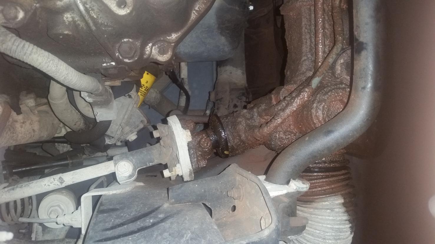

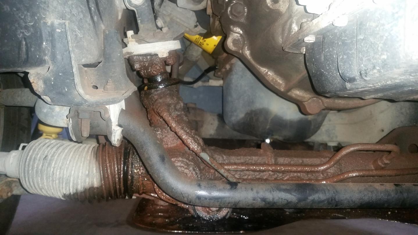

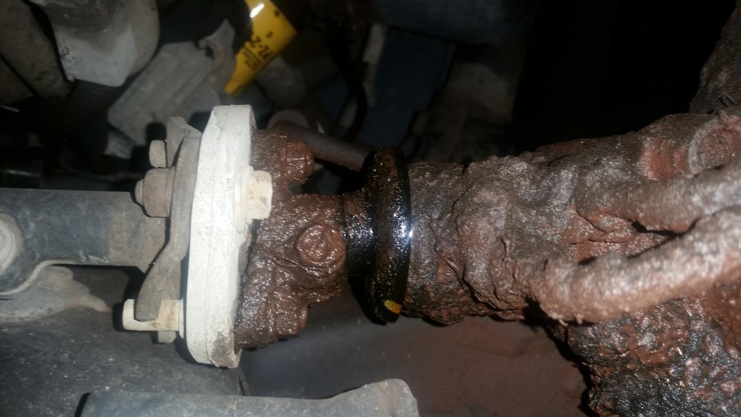

There also seems to be a power steering leak. (Ill attach poctures)

Holy crap that rack! Did you pull it from the bottom of the ocean?
Of course I'm from CA so I'm not even sure what color rust is...
Thats not rust, its tons of caked on power steering fluid and possibly oil from before i changed the valve covers. I took the skid plates off and covered it all in degreaser and cleaned it today. Im not sure exactly whats leaking, but it looks like its coming from the square part on the top with the black disc. I have to top off the power steering fluid fairly often. It actually started off its life in california (so it has the two o2 sensors) and has since lived in texas, south carolina, virginia, rhode island, florida, new mexico, and nevada.
Yeah, I'd say that's a pretty significant power steering leak. I wonder if it's the pinion valve assembly causing the leak. I looked up the schematic on Camelback Toyota's website. Here's the link:
https://parts.camelbacktoyota.com/p...siteid=214329&vehicleid=84047&diagram=8414260
It looks like in the schematic that there's one or more seals, o-rings, or washers in that assembly and maybe one of them is causing the leak.
