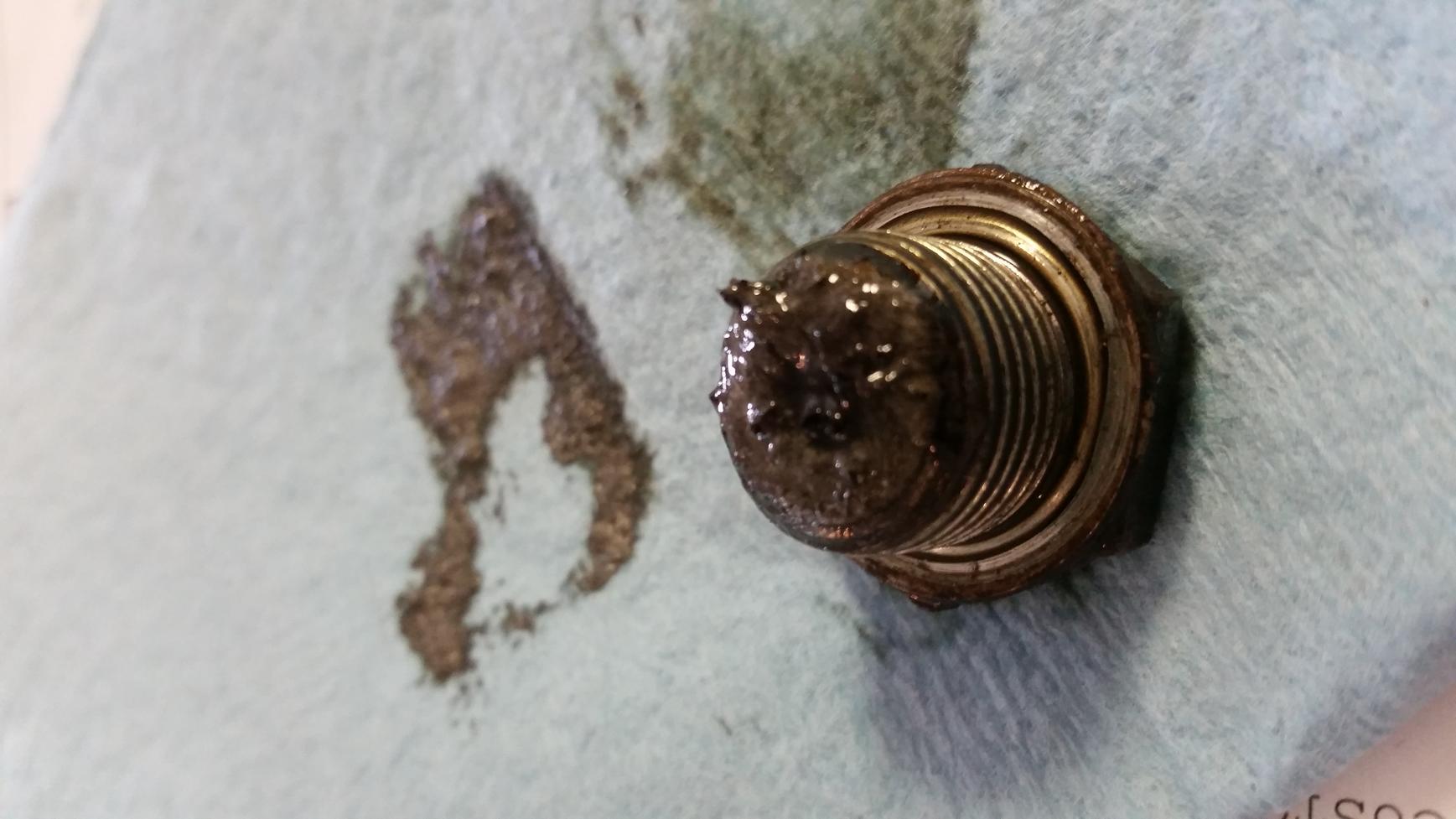

Have you checked the fluid or magnetic drain plug in the rear diff? The fluid would most likely show signs if the differential was on its way out. Especially if you find metal shavings on the magnetic drain. I would drain the fluid, inspect and refill. It is cheap and could possibly rule out or confirm the diff. It may even fix the problem if the fluid level is just low or very old.
Sent from my SM-N910V using Tapatalk
All of what you said makes sense but even if your diff is in good condition you'll have metal shavings. Even after 30k miles you'll get them.
You will have metal sludge, but shavings, especially of any size or excessive quantity can be a sign that the differential is on its way out.

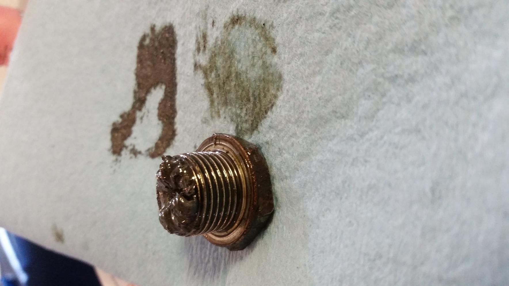

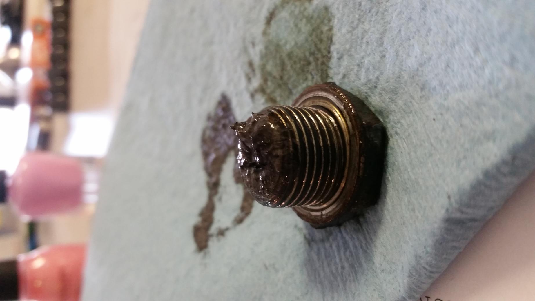

So I pulled the plug to change the diff fluid and it looks like this. This very well may be the first time in its 15 year, 200k mile life of being changed. Does it look abnormal? I scraped it down the middle in the last pic to see how thick it is.
Forgot attachmentd.

Well, between fixing the defective u-joint and swapping the diff oil, my vibrations are gone. Tested up to 95.
