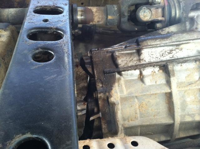

About 2 months ago, started having vibrations starting above 60mph. Vibrations then turned to loud rumble. Then adaptor plate cracked in half. Replaced adaptor plate and rear drive shaft. Well, it's been a month since then and the vibrations have started again! Have heard of a bearing in the transfer case potentially causing this problem? Also, never replaced those rubber counterweights after the first blowout. However, have read those are superfluous? But, perhaps not if this newly rebuilt drive shaft needs replaced again?? Please help!!

Um, what are we looking at there?
Obviously a trans, but from the pic it looks like you're missing a MAJOR piece of the trans?
Maybe a couple more pics from not so close up?
im gonna say that any support bearing on case side is probably toast/ running without out/ have been drivin on with the case cracked like that
:wow2:
Houston, we have a slight problem.
I believe, sir, that you have a trans case failure. Or some really weird lighting effect in the picture.

That is a picture of the cracked adaptor plate. That resulted from what began as vibrations then turned into a loud rumble. I since replaced that adaptor plate and the rear drive shaft. The problem now is I don't want it to happen again! The vibrations have started back up again, after just a month of replacing the adaptor plate and rear drive shaft. Does anyone know about this bearing in the transfer case going bad potentially causing this major issue??
If you drove it like that for a while, good chance you destroyed the bearing(s) in the t-case/trans.

If the vibrations were bad enough to crack the adapter plate in half, they were certainly bad enough to damage bearings too. That is assuming that it wasn't bad bearings causing the vibration in the first place.
