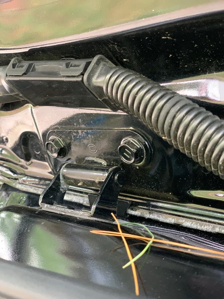

any help would be great the passenger side hook rubs against the body on the inside curve.
does anyone else have this issue? i’ve pulled it as tight as it goes and stuck it but still seems to rub against the body which i’m sure will cause rust [emoji26]
This has only been an issue a couple of times. There is adjustability in the hatch hinges themselves and a range of tolerances for the gap at the factory. It seems like some at the far end (or beyond) of that range are close enough for the ladder to rub. You can loosen the hatch hinge bolts, pull the hatch out to the furthest point in the adjustment, and tighten them back up.

Is there any documentation on how to adjust that bracket as when i see it im not sure how i can pull the whole hatch outward with it open.

I had a similar install issue with mine and I found that I made the problem worse when I plumbed up the ladder. When I installed the ladder in place with the edge of the top bracket at 4.5 inches and pulled everything down tight I had no rubbing. In that position the bottom of my ladder naturally kicked to the right slightly. When I squared it up and bolted it in place, the top bracket twisted away from the hatch on the left edge and rubbed. I was able to get it to stop rubbing by adjusting the ladder in as tightly as it would go, allowing the tension between the top and bottom brackets to hold the ladder singly in place. If I could have done it over I would have left the ladder to fall naturally and bolted it in place. The lean wasn't that noticeable and it was very tight when I clamped it in place.

It will help to have a second person to hold the hatch. Loosen the bolts while the hatch is open. Use a pry bar (with a towel around it to protect your paint) to move the top of the hatch out from the body and then tighten the brackets back up. As long as you have someone else holding the hatch, you can also unclip one side of the hatch struts if they are fighting against you.

tried that but still rubbing, so already on it’s way back sucks i couldn’t get it to work as i really liked the ladder

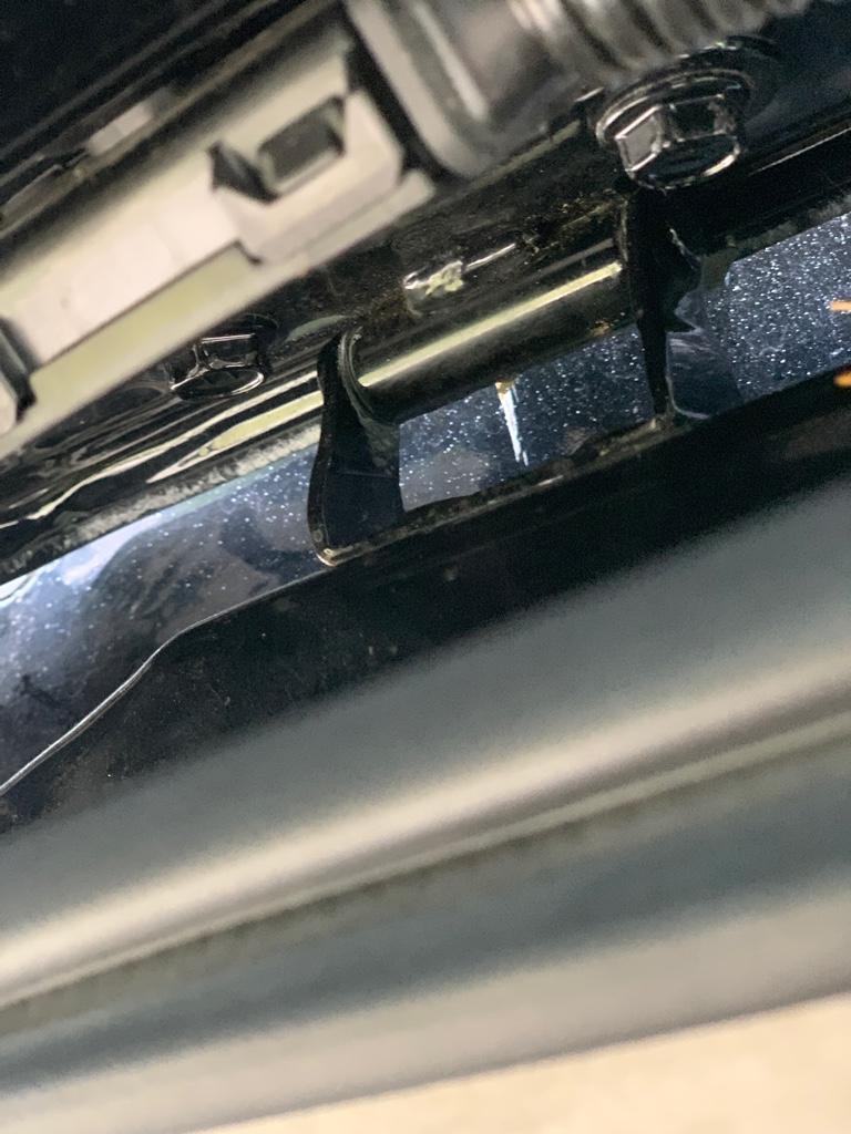

I had the same issue. I reinstalled the top plate 3 times pulling it rearward as hard as possible during install but it kept rubbing on the right hook. My OCD kept kicking in until I finally tried loosening the hinges based on the above post as it sounded super easy. Unfortunately it only got worse to the point the entire hatch was scraping the body. I removed the ladder and tried to get it back to my original pre-adjustment witness marks and I never could get it back. The 4runner has been at the body shop for the past 3 days with them trying to re-align the hatch and fix the body scrapes but they can only get it marginally better. They still have a few other options to try (new hinges and dropping the headliner to adjust the bolts under the headliner), though.

I wanted to comment here after installing my ladder last week. This is for my 4th gen, but something everyone should be aware of.
First, Victory quoted 3-4 weeks and it took 10. Second, they forgot rubber feet, and two bolts/nuts/washers from the kit. Not really sure how that happened, but they have since sent those out.

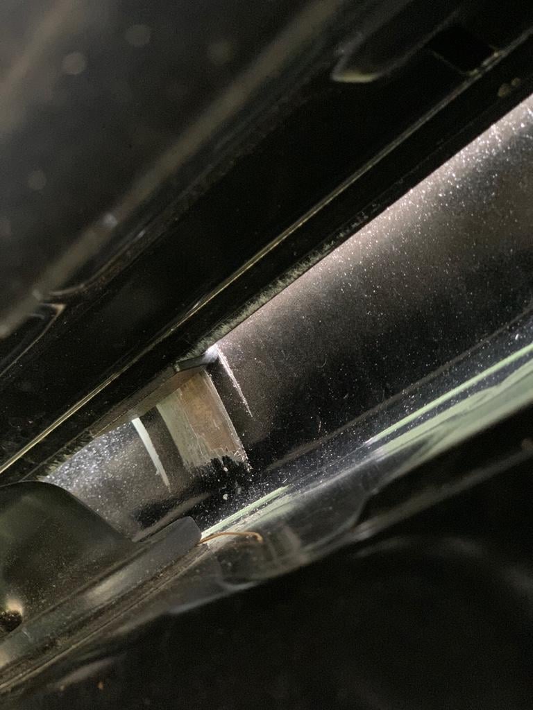

Upon install all seemed well, but after having it on the truck for a few days I noticed that the 'feet' that held it to the top of the hatch had 'let go' and caused scratching as if the hatch was not adjusted appropriately. The hatch had plenty of gap, the issue was that the 'feet' had not been bent enough from the factory to adequately hold the ladder in place.
I took it all apart, hit the feet with a hammer once each to give them more 'grip', and all is working as it should be.
Unfortunately my paint is damaged, and if I had a 5th gen I'd be more upset personally.
How the 'feet' were after a few days.
