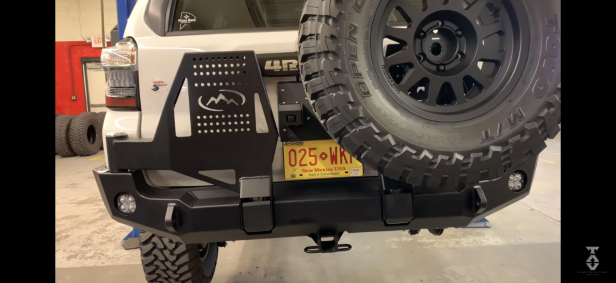

One thing that would fix most of these issues is the expedition one camera relocation kit. It actually mounts to the hatch where the license plate did and then extends from the hatch next to the tire. It is designed for their bumper, but these bumpers seem similar enough that I would imagine that it would work here as well. It also handles the license plate nicely by keeping it on the hatch. This solution looks good as well, atleast when the swing is in. I'll admit it looks a little weird with the swing out as there is a long protrusion from the hatch, but a small price to pay for a good solution. Only possible issue I could see here is the hatch not being able to open as much in a garage. If someone here would be willing to try it out that would be pretty awesome. I have been thinking of going this route, but haven't gotten the bumper yet.
Here is a screenshot of one from a YouTube video for those interested.
