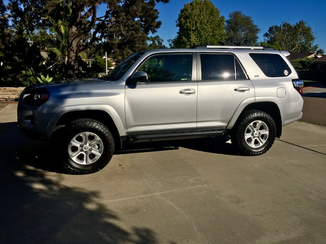

I wasn't sold on the Victory sliders, I think they actually look pretty slick on yours. Seems like they just look like a nice beefy step bar just with added functionality. Is the tread plate wide enough to stand on comfortably to reach things on the roof?

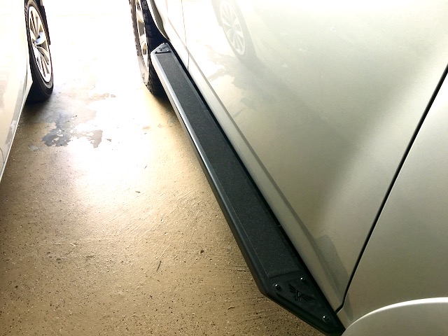

In short, yes, see pic, Im a size 13... and that means a really big... pair of flip flops...
I was a tad skeptical as well, but its more than adequate as a means to access the roof, with the added benefit of being a continuous surface to stand on as opposed to the step bars. Im super happy with the look of these, the pics don't do a good job showing how much there is to work with, even on victory's website.

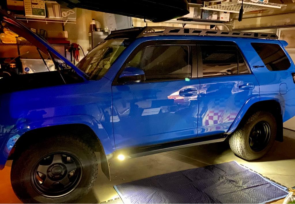

I love the blitz sliders. I’d recommend the dome rock module. It’ll light up with unlock from the fob and whenever the dome light comes on. Can still independently turn them on from the switch pro. Looks like factory.

Awesome looking ride. What do you use for polish on the finish...looks wet :bravo:

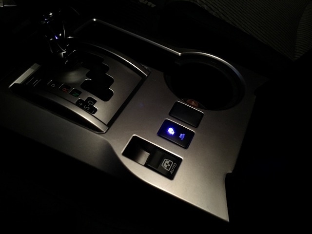

Love my Blitz sliders! They look very clean and the lights are a nice touch (although a pain to install). I had a switch added to the center console.
The step is a little high. but it is nice and wide. I recommend putting some black non-skid tape on the sliders to improve your purchase when wet or icy. It looks better too.

Did you have an additional switch to run them independently from the dome light? or is that part of the Domerock pkg? How long did your install take?
Yeah I just split the wire to my switchpro. I think that took longer than installing the sliders just because of routing the wires and trying to make it look clean.

I was considering adding grip tape as well. Dragging my feet on the wiring, especially since i won't have anywhere to do the work for about 4 months. Does your switch always stay illuminated? I noticed the one for my LED bar never turns off, and i wired it according to the instructions. thinking i may have a bad one.
It's always on, and brighter when activated. It's brighter than I wanted, and I might replace the switch at some point; or see if I can have my tech attach it to the console light dimmer circuit [instead of the one it's currently on].
Good then it isn't just me haha! Problem with it is it drained a brand new optima battery when i got back from a 4 month deployment. Finally pulled the trigger yesterday and got a switchpro.
