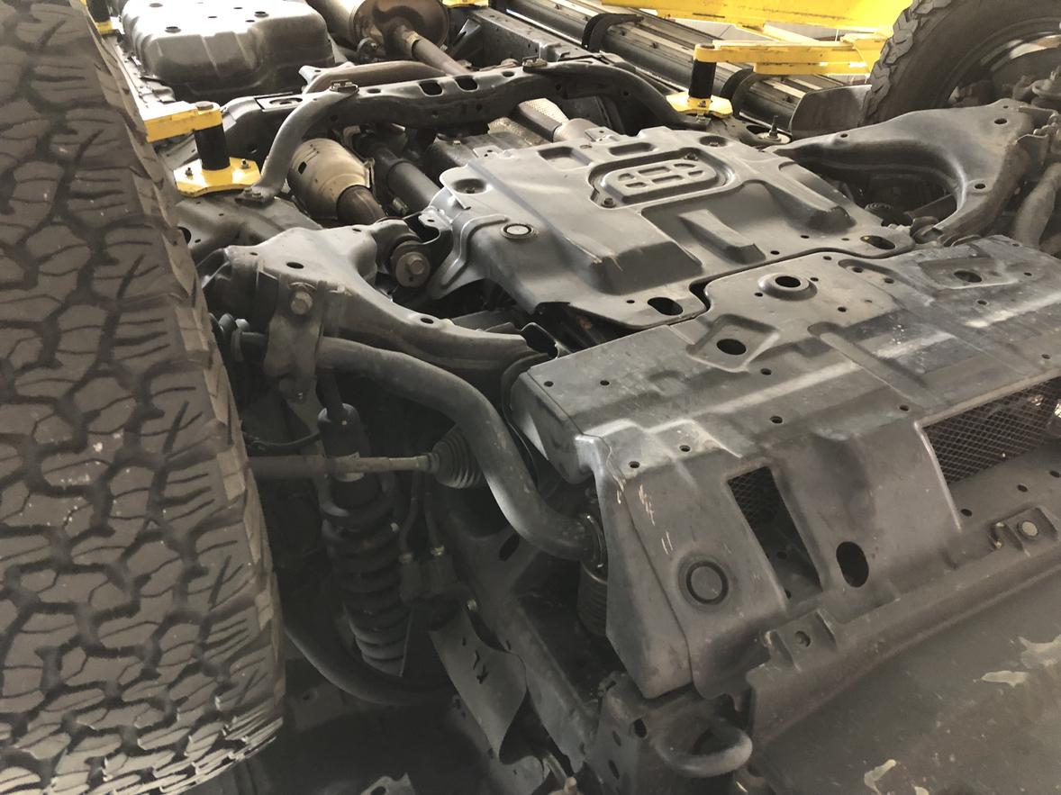

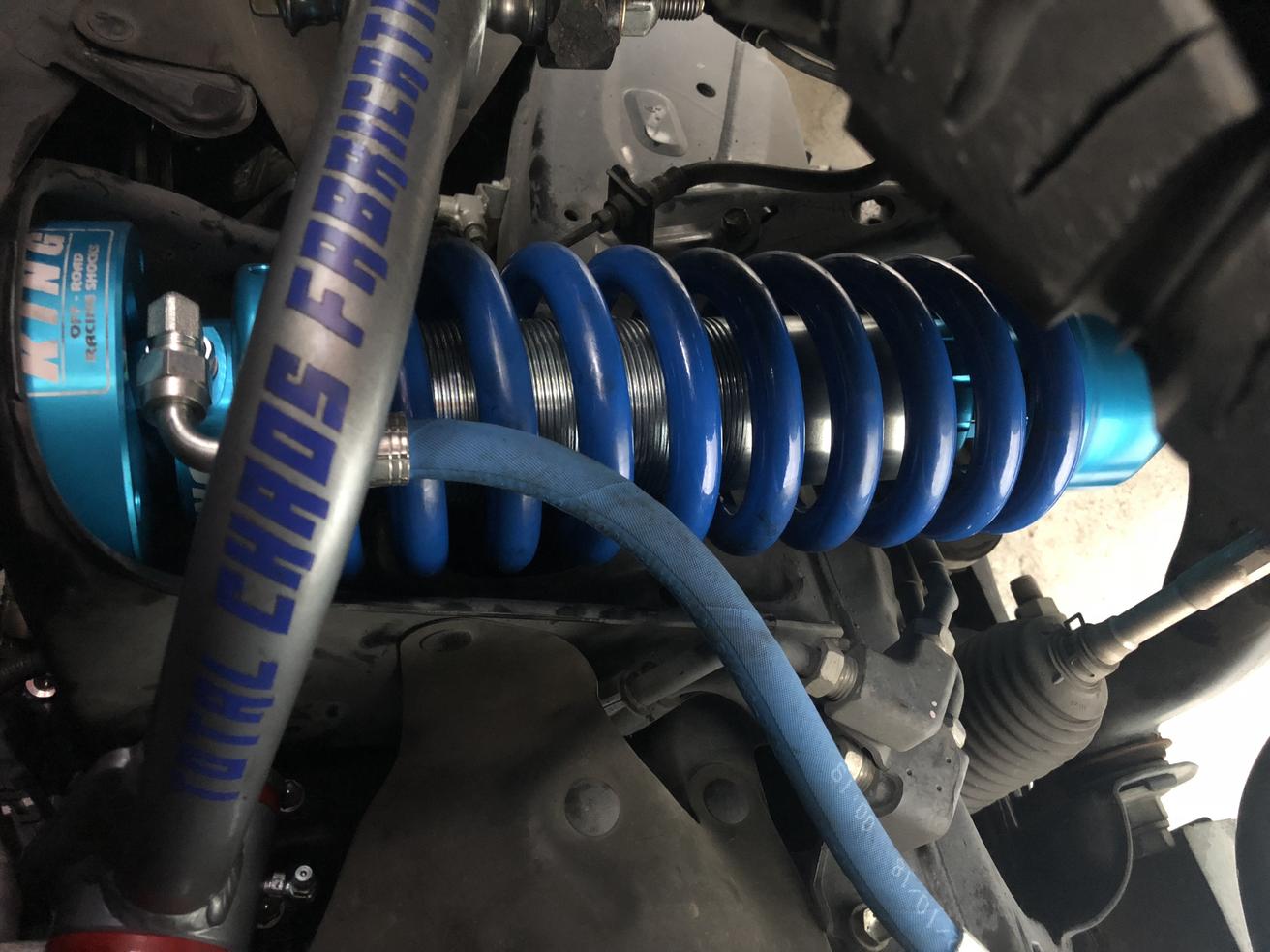

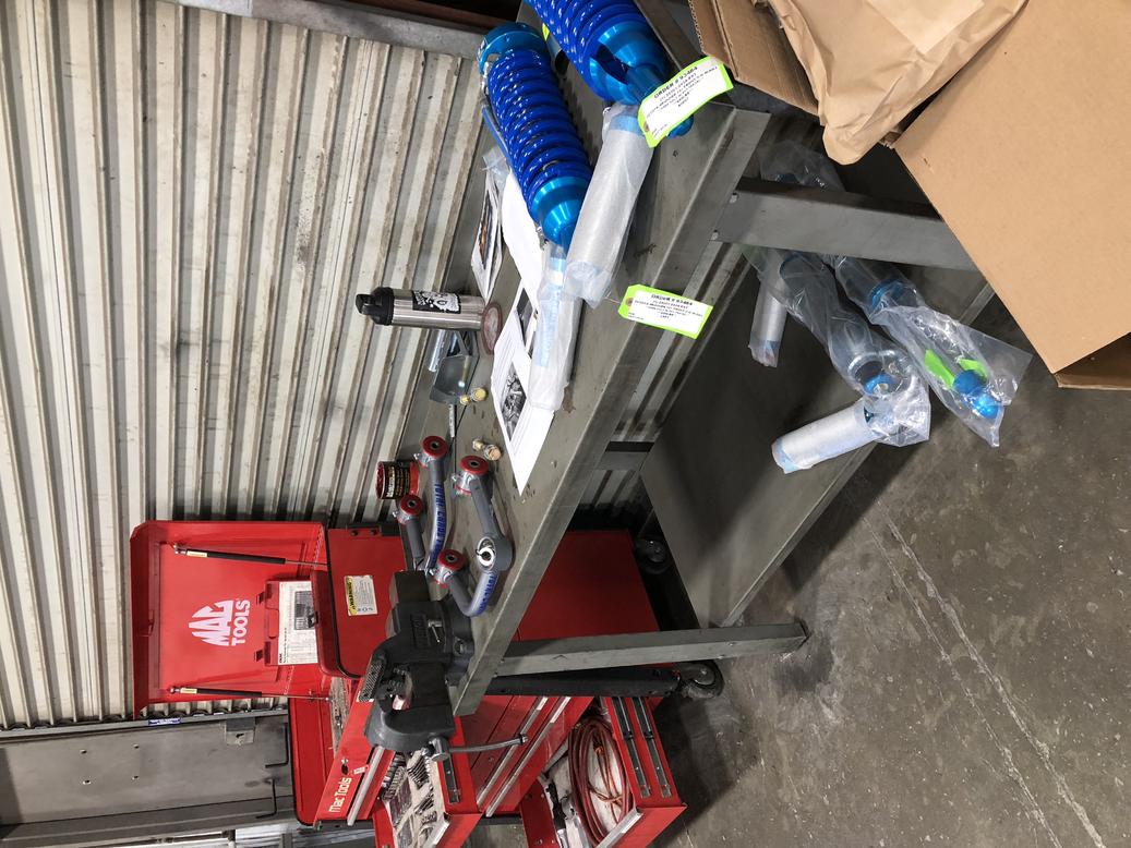

King shocks Suspension:LONG TRAVEL, 650LB

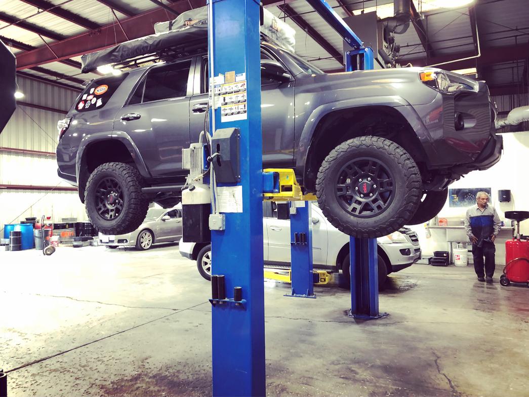

Took me about 6 hours to do. Lift help a lot, especially with the KDSS. KDSS is there to make it a lot harder to do the install. I am thinking to take the KDSS out at some point. The shocks came stock height and need to be adjust to 2.5" lift. I used spring compressor to make the adjustment. There is no way to adjust this shock when its installed because the reservoir hose is in the way when I tried to use the adjuster rod to make it turn. I had to make the height adjustment twice because I wasn't sure, but if I am to do it again I would put to max height 3" and let it settle. Another thing to consider is the additional weight from bumper and 2nd battery, they will weight down the spring.
The ride on this suspension is just perfect after some soft/hard adjustment. Off-road: soft, city street Soft/hard, highway hard. I feel the different in handling. The new shocks doesn't bounced everywhere like the stock.
Parts:
King Complete Kits (5GenK Stage 1A)
Toyota 4Runner w/KDSS Stage 1 Kit 2.5" Front Coil-Overs w/Res, w/Adjuster #25001-243A 2.5" Rear Shocks w/Res, w/Adjuster #25001-279A
Total Chaos Upper Control Arms (96504) 2005+ Toyota Tacoma / 03+ 4Runner / 07+ FJ Cruiser Bushing Inners
Rear spring: OME medium 3"

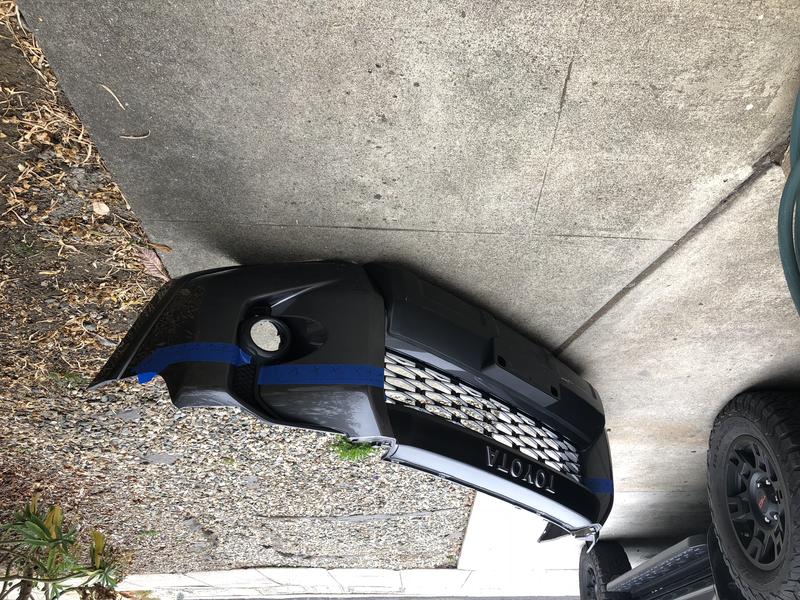

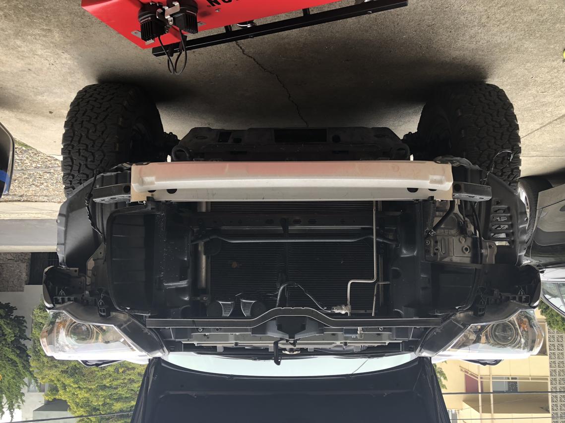

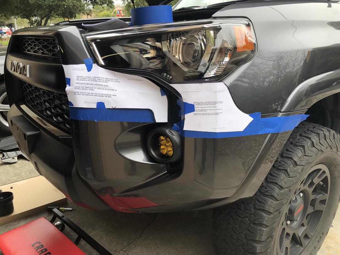

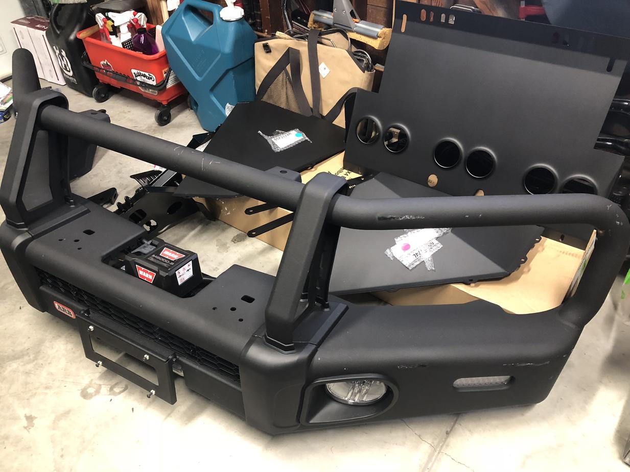

ARB Summit Bull Bar front bumper.
Got this bumper from 4wheels parts with no wait, next day pick up. It came in a little rough, some paint scrape but no dent, I am still waiting for the paint touch up for the integrit material to be available to fix it. Lot of nuts bolts and they all there in bags. Instruction is very detail. This bumper lower stone guard doesn't fit very well with stock skid plate, but fit with ARB. 2nd person is needed to help lift and align the bumper. WARN 8000lb WARN also went in. Did this mod in about 6 hours.

ARB Skidplate
This went in after the bumper. I’m glad I waited since this skidplate fit like a glove to ARB bumper. 2hrs install

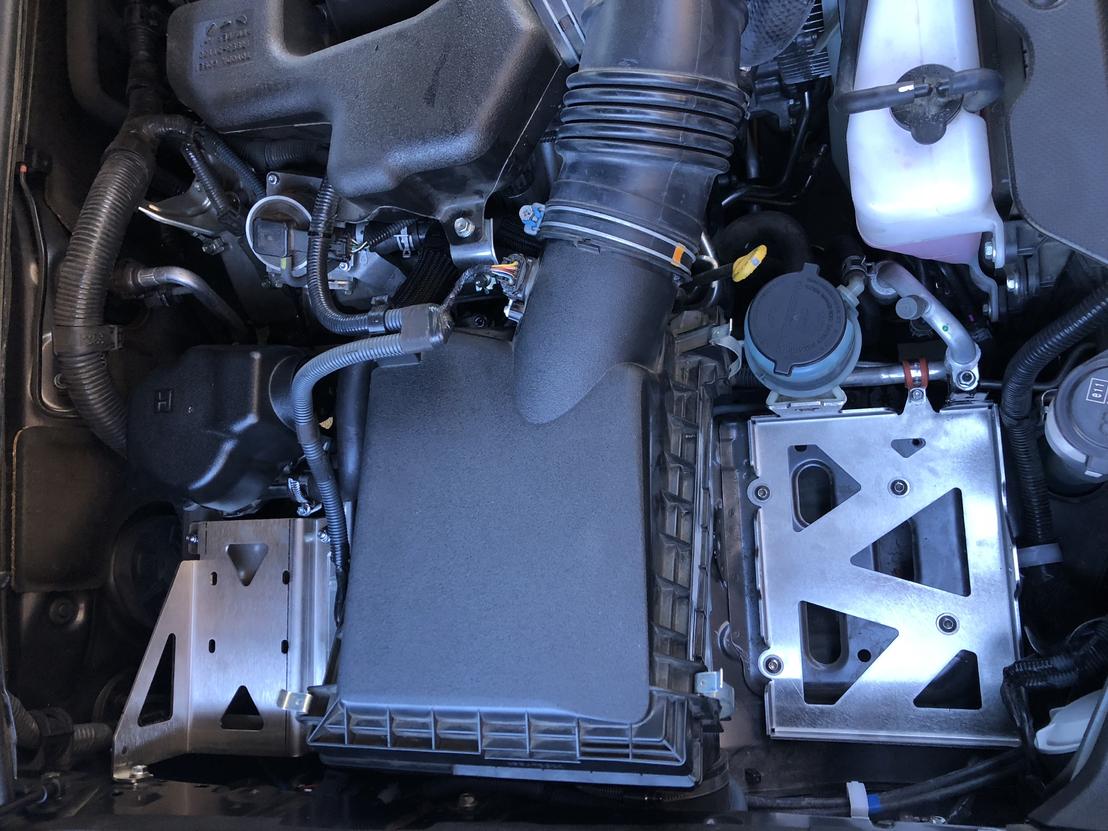

ARB safari snorkel
This mod is quite moderate easy, took me about 2 hours. It was the most satisfying moment cut into the 4Runner. I used lots of tape to mark the drilling and cutting.

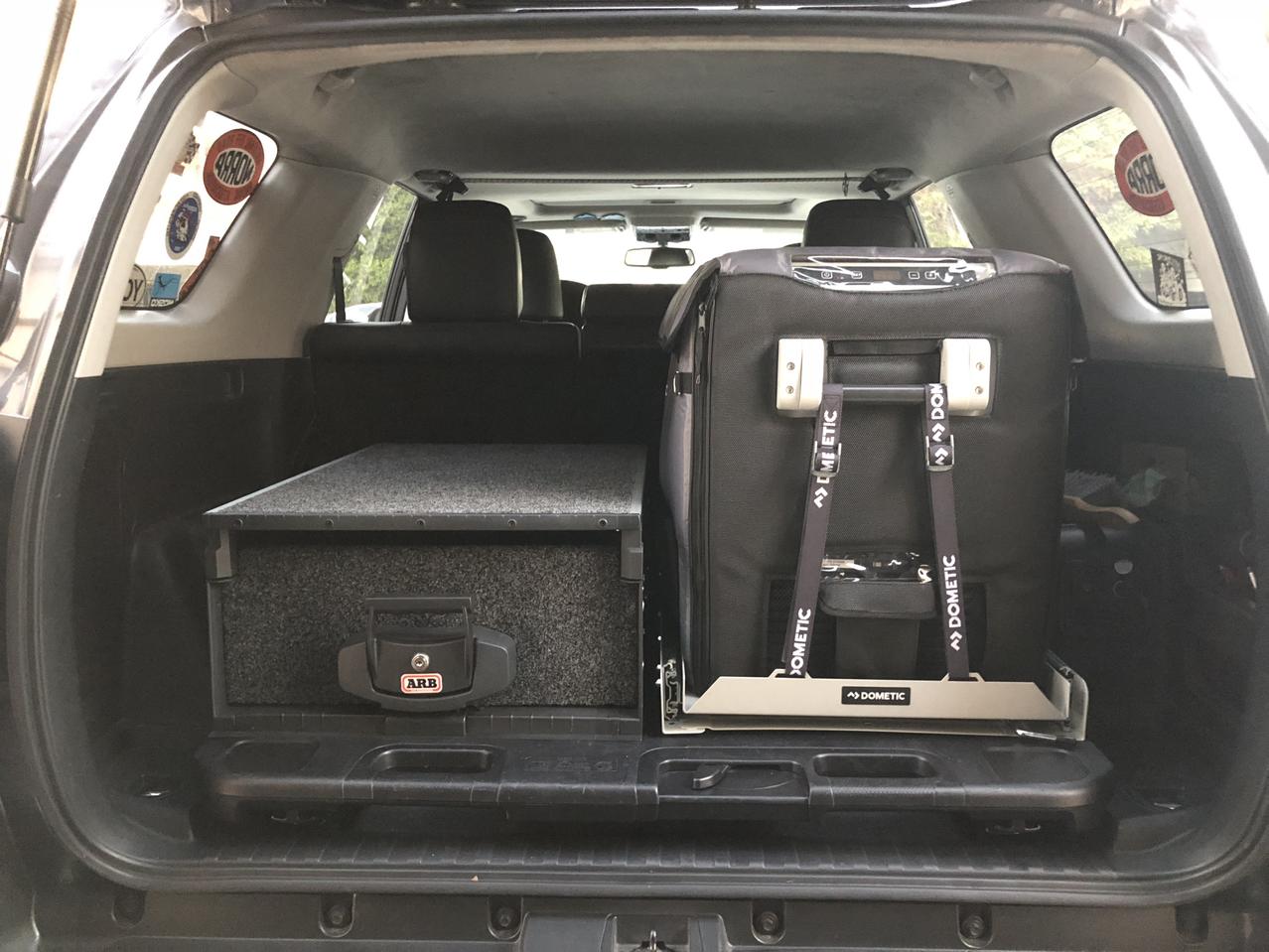

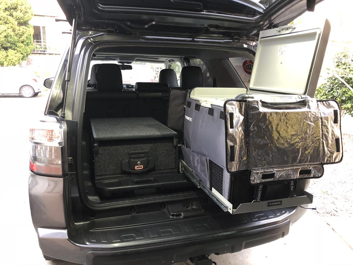

ARB Outback drawer & Dometic CFX65W
The ARB drawer and Dometic slider are secured onto the cargo slider using several big bolts and wide washers. Fridge slider and cargo tray slider pull put very far, it does bring out the fridge away from rear bumper line, very ease of using the fridge.

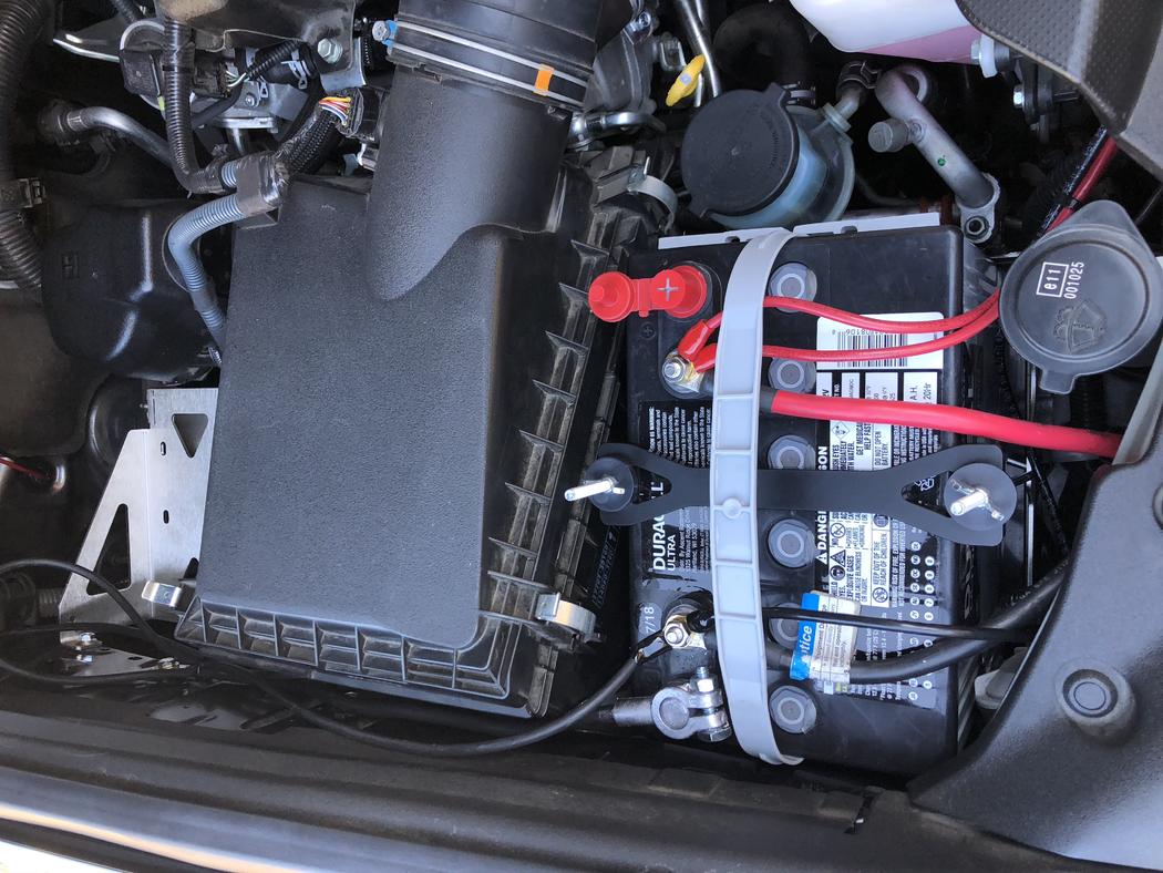

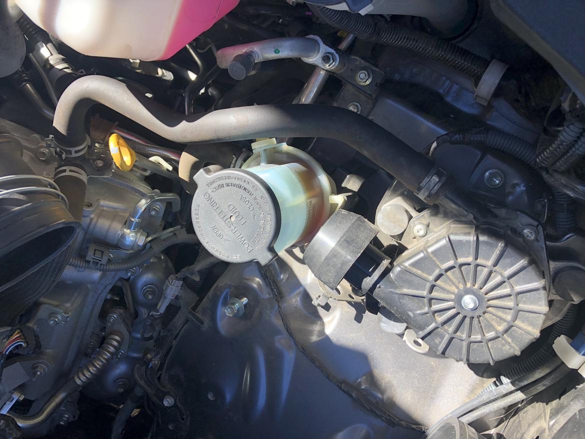

Relocate the washer fluid reservoir and pump to make room for 2nd battery.
Took me a while just looking at all the parts to do this mod. I tried to piece them together in my head before I pull apart what's already in the engine compartment. When I strarted, it went very quickly. Using a kit from Shockwork. The kit came with all the wiring and hose connectors with a very good instruction, big color A4 print.

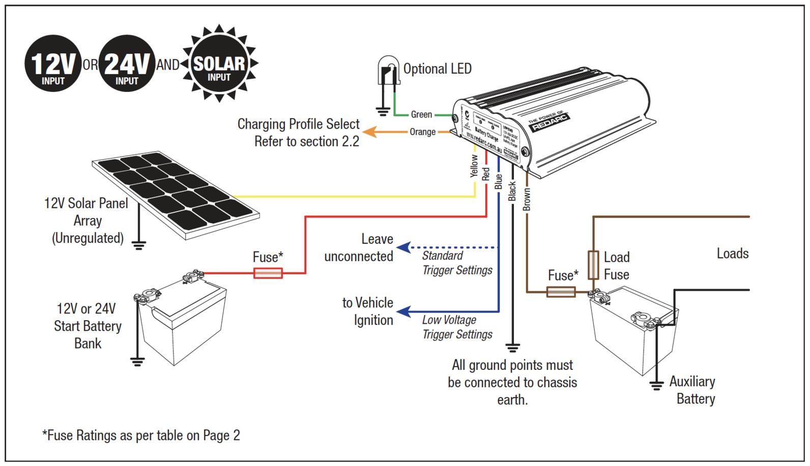

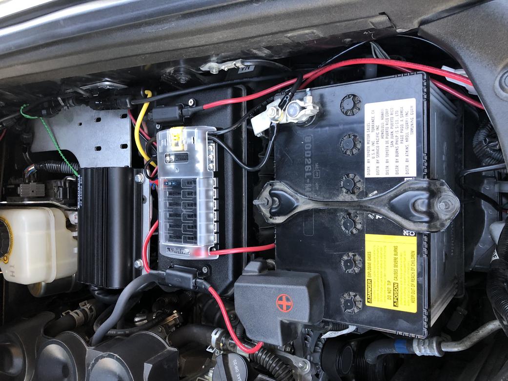

After I got all the surface area in the engine compartment prep and 2nd battery went in, I start to wire up the electrical.
REDARC controller is the center of this Solar panel & 2nd battery kit design. This charger will stage between Solar or car alternator to charge the 2nd battery. NO need to have 2 identical battery. I also picked the REDARC because all the wiring into the charger required only smaller wiring. I didn't want to run big size 1/0 wiring everywhere like other build I've seen. Smaller wiring is also cheap.
The BlueSea fuse tray panel is there for future expanding. I also found that running wiring between engine compartment and passenger cabin is a little hard, there aren't many location to pull the wire, and its super tight. SPOD or ARB LINX is something I am considering.
The two size 10 wires pulled along the door silt and to the back of the car. I got these cheap Amazon outlet set for cigarette charger, USBs, Voltmeter and local switch. I installed them in the little tray area.
