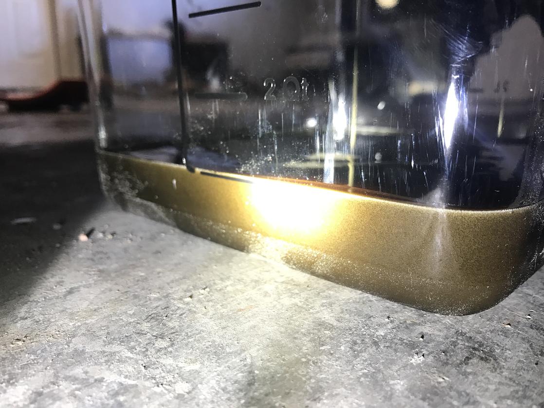

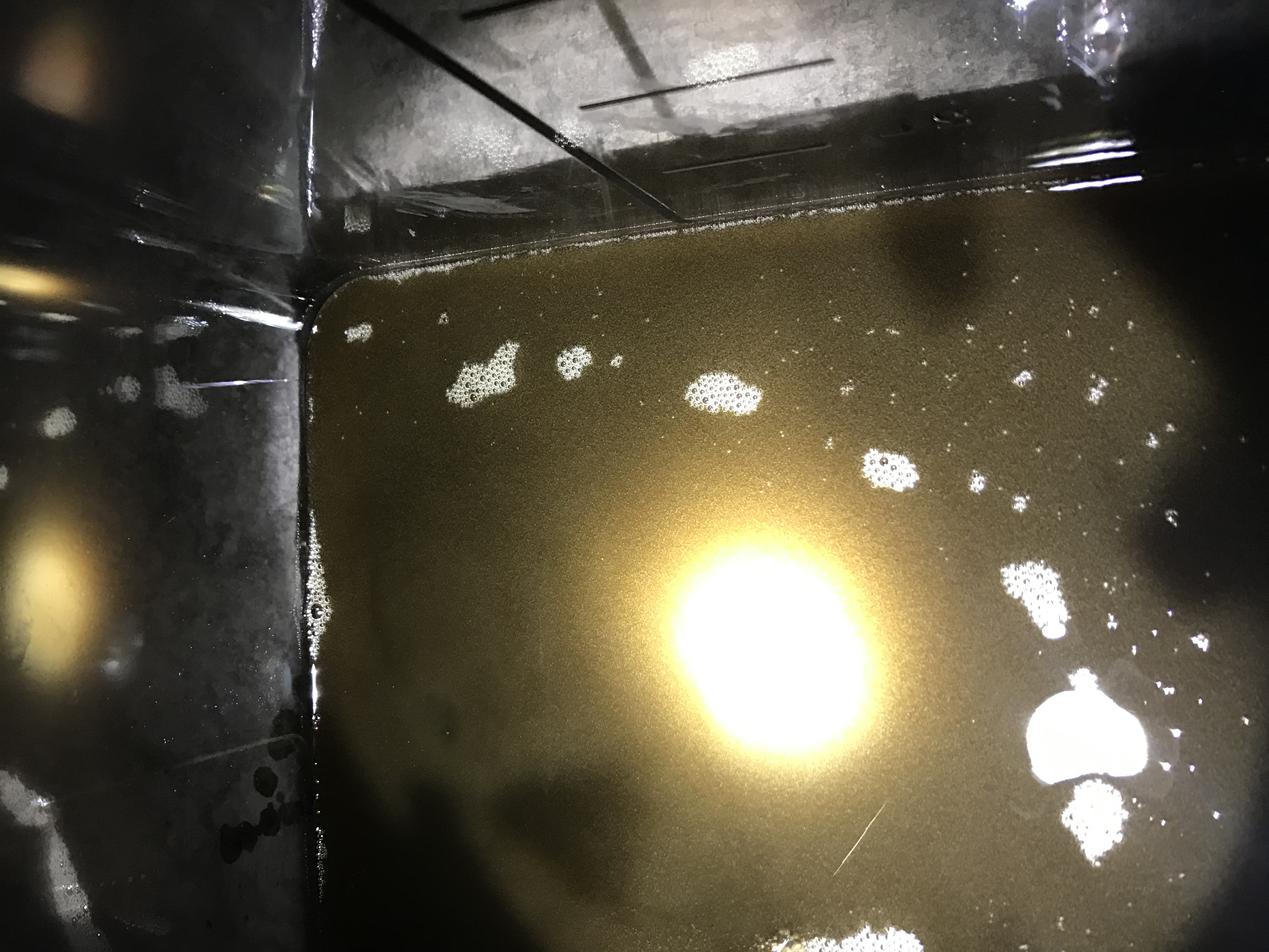

Here is what the fluid looked like.

Can't tell if that's air bubbles or water in the transfer case? It looks like water to me.
But yeah your transfer case is messed up. Should not be grinding like that.
