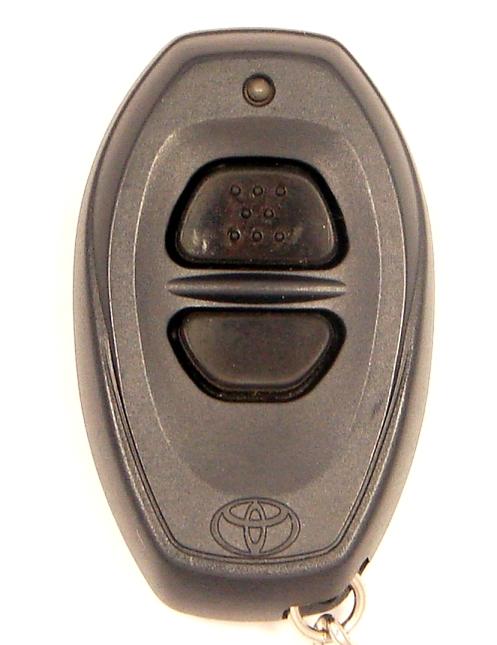

No, some 3rd gens had a different fob. My 98 had a grey two button fob and some had a black two button fob. I think the years with those were 96-98 and then in 99 the three button with the window switch was introduced
Here's a pic of the older style that also was black for certain years:

I'm not sure if this process works for those older key fobs. You can always try. If it doesn't work then no harm.
This process will not work with the older models. The older models were, at least my 98 was, much simpler. All you had to do was press a green button on the alarm control unit under the drivers seat for 3 seconds I believe, and then press the button on your remote. There was a different process to wipe paired key fobs.
If anyone needs more detailed info and steps for the older models I'm sure I could dig up however I did my old one. There may also be a thread on here for it.
