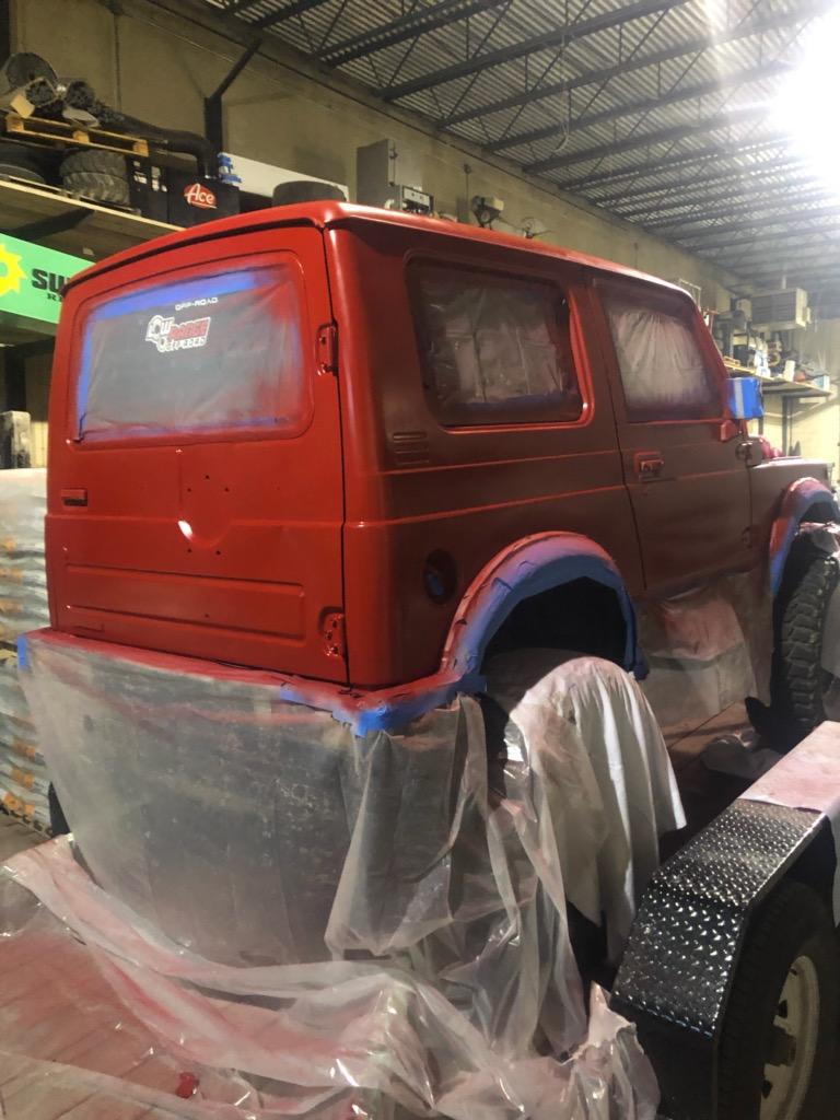

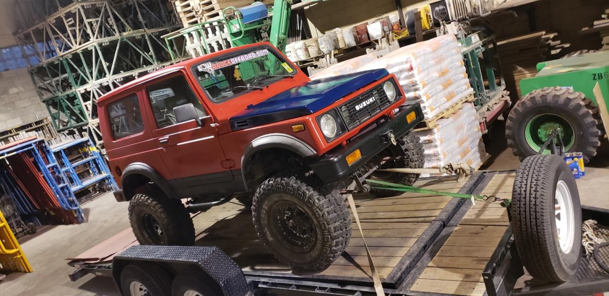

Wrap would be the worst investment. If the paint is already shot put that 7k you have for a wrap towards someone who paints a lot and you will be happy. I had a single coat put on my samurai two weeks ago and it looks good. Mine was under 900
