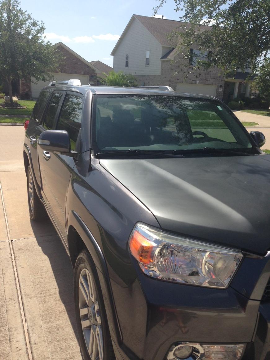

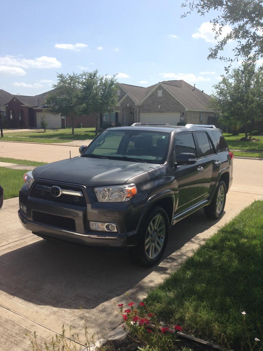

i did this to the hood last weekend and couldnt be happier. a word to the wise - get a total of three people to do this. two to stretch it each way out from the center and the third (you) to start with the squeegee (sp?). i had a buddy of mine help and he charged me a lot more beer than originally expected - that being said, he also has huge lats now so i guess he came out even...:whoo:
