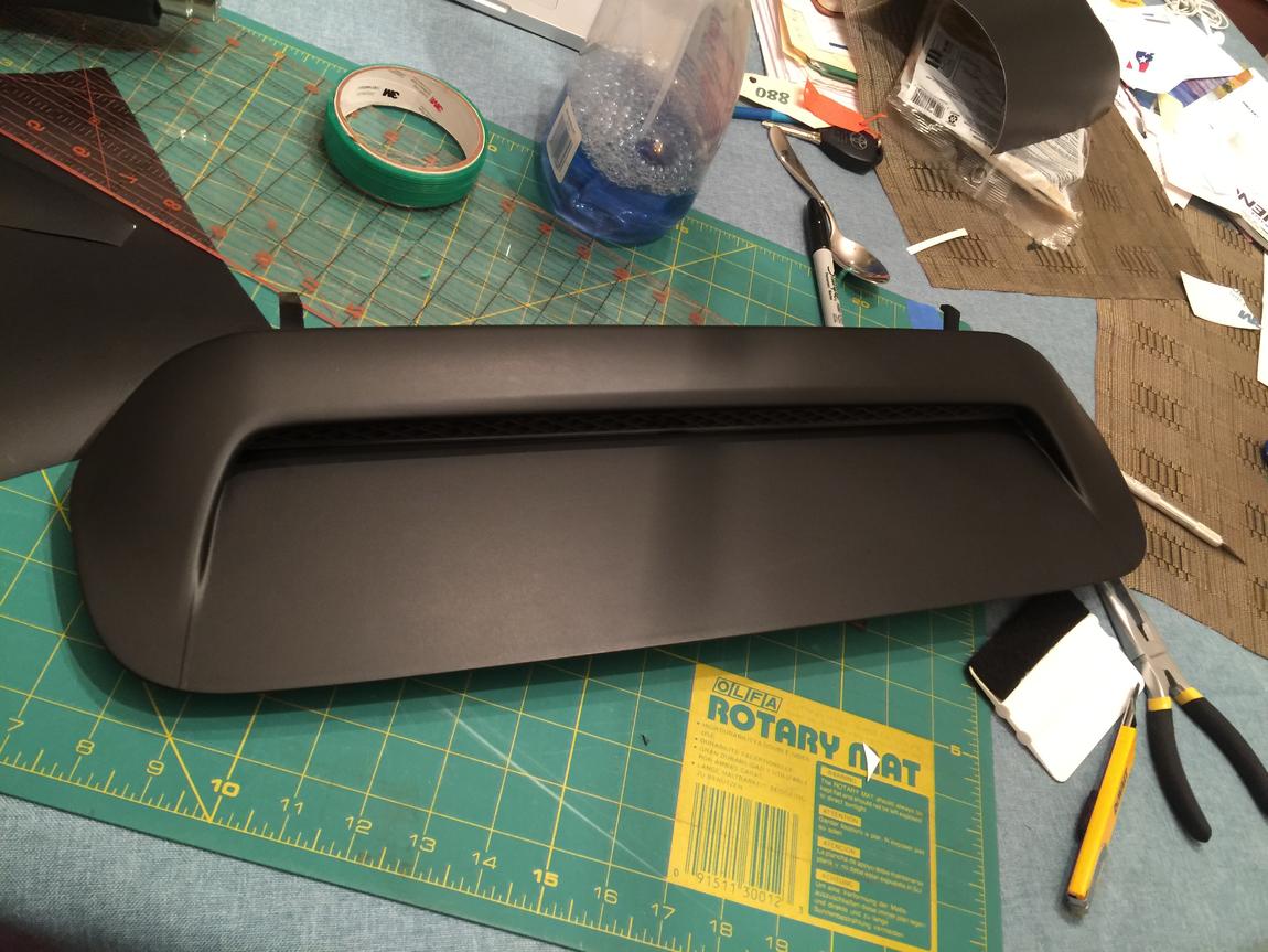

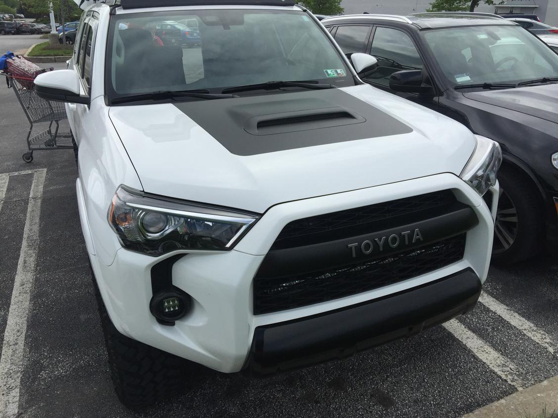

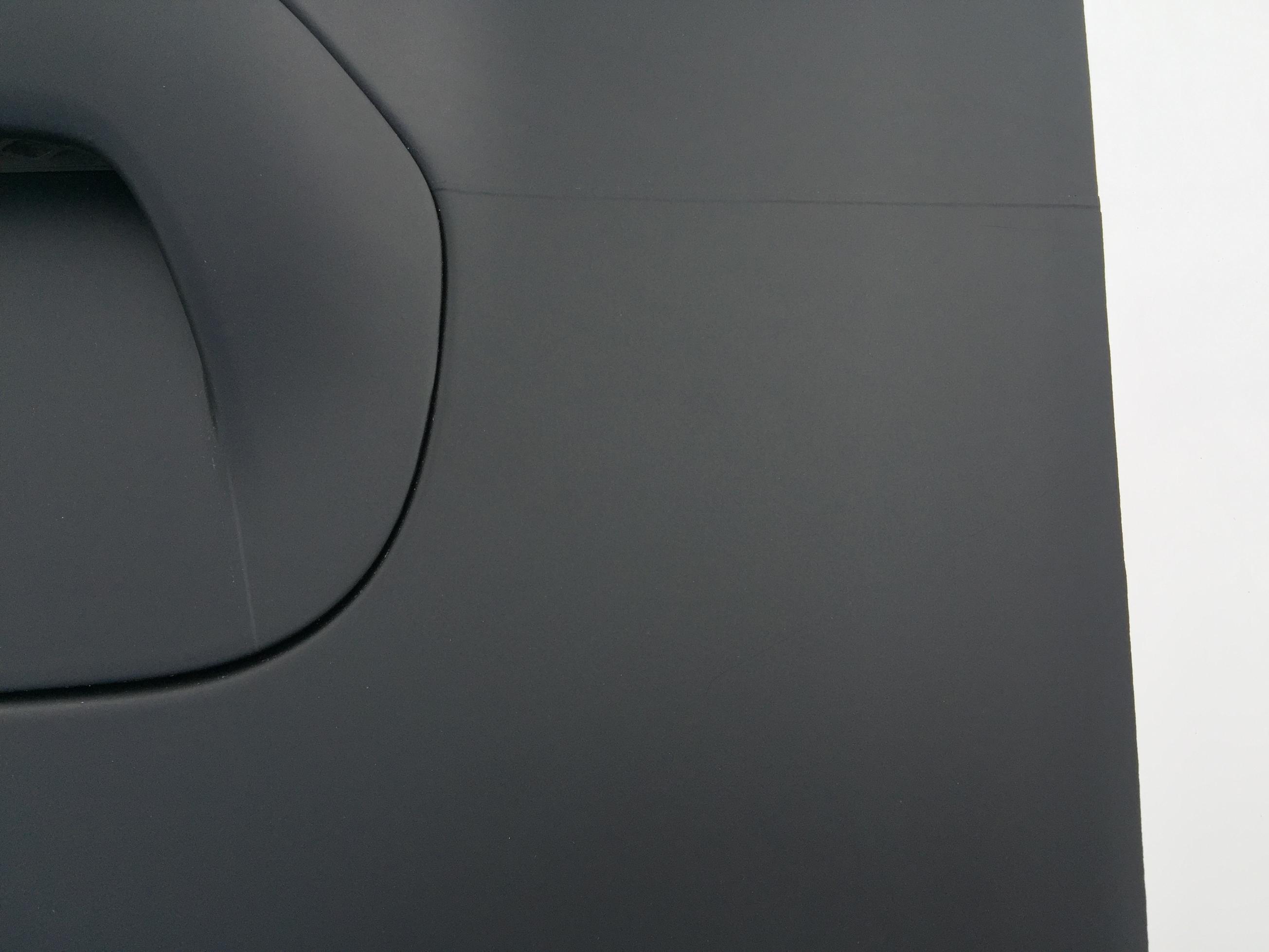

Hey how did you manage to get the wrap done in one piece? After several attempts I ended up having to seam it which I'm not thrilled about. I only did the center portion but every damn time I would end up with slack without any way to flatten it or push it out. This is my final result. I wouldn't mind re-doing it again to get it done in one solid piece but I don't want to waste my time until I figure out what I need to be doing differently. The contours of the hood scoop were causing massive annoyances. I also wrapped it with the scoop insert taken out first which I think is the way to go. Any help would be appreciated !
