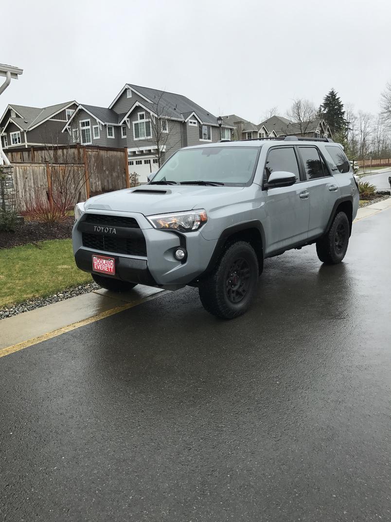

Wrapping was an option that I was planning on doing. Vinyl cost was a little too pricey for how much material I just needed for the fenders. I opted to plastidip which was a few dollars for two cans. Covered what I needed as well.
The only tricky part of plastidipping was the front bumper fender arch and the rear bumper fender arches. They aren't removable so there isn't a gap for easy plastidip removal. You'll need to take your time with it to make it look decent. Here is a my dipped fenders! I think it turned out okay!

Looks good! That's an option i may consider if i cant find a wrap shop or paint shop that will do it relatively cheaply.
got a pic of the front fender?
Those wheels look sweet! Love the color

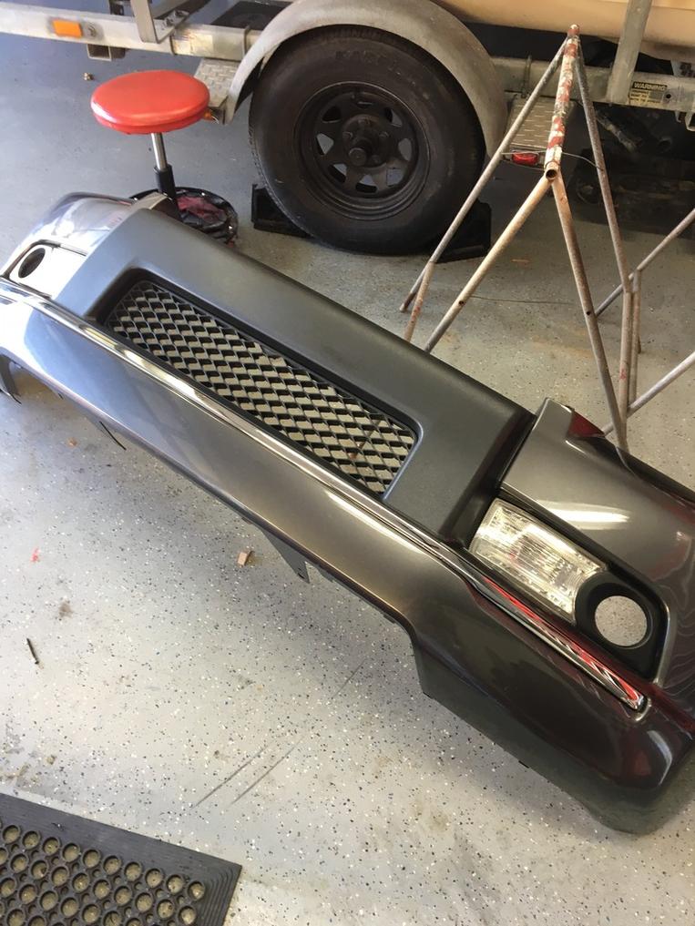

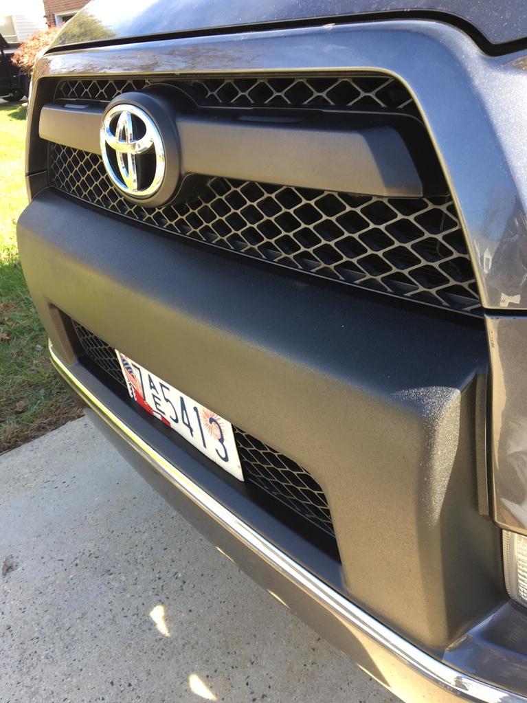

If you want them to stay that way (Plastidip will be an ongoing maintenance project, but can be removed completely) here is another option...
Rustoleum spray on Bedliner- I sprayed my center front bumper with it. If you lightly sand and scuff the paint on the fender flares this bedliner holds up really really well on the plastic. I was behind a salt truck a few days ago and got slammed with salt ROCKS- chipped my windshield and my hood before I could get around the bastard. My front bumper came through perfect with regards to the bedliner. The factory painted sections took a beating, lol.
It'll be easier to remove the flares, but if you tape properly you can do it on the truck, and you can remove the tape easily and cleanly after the paint dries- unlike plastidip. Total cost probably $30.
Here's what my bumper looks like painted with the Rustoleum:
