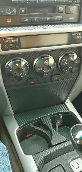

Use Vinyl. Use a good quality (3M DiNoc). Don't forget the prep work (I did :pout: ). Clean the surface well with rubbing alcohol. Heat is your friend. Go slow, take your time.
This mine.
Good job on keeping the weave direction throughout each part. I’ve seen shitty installs without this in mind and the pattern is all over the place.
This mine.
Vinyl 100%. At our shop we tried the hydro dip. Depending on the pattern and the shape of what was being dipped, we often got mixed results. Since then we only vinyl and the best thing is that there are 100s if not 1000s of patterns out there that didn't exist just a few years ago.
Thanks. That's something that has bugged me too. I made a point of trying to line up the pattern. Seemed to create a bit more waste but, worth it.
This mine.
That looks awesome! I’m definitely going to do something similar to mine because the panels aren’t as perfect as I’d like since I’m not the original owner. I want to repaint the silver parts too because of scratches on the sides of the console.
