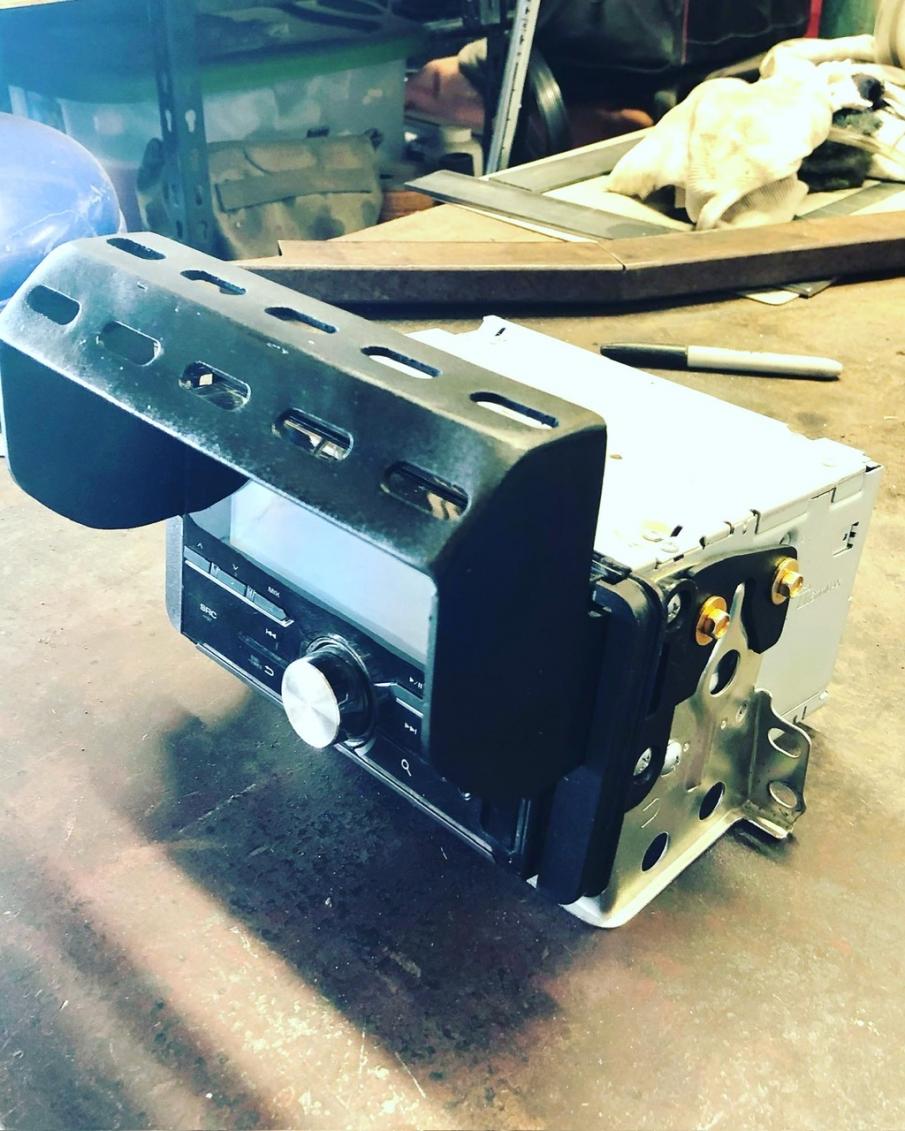

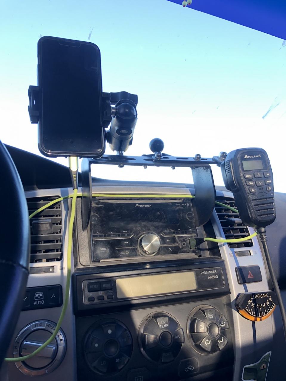

So this is a little different but may offer some help as mine is an 07 SR5. I made my own console mount that attaches to the sides of the head unit itself. I used filler pieces from Metra and was able to trim those so I didn’t have to modify or drill into my bezel at all. I designed mine as a sort of copy to the F3 Fab mount. IIRC Metra makes fillers for both style bezels. Idk if DIY is an option for you to fabricate one yourself or no. TEQ makes one that screws in to the front of the bezel too.
