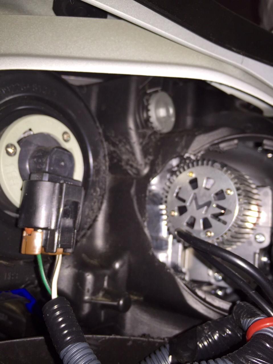

I have been reading many posts on this and everytime i read more i get more confused. I have a 2015 limmited, I have already replaced my headlights with the VLEDs LMZ 6K. To me it looks fantastic. The OEM was really bad. I did have to remove the "dirt cap" and used a dremel to shave off some platic due to the huge cooling fan these bulbs have. Having said that, these are the questions I need help with.

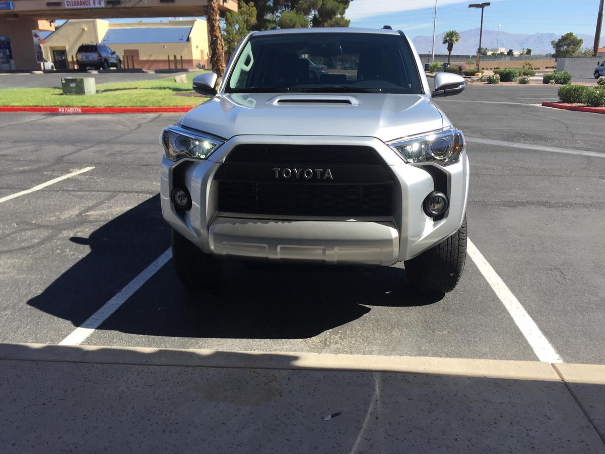

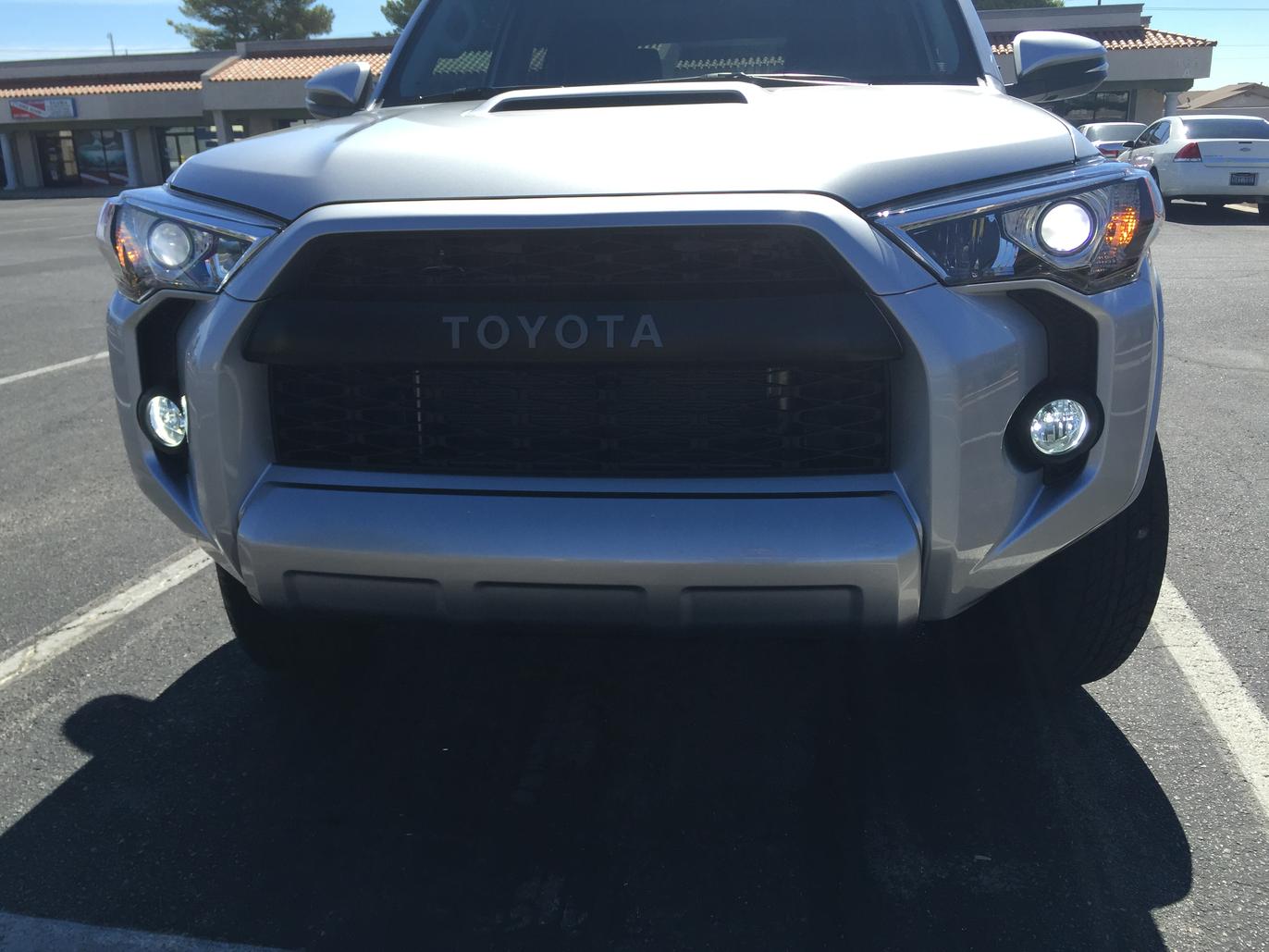

I used these on my 15 Gen 5
I used the LED bulbs for my fog and high beams/DRL and they are fantastic. No modifications straight swap of the bulbs no fans to worry about failing and room to install. I live in Las Vegas and it has been 103-107 for a week and I drive with the DRL on all the time no problems.
H16 LED Fog light Kit | H16 LED Headlight Bulbs
these LED bulbs are 6k color and put out really good light. I would still recommend HID for the main headlight since HID still put out 1.5k more lumen then the LED but LED put out about 1k Lumens more than halogens. BTW if you install HID in the main head light I had no issues of the light cut off being to high if anything I would like to adjust the headlight to be 5mm higher but do not know how to adjust headlight height. If anyone knows please let me know.
LED does flicker in DRL but you cannot notice it looking head on it is from the peripheral vision they flicker. I think that is a bonus feature and my BMW motorcycle has this feature on the tail light it flickers from peripheral vision but not head on so you get noticed. The LED lights from Xenondepot are plenty bright when activated for Brights I drive in the desert at night and it is pitch black out there with the brights on, fog lights on and headlights there is plenty of light for at least a half mile down the road way better than the stock lights ever were. My 14 GX 460 had LED lights and they were plenty bright for high and low beams.
As far as the dust cap issue when I installed my HID kit for the low beams I used a 1 inch hole saw from home depot and made a hole in the cover the kit came with a rubber gasket to fit the hole and now it is sealed tight.

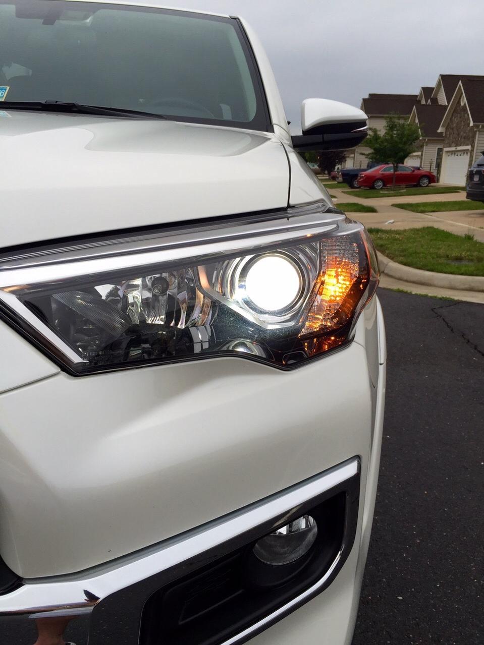

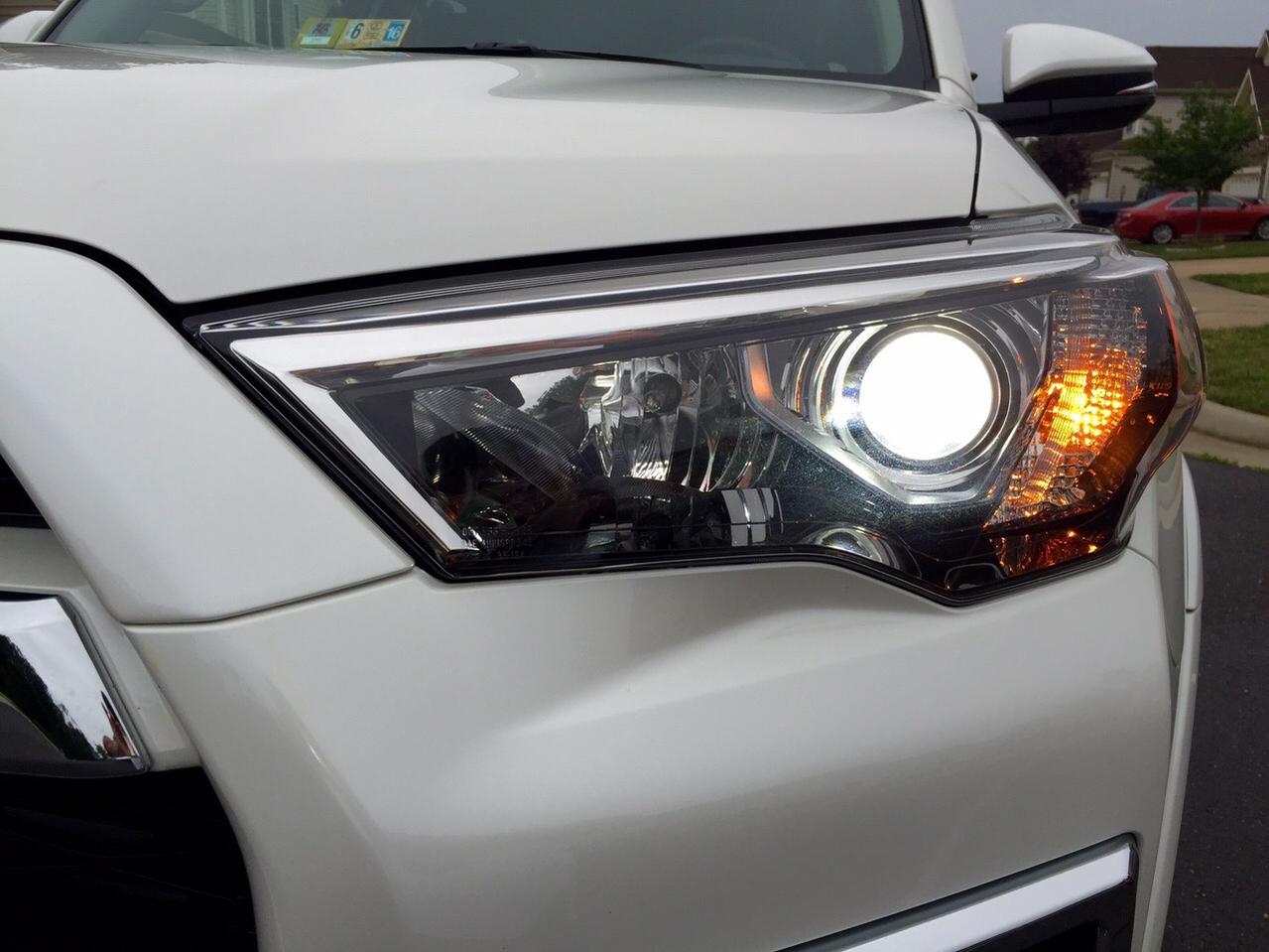

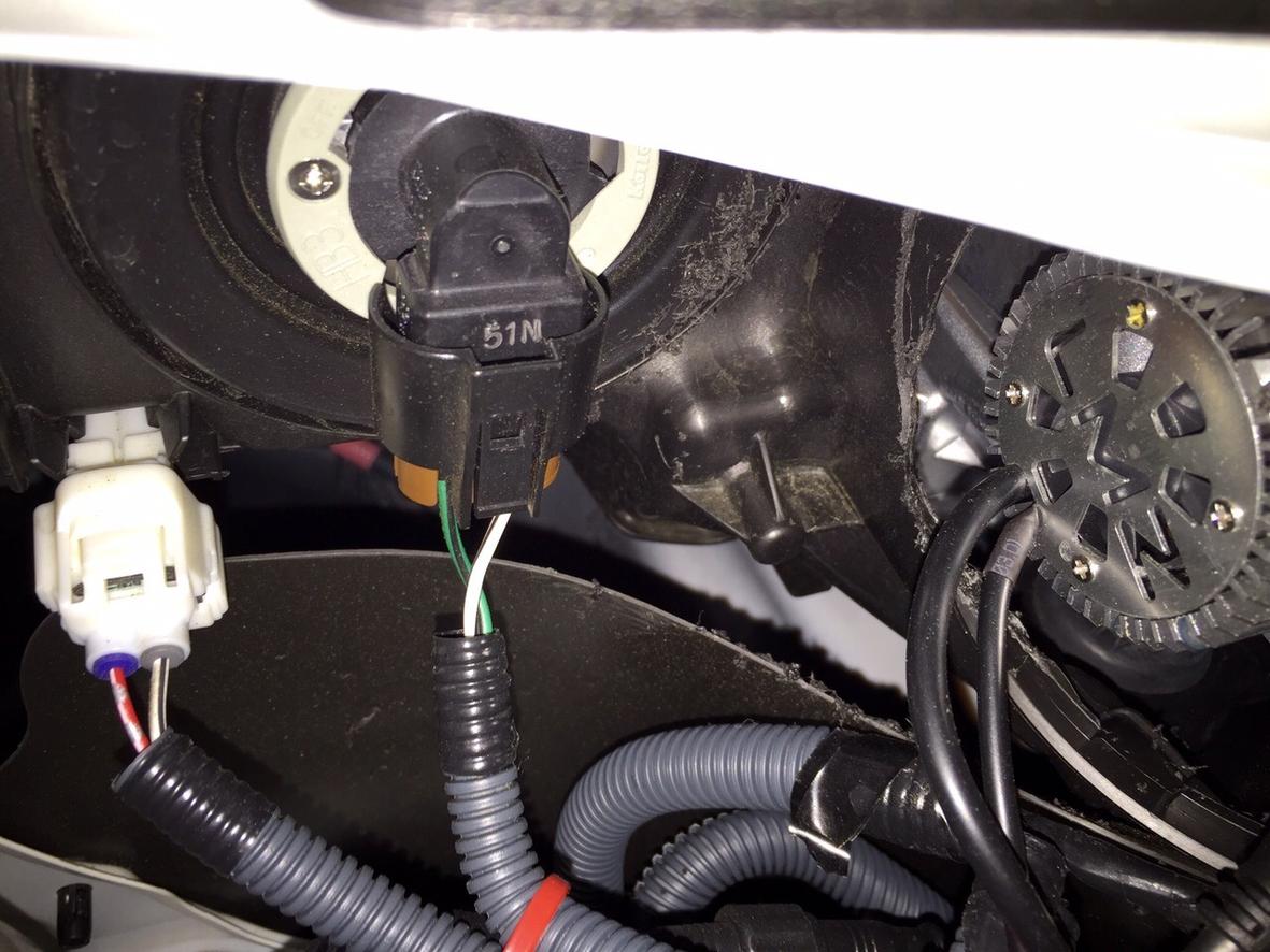

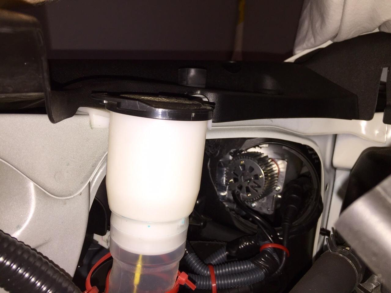

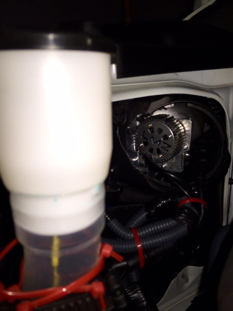

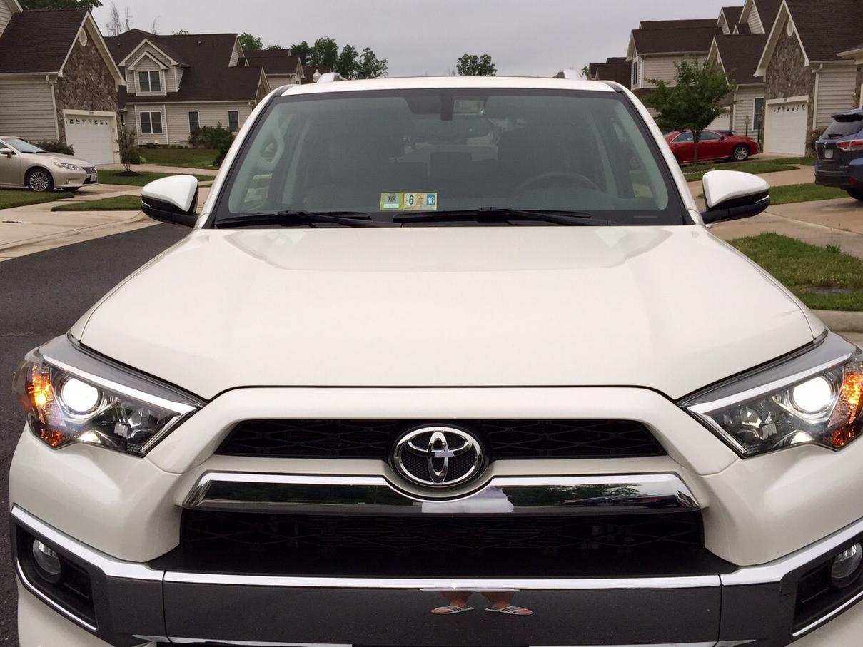

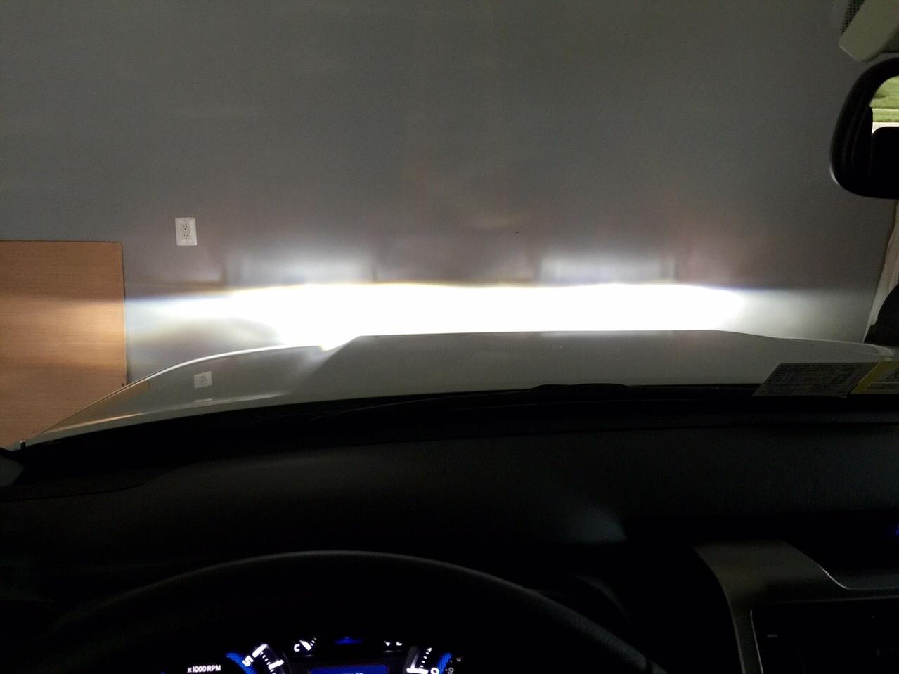

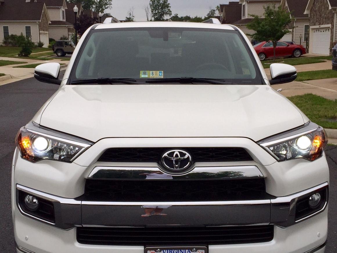

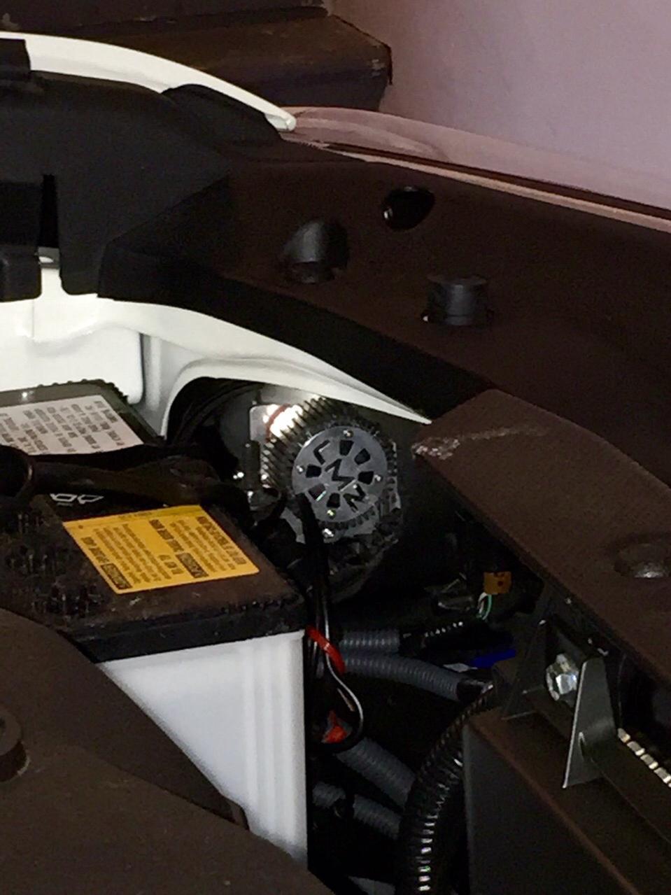

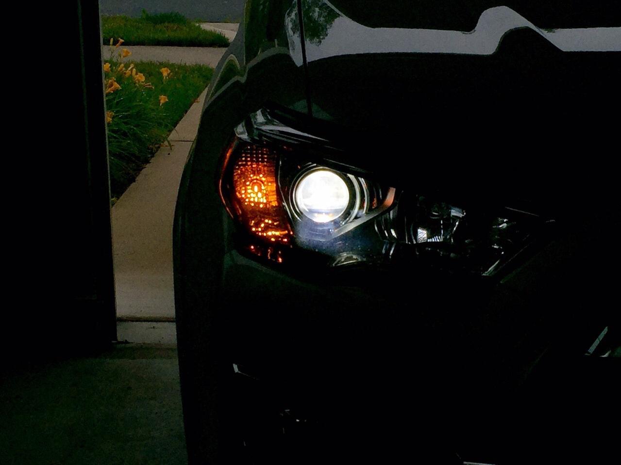

Your car looks very very nice man, thanks for the info. I did see some install videos on the HID kit. I did see how the drilling works. In my case with the VLEDs it was impossible. I will post pics of the back of the lights too so you can see. Congrats on the car again!
Again, Im not an expert. To me they look and work well but would like your thoughts.

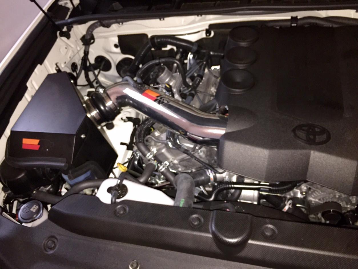

Added some pics of the CAI i put on too.
