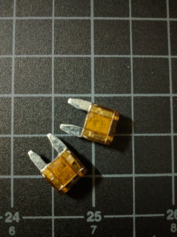

My HKB fuse arrived today (ordered 4/19, delivered 5/12). My issue was my second battery (AGM) was not charging very well while traveling. I heard about these boosters and thought I'd give it a shot. I'm running the NL smart dual battery controller, OEM starting battery, and Optima blue top 2nd.
https://www.hkbelect.com
Install was supper easy, if you can replace a fuse and run a multi-meter you should be good to go.

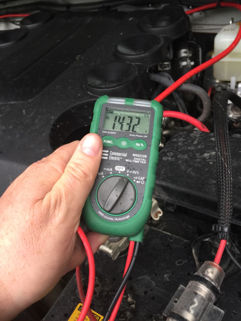

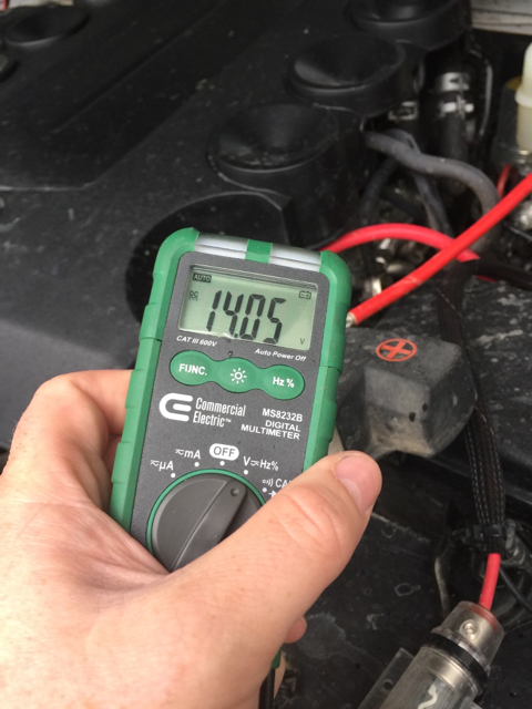

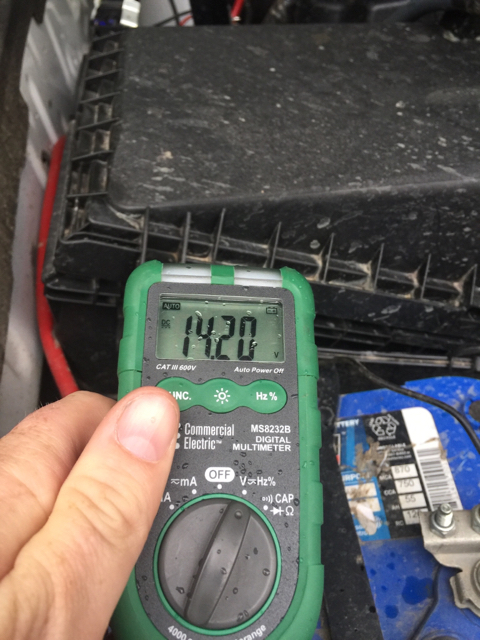

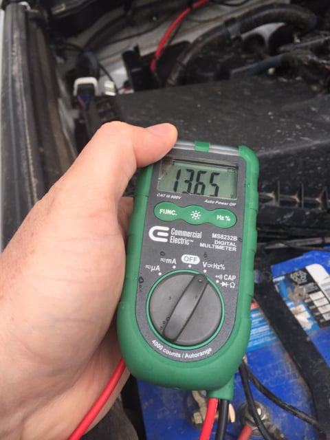

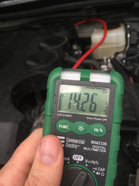

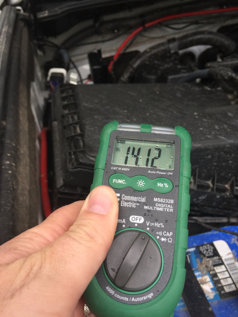

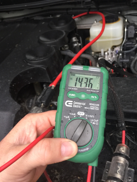

Below a pictures of my meter before installation and after:
OEM Battery just after starting no voltage booster
Optima after NL system connects (5min after start)
OEM just after starting HKB voltage booster installed.
OEM at idle 5min after start with HKB fuse installed.
OEM at 1500 RPM with HKB fuse
Optima at 1500 RPM with HKB fuse
I'll see how this performs this week and report back

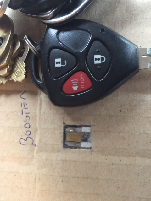

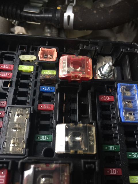

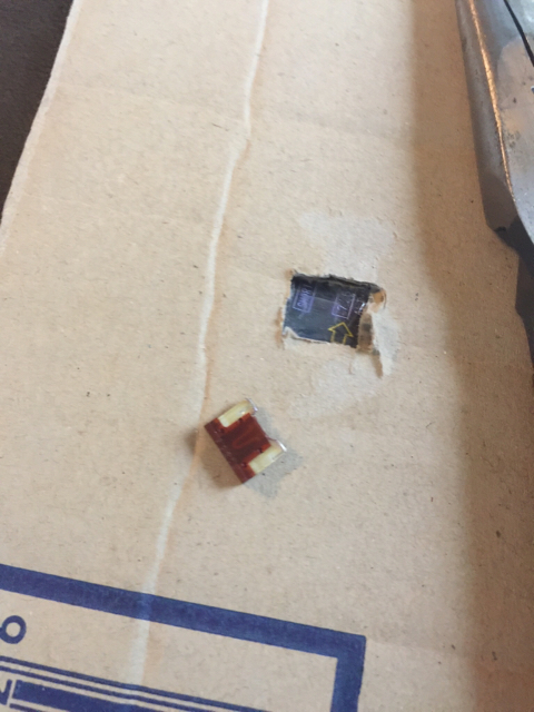

Here are some pictures of the install
Fuse itself
Fuse installed
OEM
