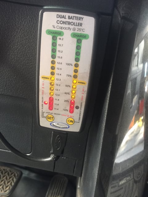

They do, but DC-DC converts Amps into Volts and from what i have read, from those across the pacific, is that the DC-DC chargers are fire hazards and do more damage... not to say putting a resistor in my fuse box is not a fire hazard but i couldn't find any documented issues with the fuse solution.
Update: it appears like the fuse allows for just enough amps to charge my AGM battery.
Sunday morning my AGM battery showed 11.6v this morning it shows 12.2v. Yesterday I drove approximately 2hrs of mostly highway, parked and let my fridge run all night. Prior to installing the fuse my AGM battery would be critical unless I plugged into shore power. Initially this fuse appears to charge the AMG at a rate to overcome overnight discharge.
One thing to note, my primary (oem) battery typically shows higher volts than what it is showing this morning. It will be interesting to see if this trend continues.

This fuse definitely works for my application. I never plugged into shore power for the last 7 days and my fridge battery has stayed charged and operational. I drove 2 hrs Monday, 2 hrs Tuesday, 1hr Wednesday, and 1.5 hrs yesterday (Thursday). I'm very happy with these results. Additionally the last 3 days have been very hot and my truck has been parked outside in the sun with my fridge set at 37*.
Below is a picture from this morning.

If you have isolated batteries, why is your starting battery not fully charged?
Sent from my SM-G930V using Tapatalk
Its a little low because last night I spent about 2 hrs cleaning the truck with the dome lights on, normally it's 12.4 - 12.5.

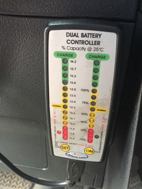

got my voltage booster in.
Running a 31agm, and was definitely not getting charged properly before.
Think i'm getting closer to whats needed to properly charge the agm now.
