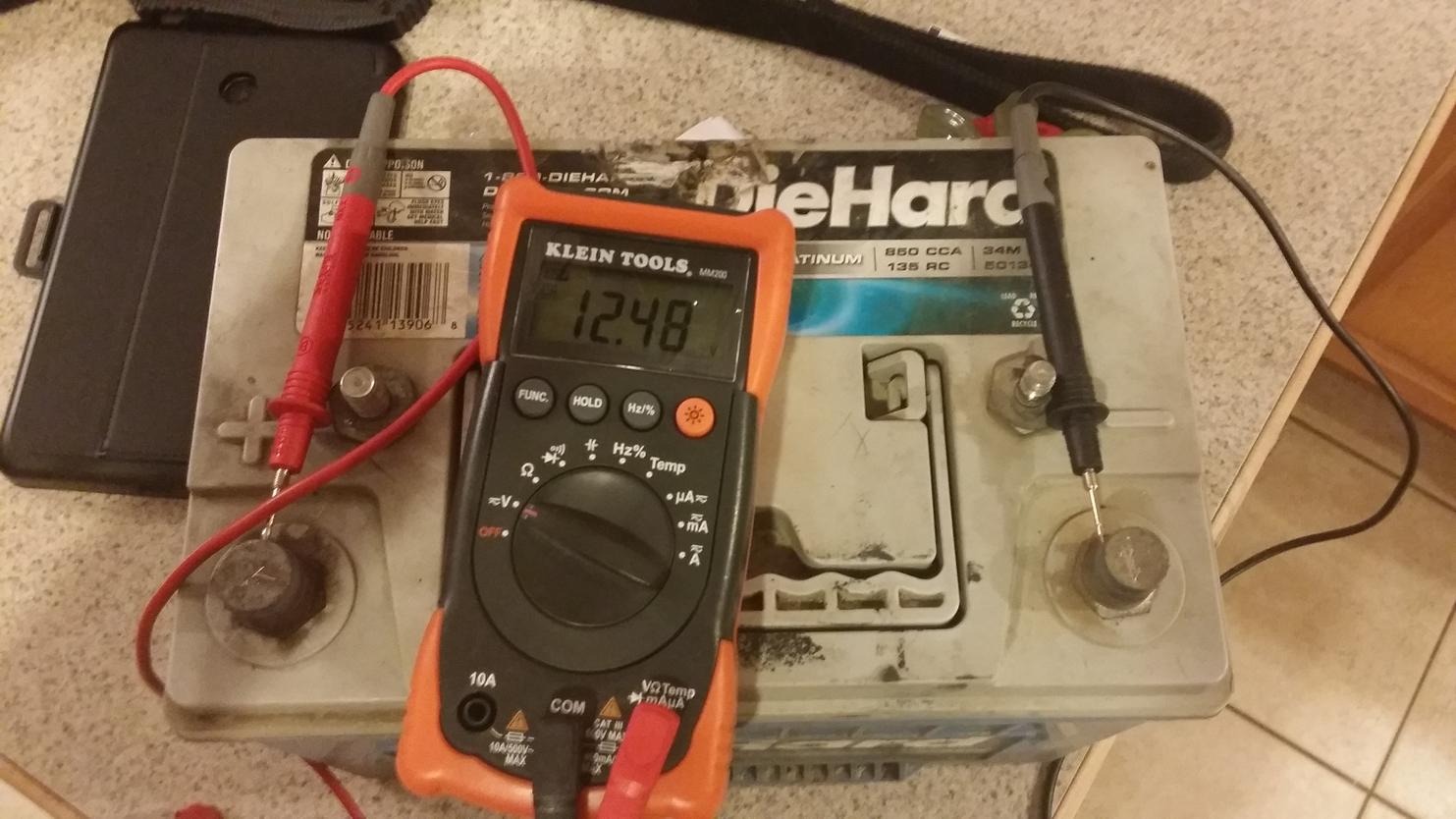

12.5 V voltage while sitting on your counter is pretty good. I don't quite understand how the mystery was solved.
