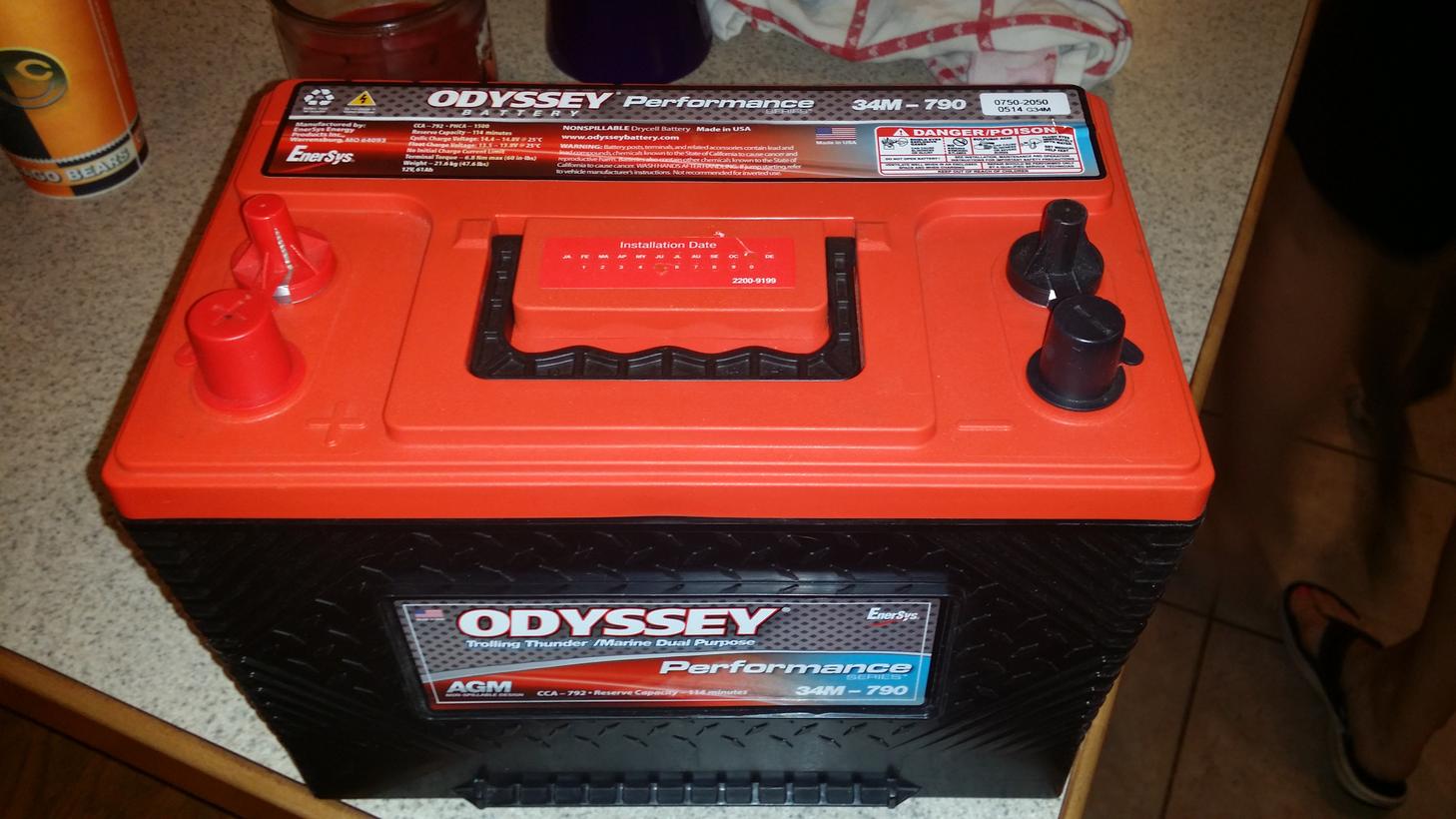

Going to try this until I can the other oe alt built up.

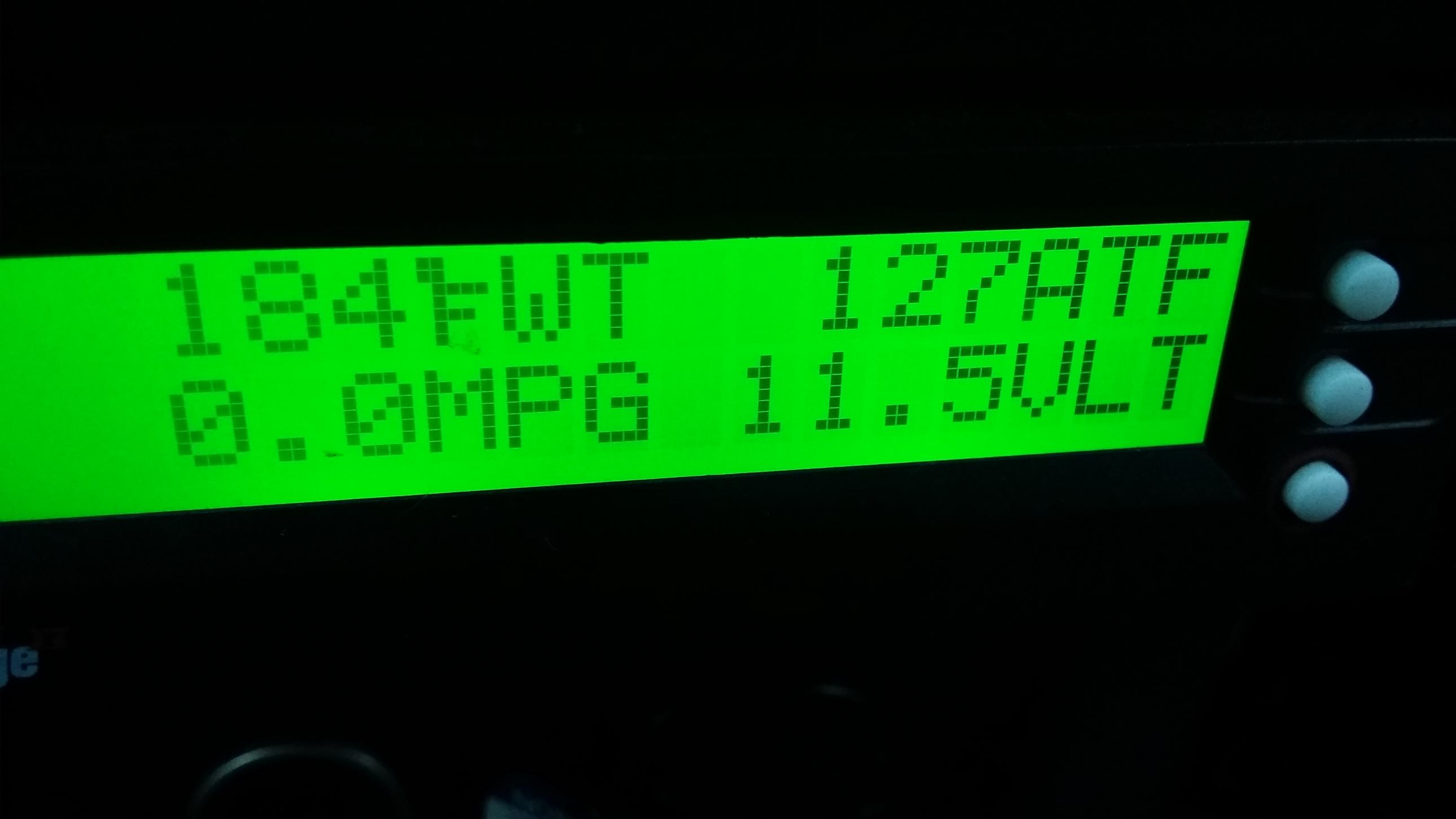

And after install.... same issue. Battery is going south. It was dropping out pretty quick. It leveled off for a min but then as more stuff was turned on it fell off.

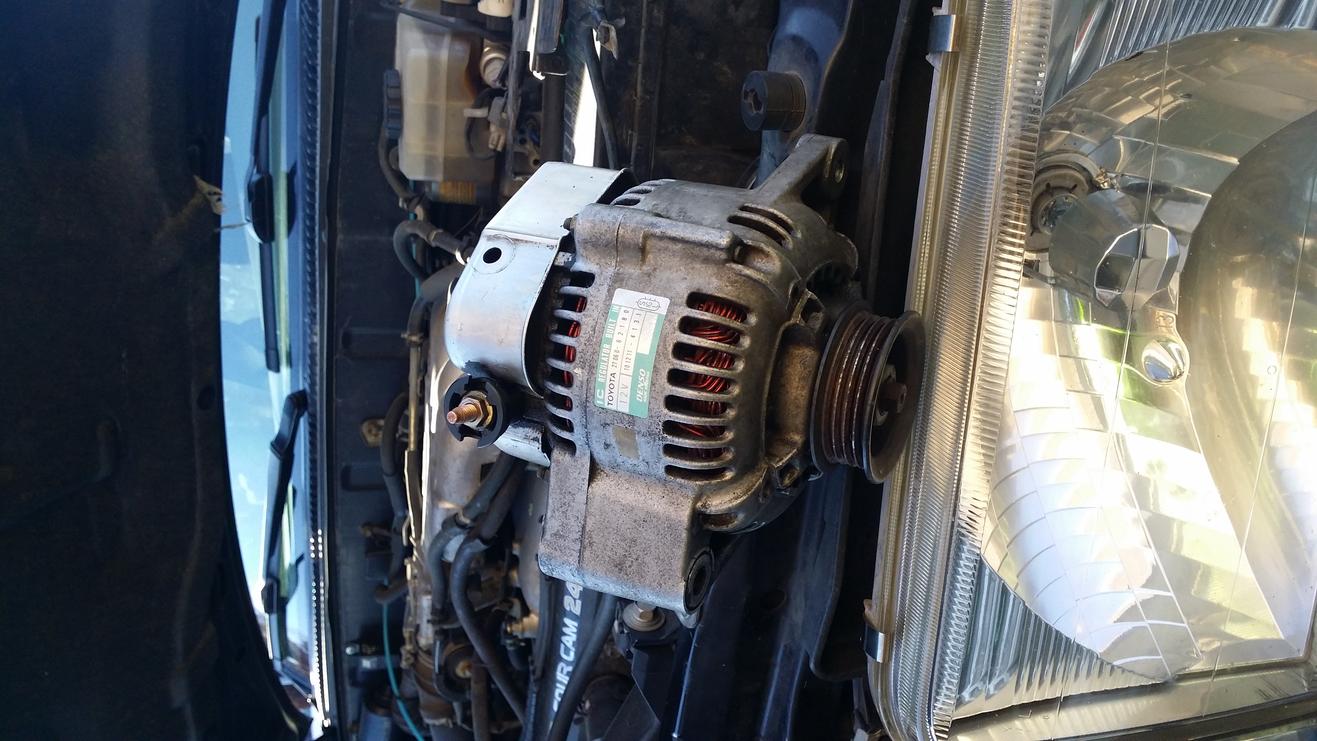

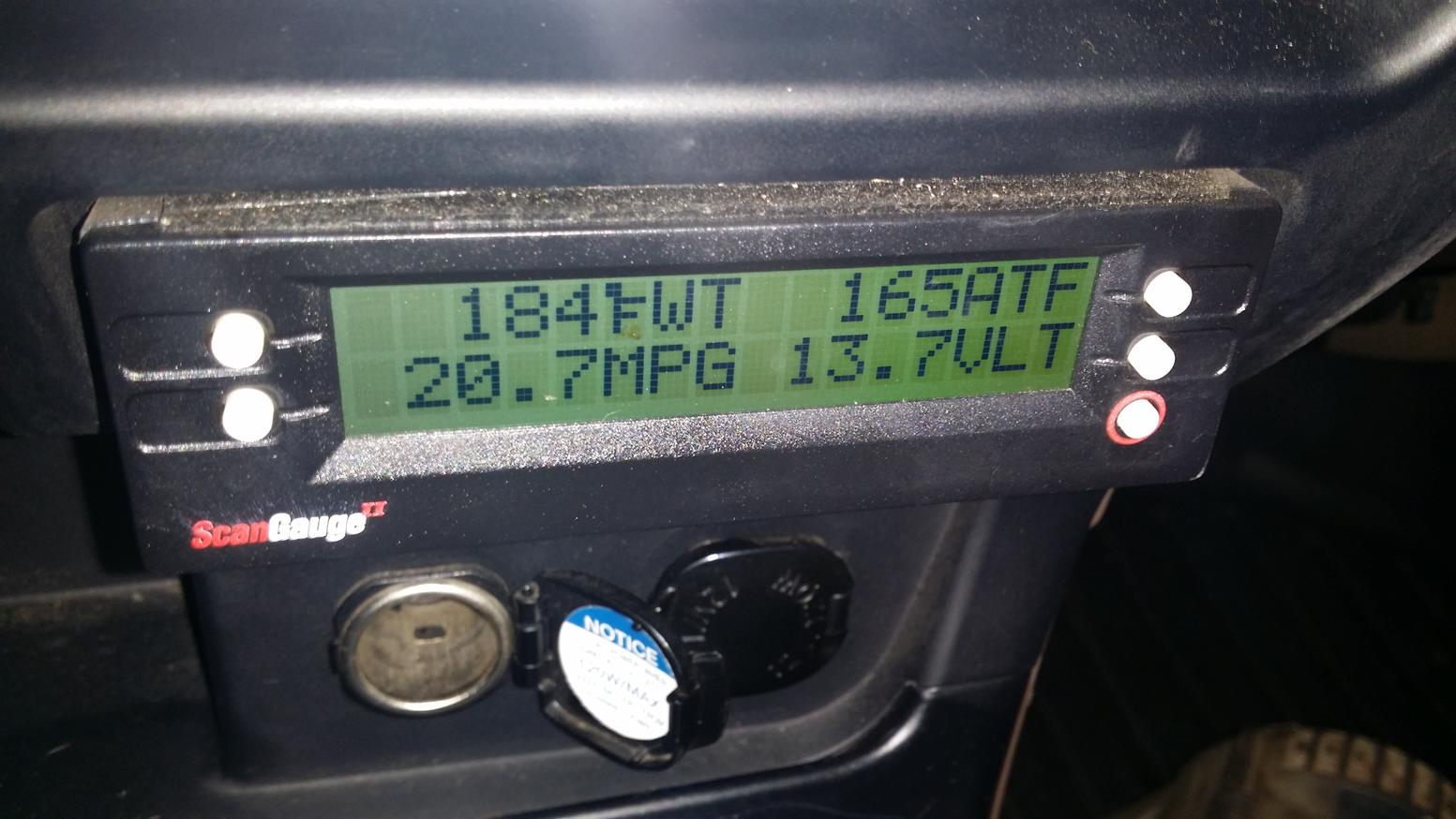

Well. The moral of the story do not use cheap parts.After wasting 8 hours at least multiple trips to parts houses all for junk alternators. I finally got a Denso! After putting it in immediately everything is as it should have been. battery is testing fine so I guess I'll have to return that nice Odyssey battery I just bought boo or maybe I could just keep it and run dual batteries this time hahaha I hope somebody can learn something from my misery. Sorry about the stupid auto type and its lack of grammer.....

Your battery got the terminals in wrong side

Have you noticed the battery posts are in the wrong side?
Glad you solved the mystery. I have a spare denso alternator just in case. Never auto part store items.
