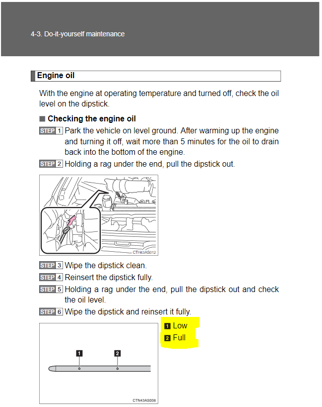

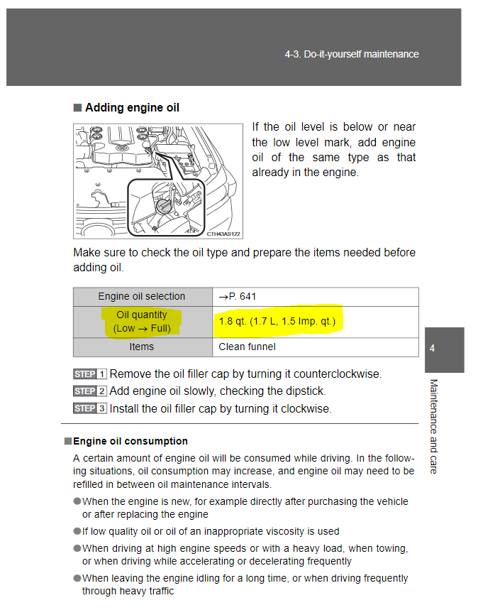

Has anyone confirmed the amount of oil to go from the low to full marks on a 5th gen dipstick I always thought this was a standard 1L delta. In arguing with a tech the other day he said it was .5L between the two, and I dont buy that.
Check your manual. :) ;): My 2013 says:
