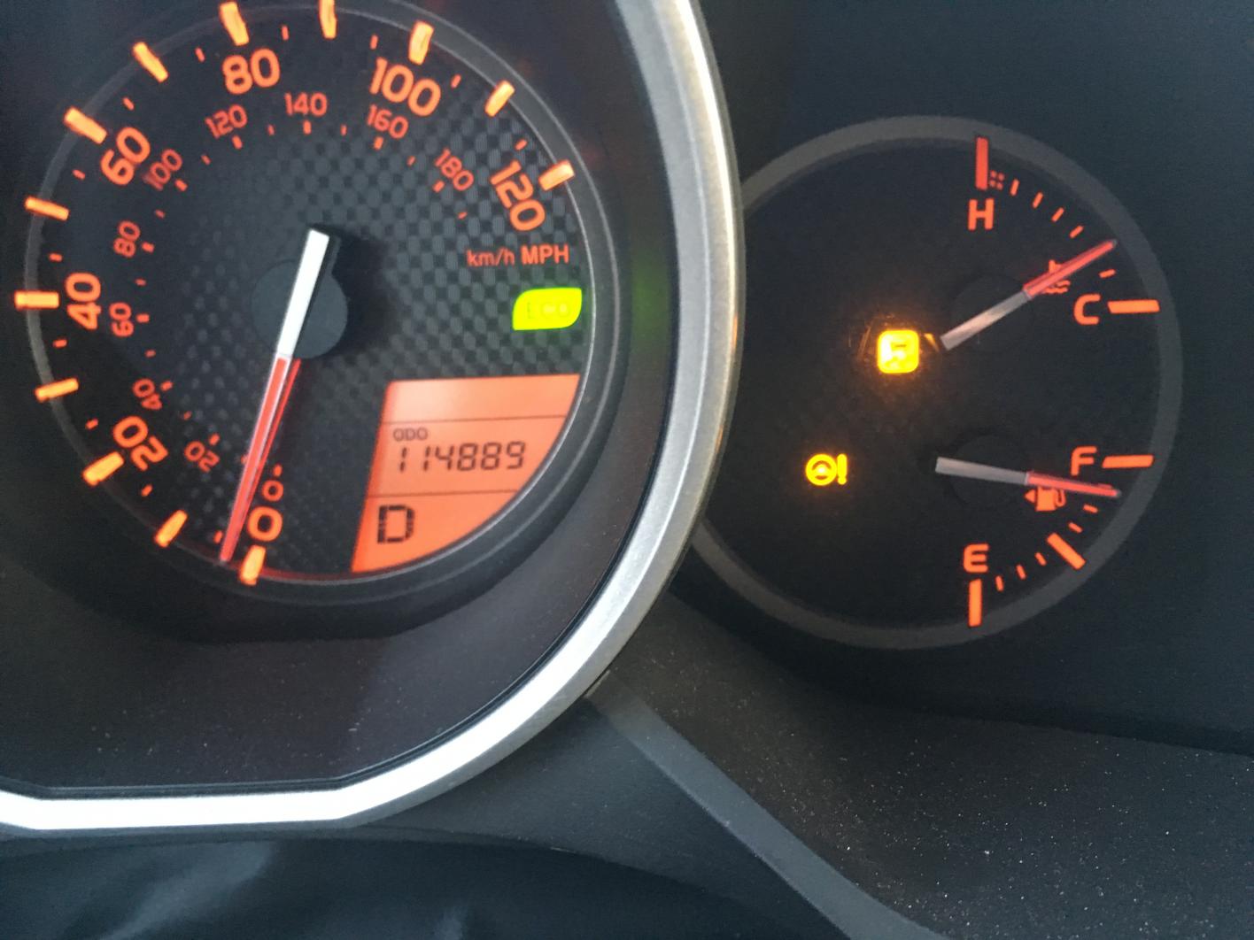

After I reinstalled everything, I noticed that the VSC "Skid/Swerve" light and steering wheel light with an exclamation mark were on. I tried to reset the code using the Zero Calibration method by jumping the OBD connectors to no avail.
From there, I disassembled the the steering wheel once again and boom, there it was, a small wire harness on the bottom of the CS assembly that i failed to reconnect. I reassembled everything and the lights disappeared!
Until a mile down the road. They both came back on, steadily lit. I drove the truck 30 miles with no issues.
I read on these forums that the lights are not easily cleared and usually have to be done at the dealer.
To avoid that trip, what should I do?

You must clear the old data prior to performing the calibration.
The procedure document is attached. Read through the steps several times and plan ahead; note that the final step requires driving straight at 25mph for 10 seconds.

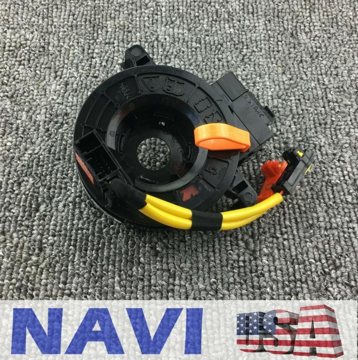

First, thank you for taking the time to help. The spiral cable came with a tab that needed to be broken off before the install of the steering wheel. I imagine that was what kept it in place. Otherwise, no, I did not wind it up. Here is what it looks like. notice the orange tab.

2011 I had the exact same issue- I even didn’t install the SAS cable the first time. Did all the steps mentioned here, starting with the $20 ebay spiral cable. This part does not come with the steering angle sensor and that must be reused from the old one. It has a label on it that says do not remove. I finally ordered an OE Toyota part that came with the SAS. Installed it and the steering wheel light turned off- then I was able to reset the two other lights with a Snap On scanner. I assume any scanner would work. Anyway the $20 clock spring did control the radio but there is definitely an issue with the SAS. Order an OE unit and move on. This was a fiasco.
